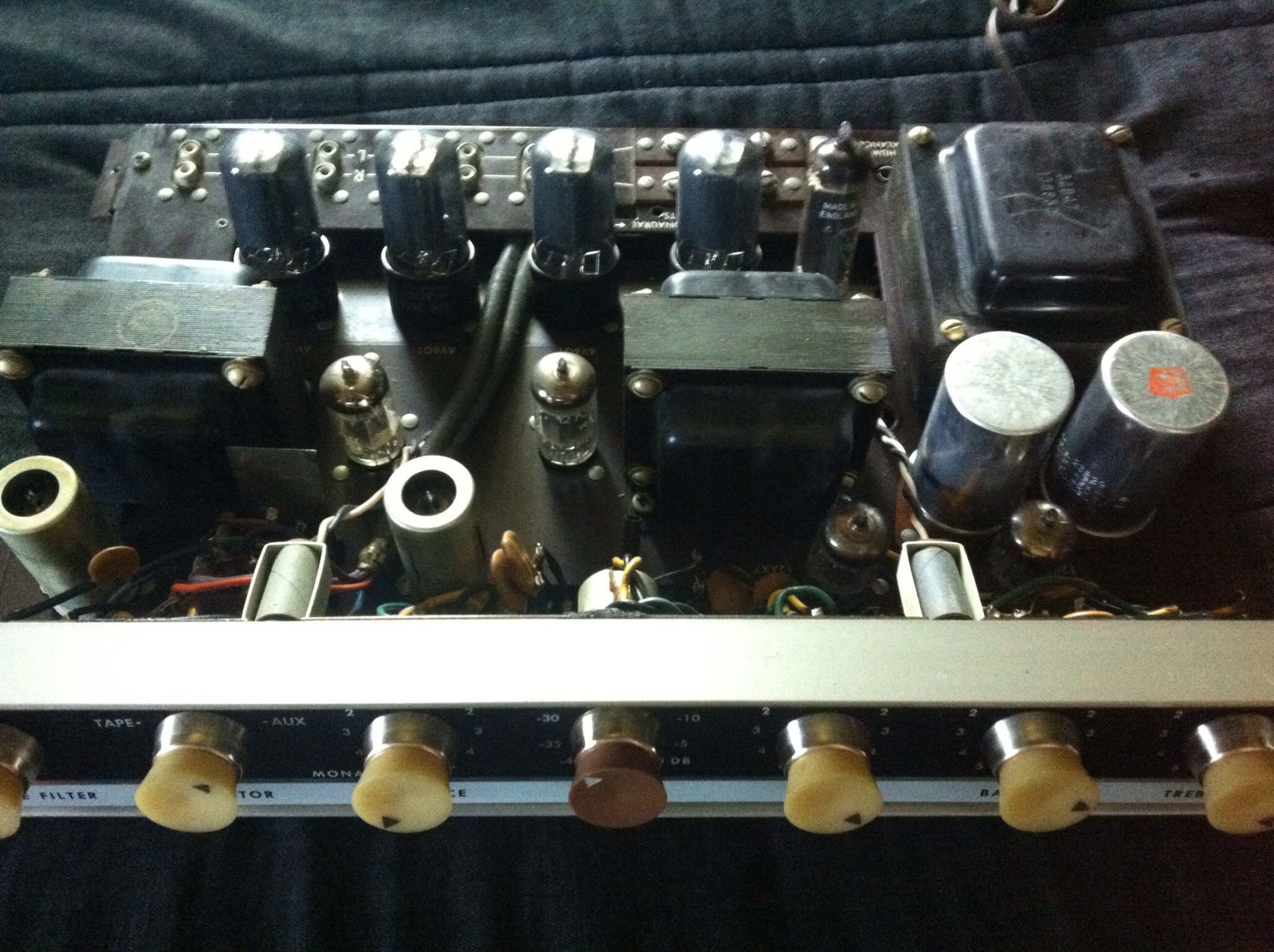

I use a podx3 live and have had a hard time getting the sound that I want. Plugging straight into the mixer leaves it sounding... Well, digital... Thin with little feel and no liveliness to the sound. And, plugging into amp just doesn't sound right to me.(I've tried every combination of settings no no avail.) So, I've been looking for a stereo tube amp to warm up the sound of my digital preamp.
I've settled on a Bell 3030 Stereophonic amplifier from the late fifties. I love the warmth and can tell that I'm headed in the right direction. I don't need to do a complete conversion over to a guitar amp because that was part of the problem to begin with. What I need are some little tips and suggestions to try and get the most out of this amp. Like try this cap here or this resistor there, or I would try to get this voltage here or there by doing this or that... with a quick explanation as to what the adjustment will accomplish.
I plan to gut the "loudness" circuit, the bass/treble circuit and the riaa mess in the first preamp stage. I'm not sure what to replace it all with? I was thinking maybe the baxandall tone or something that will give me a flatter frequency response than the standard TMV tone stack to start with, but still give me a bit of tone adjusting after that.
Anyway, I've never posted before and am not sure as to what type of response I will get, but looking forward to hear all or any of your thoughts!
It's a 6v6gt stereo push-pull amp with two 12ax7 gain stages as well as a 12ax7 Phase inverter per two channels. ATTATCHED is the schematic.

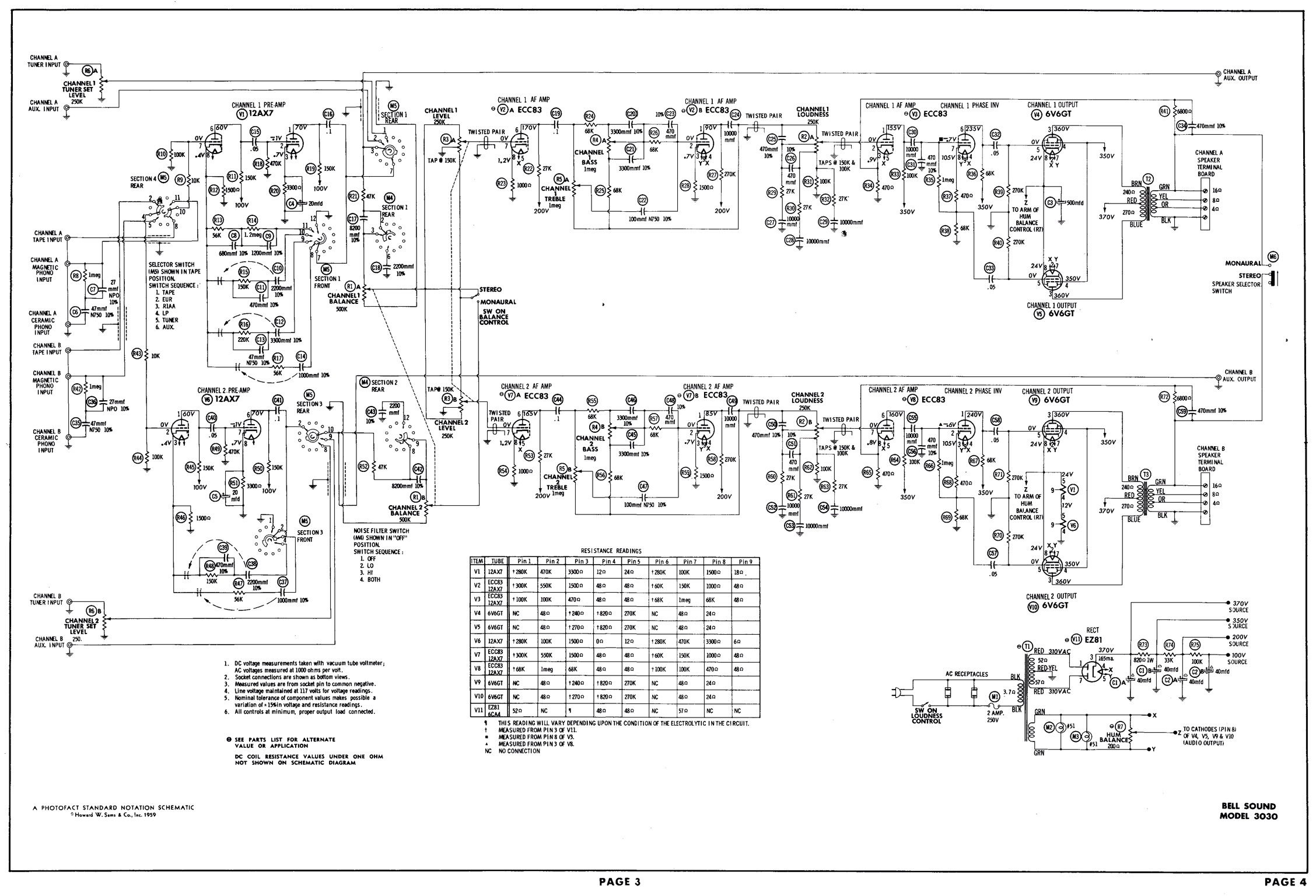

Strip everything to the input of the second 12xa7 and rewire with input from your favorite guitar preamp section around the first 12ax7.
Consider the 6SL7 in place of the 12AX7, -or- make a separate path and use that handy rotary switch. Try also different cathode grounding schemes, with different value resistors paralleled with any where from 2 mf up to 20mf. Also push-pull preamp going to the push-pull 6V6 finals. You have a bunch of real estate to play with. Do you have a resistor decade box to hook up in circuit & find what sounds good to you while you play? This is a huge time saver.

Have you tried the Pod into the Aux or Tuner inputs? They bypass the 1st stage.

I'd leave it mostly as is. If anything rebiuld the phono /ceramic /
taped head section along the lines of guitar ampllifier input,
noting converting them to one input, the phono /ceramic /
tapehead switch positions could offer 3 different variants
of the basic input circuit.
All you need to do is play with the 3 different
feedback networks, and link the 3 inputs together.

To reduce bottom end experiment with C19 (0.1u). Try .047, .022, .010 to taste.
Add some top end by bypassing (bridging) R23 with a small cap. Try .22 to 2.2u.
With two channels you can compare before and after against each other.

Yes. I'm pretty sure I am going to keep it stereo. I am getting all kinds of ideas from your interaction and I haven't even received my e-caps yet🙂. As was suggested earlier, I am going to start small. Learn as is and then make small changes to see what happens.
I think the first thing I will do is experiment with djgibson's suggestions of playing with c19 and r23.
Then I think I might eventually go with MaicoDoug's 6sl7 idea. I could make two stereo sets of inputs. One using the tape/aux input and bypas the first stage. Then I can use sreten's idea and flavor the first stage for guitar without the pod amp simulator... Better yet! I can keep a stereo input at the second stage level and creat a mono high gain channel with the two first stages of 12ax7s.

The 6SL7 idea is for high gain inputs, like phono. Guitar is also a good use. Switching the DC bias "off" with one tube and "on" to the other, would make an interesting swap that you can do with the input rotary switch possibly. But I'm looking at this as a 100% guitar amp. Rarely if ever would one use am amp for both. I used to use my pioneer amp for practice, everyone liked the "clean" sound of 20 watts!
Your posted picture is sweet heaven, nice. Dual PP 6V6s. Easy 40 watts total out.
