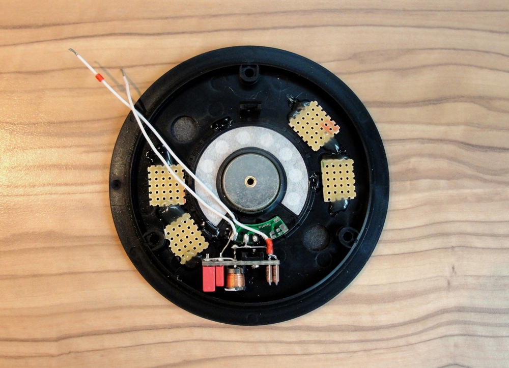

I do have one headphone which I did not change the wiring through the head band.
It is my 30€ Superlux HD662 Evo 2, which I use for testing amps before risking expensive ones.
Modded as per DIYaudioheaven, plus a 9kHz notch.

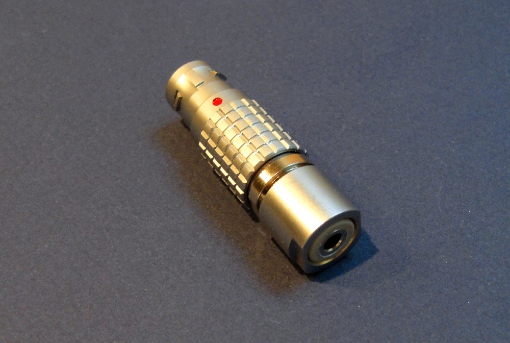

Plus a TRRS to Lemo converter which is convenient for testing any other phones with 3.5mm TRS.

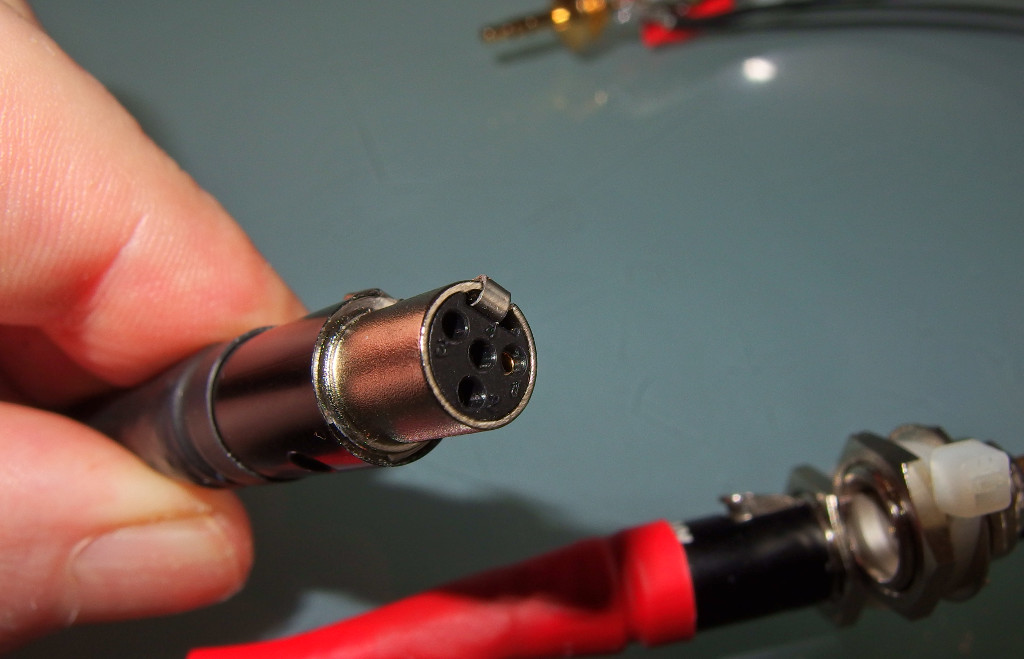

So I decided to terminate my headphone cables with standard 4-pin mini-XLR plugs to directly connect into the headphone amp, or attaching a mini-XLR to TRS adapter for use at my desktop DACs.
The 4-pin mini-XLR's are barely big enough for two MOGAMI 2330 plus the two grounding wires, but its worth the effort as those have reliable strain relieve, are of good quality, widly available, reasonably priced and backed up by NEUTRIK / REAN, an innovative company with excellent reputation for audio plugs.

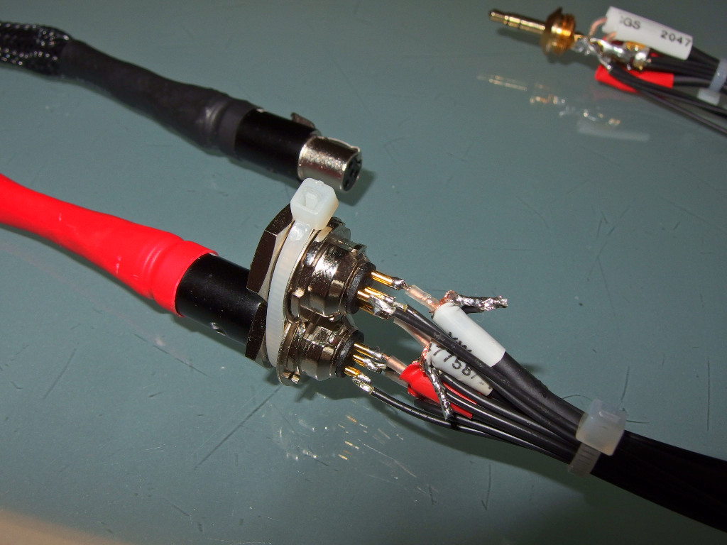

So I soldered a short - about 10cm long - mini-XLR to TRS adapter.
For such a short distance compared to the 2-3m of the headphone cable, I thought that using simple stranded wire should be of no problem. Far from it, the benefits in SQ from above scheme were gone almost completely!
Uhhhh?

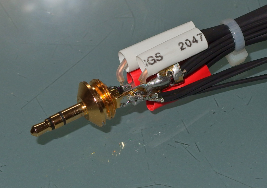

So I did a second run for the adapter, again using MOGAMI 2330 shielded cable, grounded down-streams.
SQ now is as good as it is without adapter.
Only drawback is, I have to figure out, how to reliably cramp 4 shielded cables plus 8 stranded AWG22 cables into a 3.5mm TRS plug.
