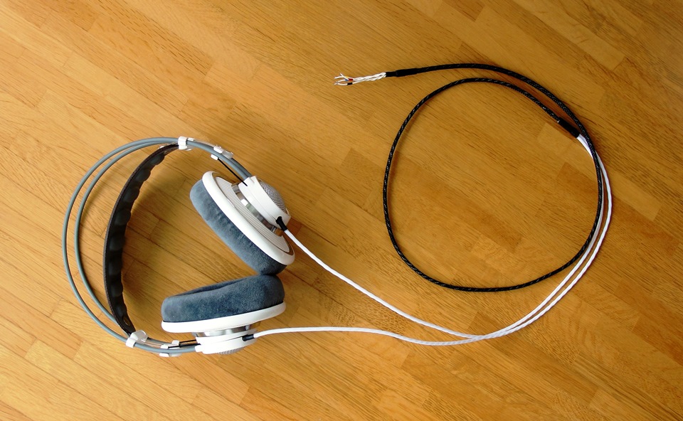

Should you happen to own, or intend to buy a AKG K7xx, in particular those with detachable 3-pin mini-XLR cables, do yourself a favour and mod those to full symmetric, as the K701 ancestor was shipped with.
This brings the full flavour of spatial clues right to your ear. Not only improving upon the sense of the acoustic room meant by the original mixdown, but also in tonality and resolution and more subtle, even on PRaT.
The original cable of the K701 still is available as cheap replacement part from Thomann for example, being comfortable, durable and of excellent sonic performance
AKG K-601 / K-701 Spare Cable – Thomann UK

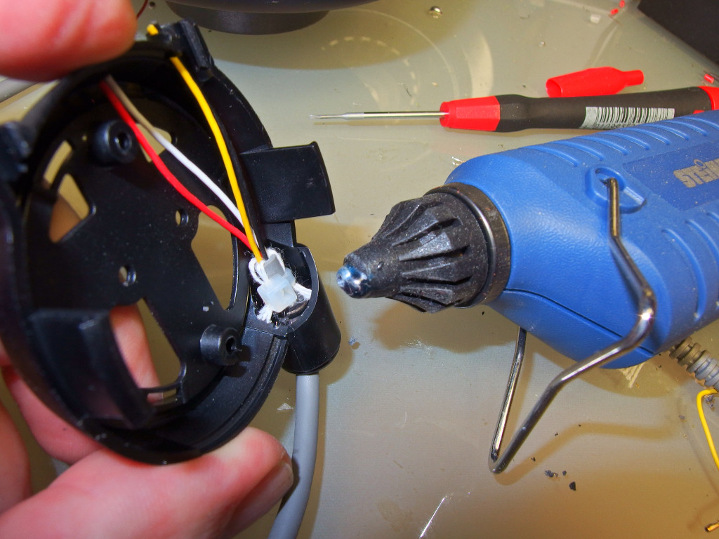

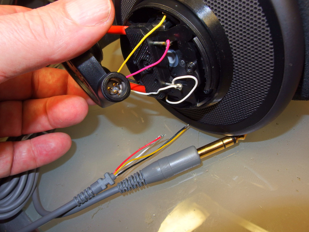

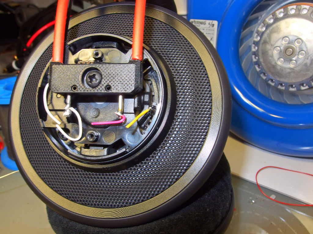

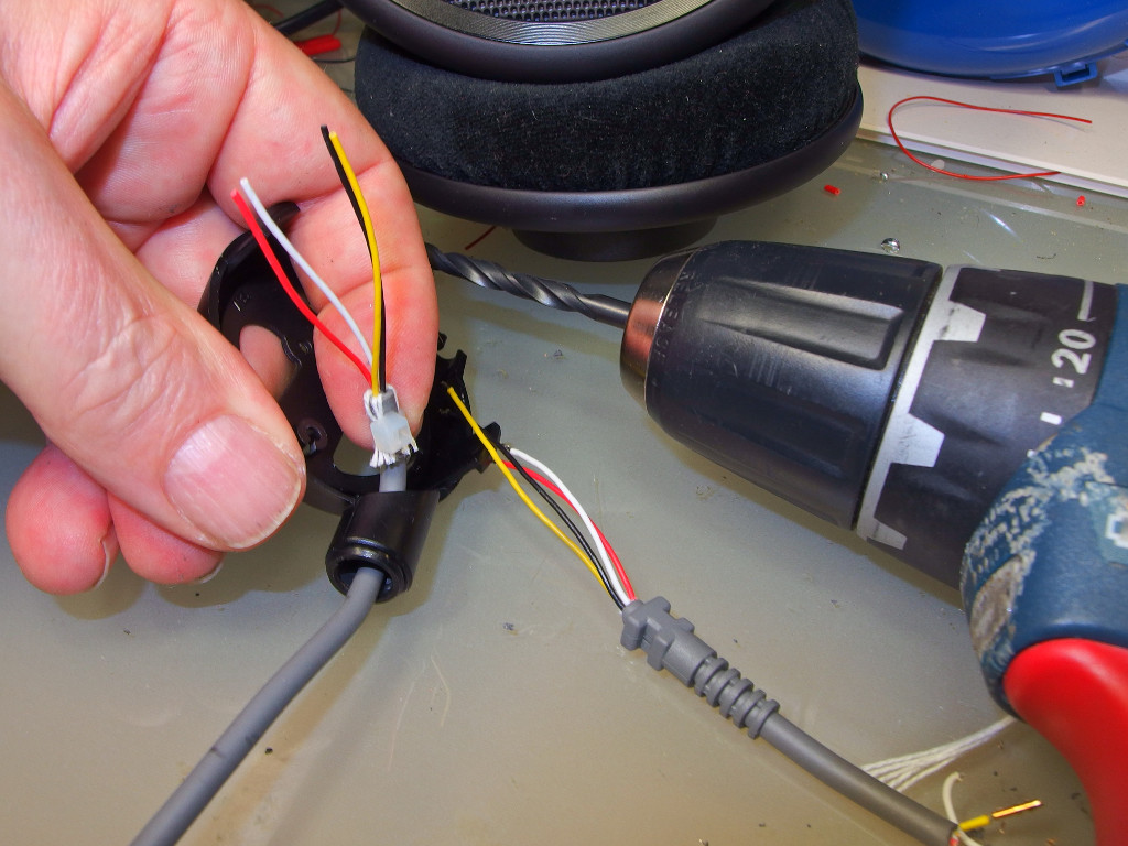

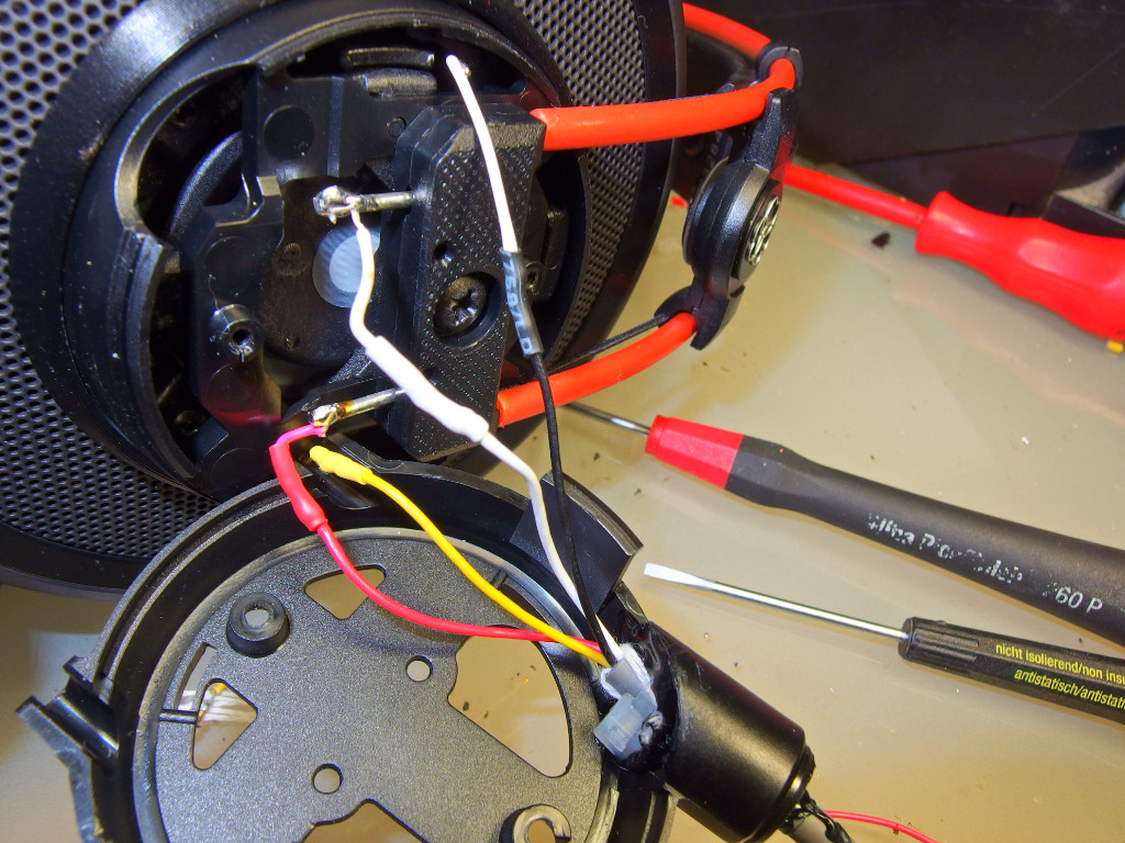

here is how to open the K7xx without damaging:
YouTube
Some pictures below, how this can be done the easy way and in about half an hour.

A 4 wire mod as shown in Post #1 is IMHO only half way.
The right hand driver still has electrical connection through the head band.
To go the fully distance, one should perhaps consider a symmetrical Y-cable with entry directly into both cups.

^ This is the true symmetry re-wiring.
Doing this way requires drilling an opening in the earcup though.
