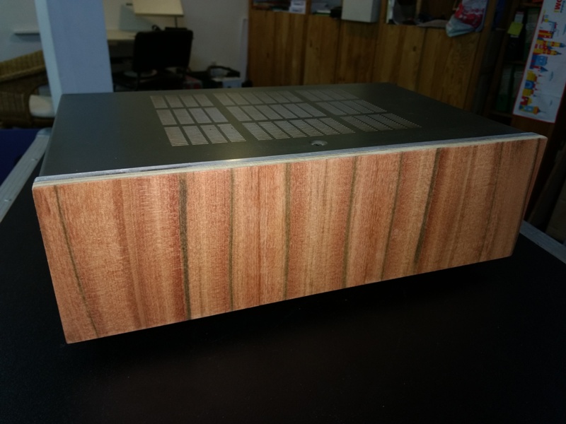

An old case can be made "nice" again. But, yes, it's time consuming and somewhat frustrating at times.
if the old amp is nice looking, it is fairly straight forward.
