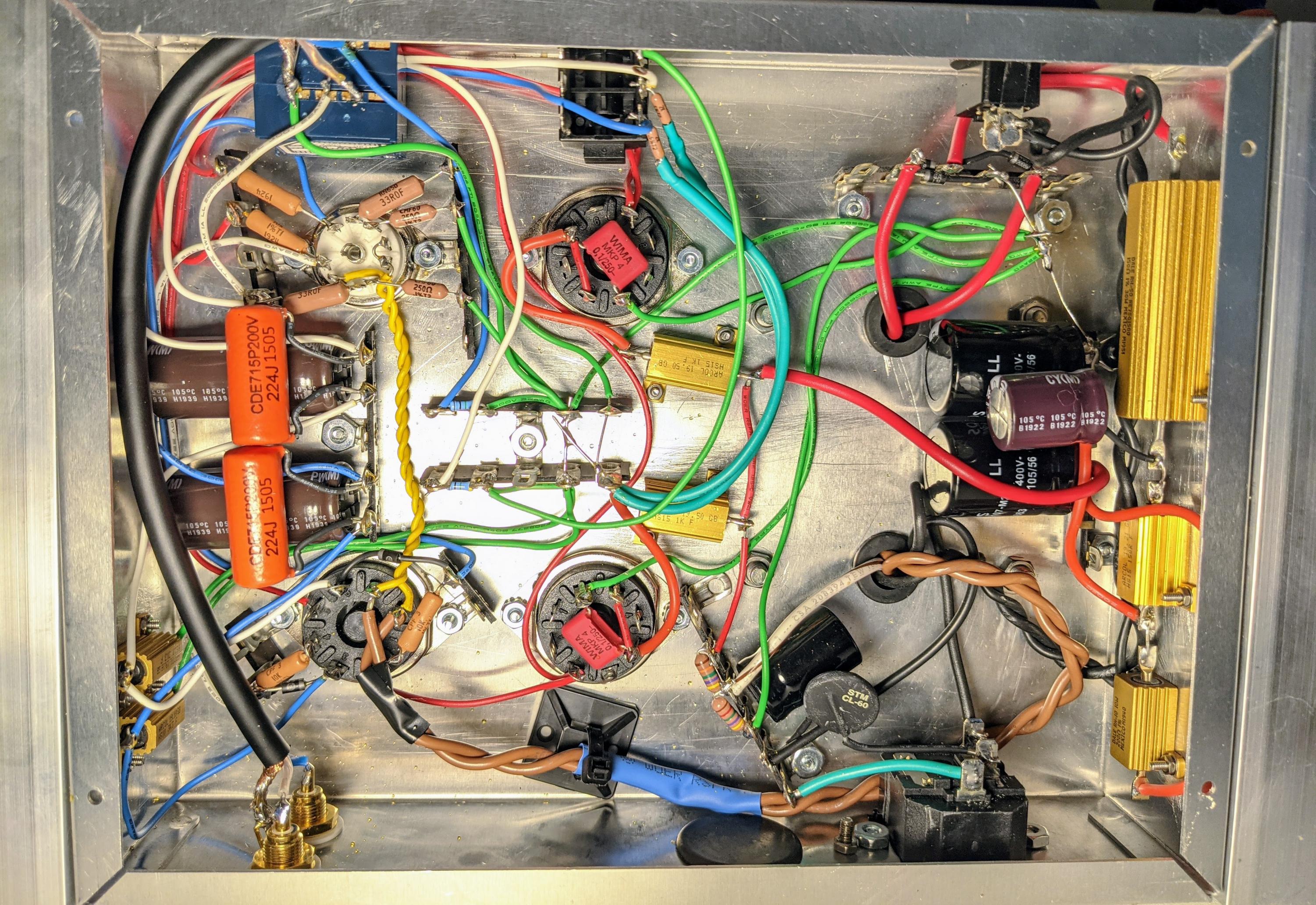

Modified Van Waarde OTL HPA w/ 0D3 regulator

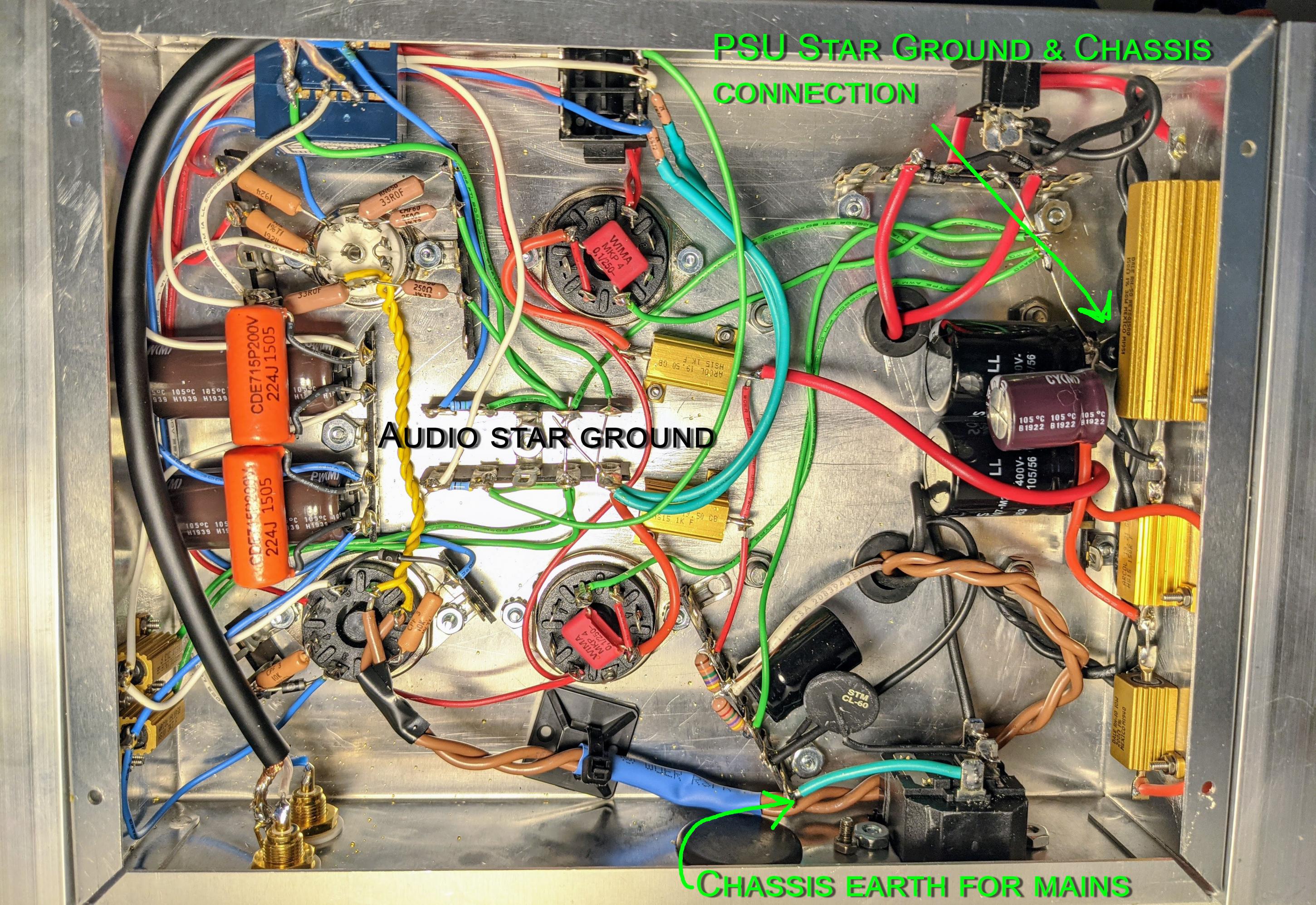

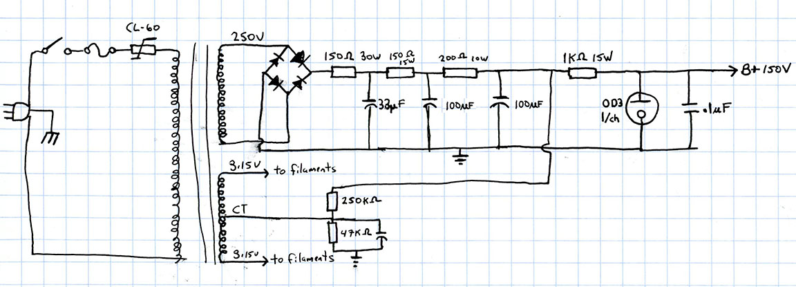

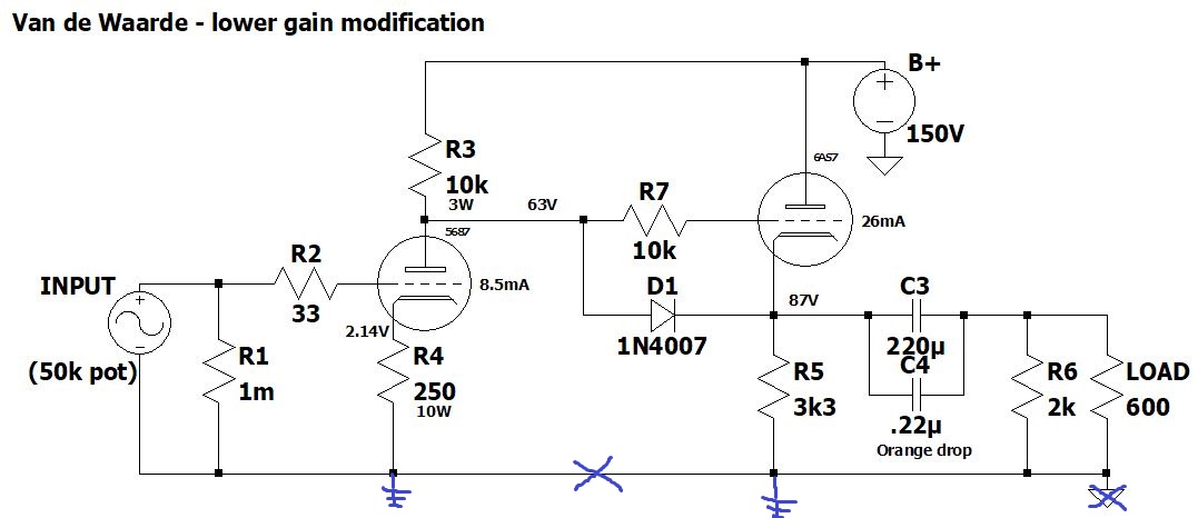

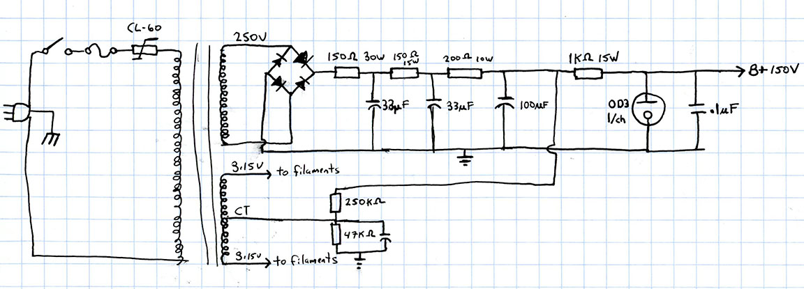

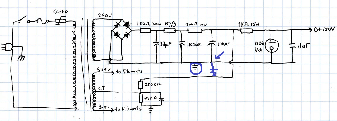

How I would have built this amp:
- bring L and R ground separated to the volume control
- connect L and R ground from VC to the base of the cathode resistor and run from there to star ground (per channel)
- connect grounds as per these drawings, earth sign indicates starground connection
