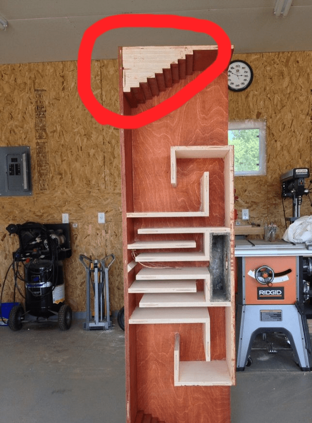

Then I doodled around and had an idea. Why not move the vent around a little and have it pointed to me, the listener, like in a regular Voigt Pipe? Maybe add a deflector or a little "stairs triangle" (don't know the english word for it, I attached a picture with a red circle around it).

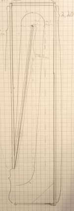

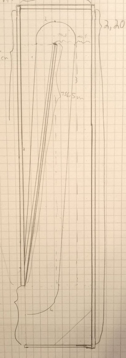

So I sat down with the BIB-excel sheet v.2 and entered some rough measurements just to try it out in a sketch.
I guess the questions I have, are the following:
1. Does a BIB really throw out so much bass at the ceiling/floor?
2. If it does, why not move the port around? Is it feasable/doable, or did I overlook some details that kill my idea?
What are your thoughts on this?
The terminus of a voigt like the BIB needs to be extended by the room, ideally a corner. This can be the ceiling (regular BIB) or the floor (invertedBIB) where the driver does not lead to a large enuff pipe to reach the ceiling.
This because the box is not big enuff.
The Karlson slot in the iBIB is intended to make the end of the line more “squishy” and spread out the unwanted harmonics a bit more making them less of an issue.
Deflectors are usuullay counterproductive.
dave
Ahh, okay, so my idea doesn't really work then because it's lacking the corner/ceiling/floor-loading that normal BIBs or the iBIBs have, right?
Correct, need to view them acoustically as just a huge OB folded up to fit inside a room, so without any back pressure to compensate, the driver will just 'flap in the breeze' same as an OB below its upper mass corner (Fhm = 2*Fs/Qts') where T/S theory box design peters out.
(Qts'): (Qts) + any added series resistance (Rs): http://www.mh-audio.nl/Calculators/newqts.html
