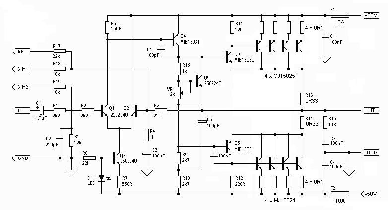

I need a cheap/simple amp for biamping purposes. Since I already have two 500VA 2*38V toriod transformers I wan't to use them. But this will create +/-50V a little bit too high voltage for the ESP3A amp, I will use 4 ohm speakers.
So I did some changes to the circuit, but I'm not 100% sure that it will work OK. I know the outputstage could be smaller, but I like when things are a bit oversized.
Suggestions?, Comments?
