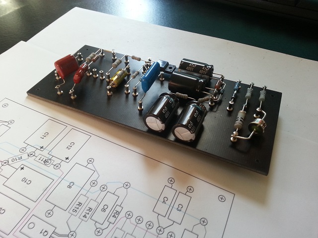

Got some time off, and it was a nice spring day so decided it was time to get some real work done on this project out in the garage.
This is the first turret board I've done, so I made a DIY anvil and swage as per the tubedepot plans, with one exception. I had to use a 2" bolt for the anvil as most of my turrets were placed pretty close together. Also, not that the 1540-4 turrets require a 3/32" through hole for swage fitting. Use a #43 drill bit for press fitting.
It was a lot of fun to make, and I think it turned out pretty good.

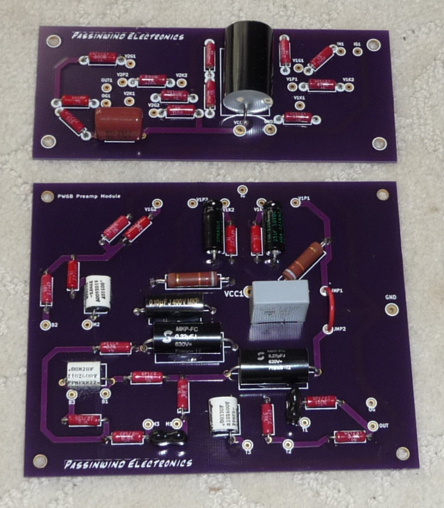

Nice job, I need to give that a whirl sometime. I'm building a tube bass preamp myself at the moment (1-6SL7, 2-6SN7s), here are my first-ever attempts at doing printed circuit boards:
It will still be a while before I even start ordering and collecting the small componets for the naked double-sided Trace Elliot V8 circuit boards. I'm pretty thrilled though that the preamp is just as exceptional as the power amp. The preamp has a switchable additional gain stage and a good controllable tube compressor.
It seems to me it's not much more trouble to build two, since most of the work is in finding the parts when I already have the circuit boards. So far I have two preamp boards and one poweramp board and one set of transformers.

Those boards look like a great deal. Tube power amps are just not my thing really, but ...😎
Hey Charlie, fellow talkbass guy here. Nice PCB's! Did you do the fabrication yourself, or have them made to your design?
The turret board was pretty easy to make. Hardest part was filing down the bolt to make the swage, but that was mostly due to my crappy files and slow drill press. Came out good though, the turrets locked into their holes nicely. The epoxy coated G10 is also pretty easy to work with. Cut smoothly with a jig saw. I did the layout in Draftsight which is a free 2D CAD program that resembles AutoCAD pretty closely.
I used OSHpark for fab, who are now handling BatchPCB's order fulfillment as well. The only real downside is having a 3 board minimum, but everything else about using them is pretty painless -- not counting learning how to use KiCad or other board layout software of your choice.
Thanks for the Draftsight tip, that would've come in handy for all the custom mechanical bits I've been making.

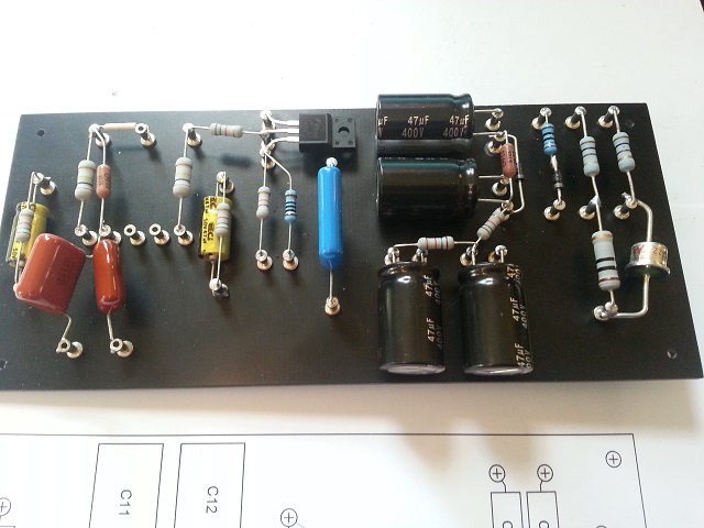

Finished as much as I could of the board for this project. I was short the small caps for the treble control and the bright/deep switches. I think it came out pretty good. I wasn't happy with the layout around the two big caps in the tonestack, and I underestimated the size of the high current diodes for the ground loop breaker. Not bad for my first turret board.

By the way, sorry for the crap photos. I need better lighting and a real camera.
