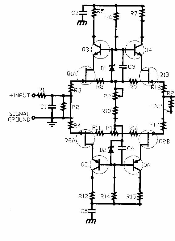

Interesting that a lot of the 555 suggested mods were stock on the 555II (better input jacks, no electrolytics in the signal path - I believe it also has a CCS in the input stage).

Finally dug into the 535 and removed the psu board. Wouldn't you know it - the caps are not snap-in types. They are radials with 3 leads (the extra pin is not soldered to the board and no trace is connected to it). Also, their diameter is smaller than a 6800 uF 63V snap-in cap. There isn't an easy way to populate the board with new caps...real estate is too tight in there.
So, plan B - taking out the awful speaker connectors opens up some space on the PSU. I'm going to lay out a new PSU board to allow snap-in caps up to 30 mm in diameter. Also, I can get some more real estate by removing the traces for the "B" speaker connectors.

Increasing the capacitors: from 6.8mF to 10 mF ; Do you think that the amp must be rebiased to keep the bias under the design parameters ?

Regarding the caps, if they are 6.8mF now, going to 10mF is not going to destroy anything. Going way higher, say 47mF a piece or so, you might want to add something to limit the startup current.
IMHO, more gain is to be had from using better capacitance, by using the suggestion in Walt Jungs "Picking Capacitors" article, and bypassing the big elco's with filmcaps.
