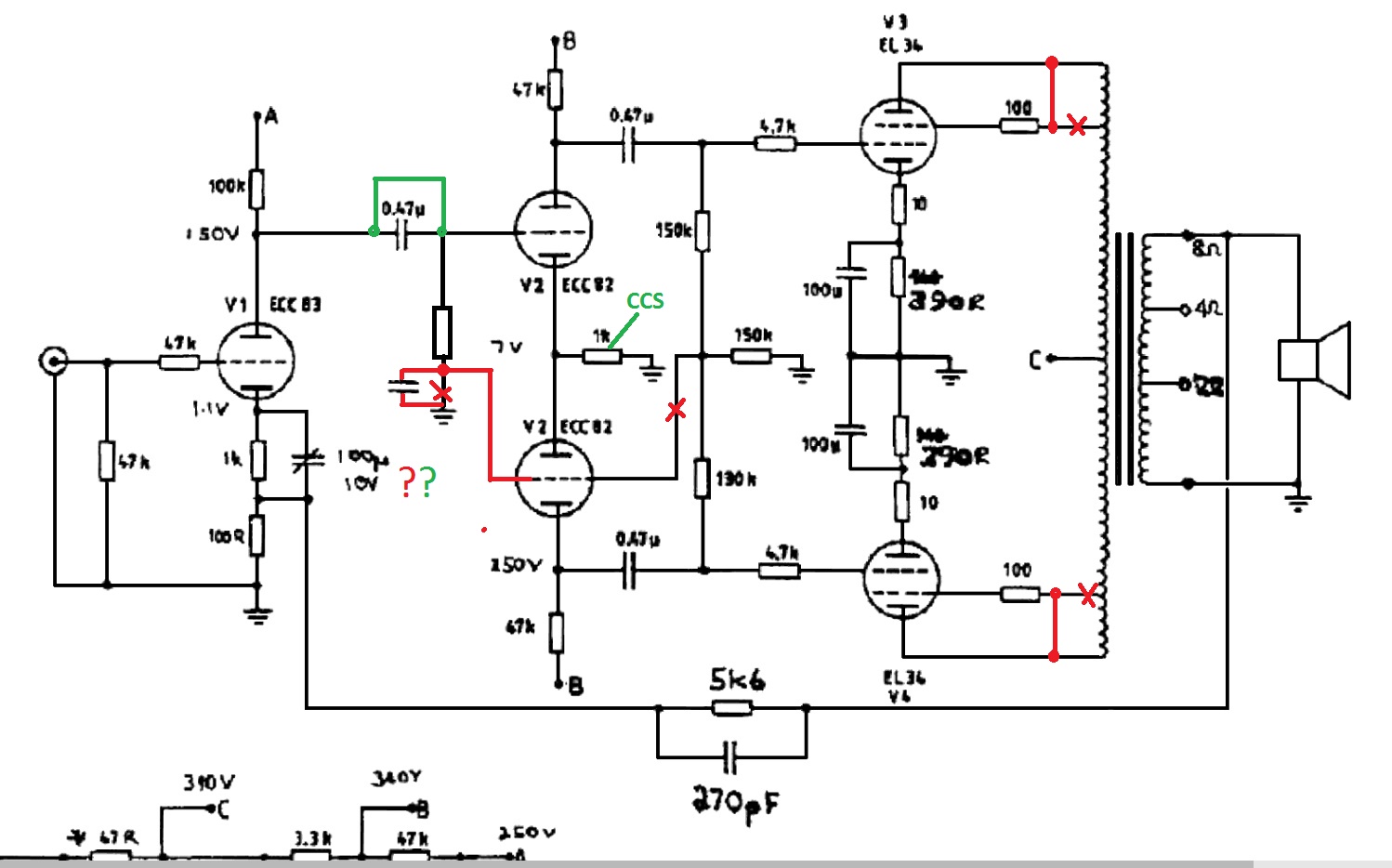

My learning-hack amplifier, an well worn Audio Innovations 800 need repair again. Faulty PCB due to heat. I have decided I want to implement some modifications while working on it. I hope fellow forum members can chime in with advise on feasibility of my planned modifications. Attached schematic show EL34 for outputs, these has been replaced by 6L6GC tubes.
My ideas are to implement and test in three phases:
1 - Triode wiring of 6L6 output tubes (indicated in red in attached schematic)
2 - Modify phase splitter from paraphase to LTP, making it similar to classic Mullard design (also red in schematic)
3 - If 1&2 goes well, DC couple input stage and implement CCS in splitter (in green). The later would also mean a rewiring and elevating the ECC82 heater supply (not shown)
My prime areas of concern are:
1 - Will my changes as drawn work?
2 - Will this have negative influence on stability?
3 - Can I remove the 100u decopling capasitor on the input stage? If so what will happen to frequency respons and stability.
4 - What kind of test should I perform for each stage of modification?
All feedback appreciated

Have you modified the amp to dramatically reduce that 47K grid stopper on the 12AX7? Replace it with a 1K resistor while you're in there.
The 150K and 130K grid leak resistors on the output stage need to be the same value if you do what you're doing.
When you do a mod like this and you directly couple the second stage (good plan), you'll want to look at the power supply to see if there's some extra voltage available for the 12AU7. 12AX7s also do well with more voltage and a higher plate loading resistor.
Pay close attention to the heater/cathode insulation rating for all of your tubes. I don't think you'lll run into issues, but this can be a bit annoying to hunt down if you forget about it.

Removing the cathode decoupler will reduce loop gain, so improve loop stability at the expense of increased distortion because there will be less loop gain available to linearise the output stage.
A 12AU7/ECC82 LTP will be unbalanced without a CCS tail. That may be why the Mullard circuit uses a 12AX7/ECC83 LTP - this will work fine without a CCS.
I like the idea of your modified circuit.
As was stated in the thread, the filament to cathode voltage of the ECC82 will need to be addressed.
If you can, add a separate small center tapped 6.3V filament transformer, and tie the center tap to a resistive divider from B+ plus a bypass cap from the bottom divider resistor to ground.
That allows the voltage to be near to the cathode voltage, but without raising the filament DC voltages of the other tubes (the reason to use a separate 6.3V transformer). Be sure to locate the new 6.3V transformer so that its magnetic field, and its primary power wires do not interfere with the rest of the circuitry.
Make sure that the CCS for the ECC82 can take the maximum voltage of the quiescent cathode voltage, plus the largest signal voltage that will move the cathodes.
Do retain the input tube's cathode bypass capacitor across the 1k resistor.
You have reduced the gain of the output stage in two ways, the lower transconductance of the 6L6GC versus the EL34; and because of the change from Ultra Linear to Triode wired.
The triode wiring causes there to be a lower output impedance, with or without negative feedback, versus Ultra Linear with or without negative feedback.
Triode wiring will have lower power, but lower distortion.
Do match the output stage grid resistors, either make both 150K or make both 130k.
And do keep the individual self bias resistors and separate bypass capacitors, it will aid in matching the tube currents in the OPT primary (check that the cathode voltages match, or find better matched tubes).
Because of the reduced gain of the phase invertor, the input stage may not have enough swing to drive the invertor.
I that case, you will either have to adjust the input tube bias and plate load, or more likely have to use a different driver tube.
Without using negative feedback, there may be both enough gain, and enough swing by changing the input to an ECC82.
Do not forget to change the input stage grid stopper to 1k, as stated in the thread.
Try the new circuit first by removing the feedback parallel resistor/capacitor feedback network from the output transformer secondary, and move the input tube bypass capacitor across both the 1k and 100 Ohm resistors (cathode to ground).
Listen to that amp topology first.
Then reconnect the bypass capacitor and the feedback network as in the schematic, and listen to that amp topology next, and decide on which sound and which gain combination you prefer (or make it switchable).
Strange, I spent many hours looking at the schematics for this amp, and never noticed the high value of the grid-stopper.
Thanks for reminding me on equalizing the grid leaks for the output stage.
So, with this simple circuit a CCS is a must. If I leave the amp AC coupled the tail voltage will be very low at about 7 volts and I can use a simple 3 component LED/transistor/resistor solution. If I DC couple with the input I have about 150 volts and 2W to burn and will need a different solution.
I did try with ECC99 in place and liked the sonic improvement, therefore I am reluctant to go with high Rp device like ECC83. I do have ECC88 and ECC81 available as potential alternatives, but feel that this constitutes a larger change of the design, e.g. stability effects and loading of the input stage. Also available is ECC99 and 12BH7, but these caan not be used until I rewire the haters due to transformer mechanical hum from excess load and would not add anything towards gain/balance

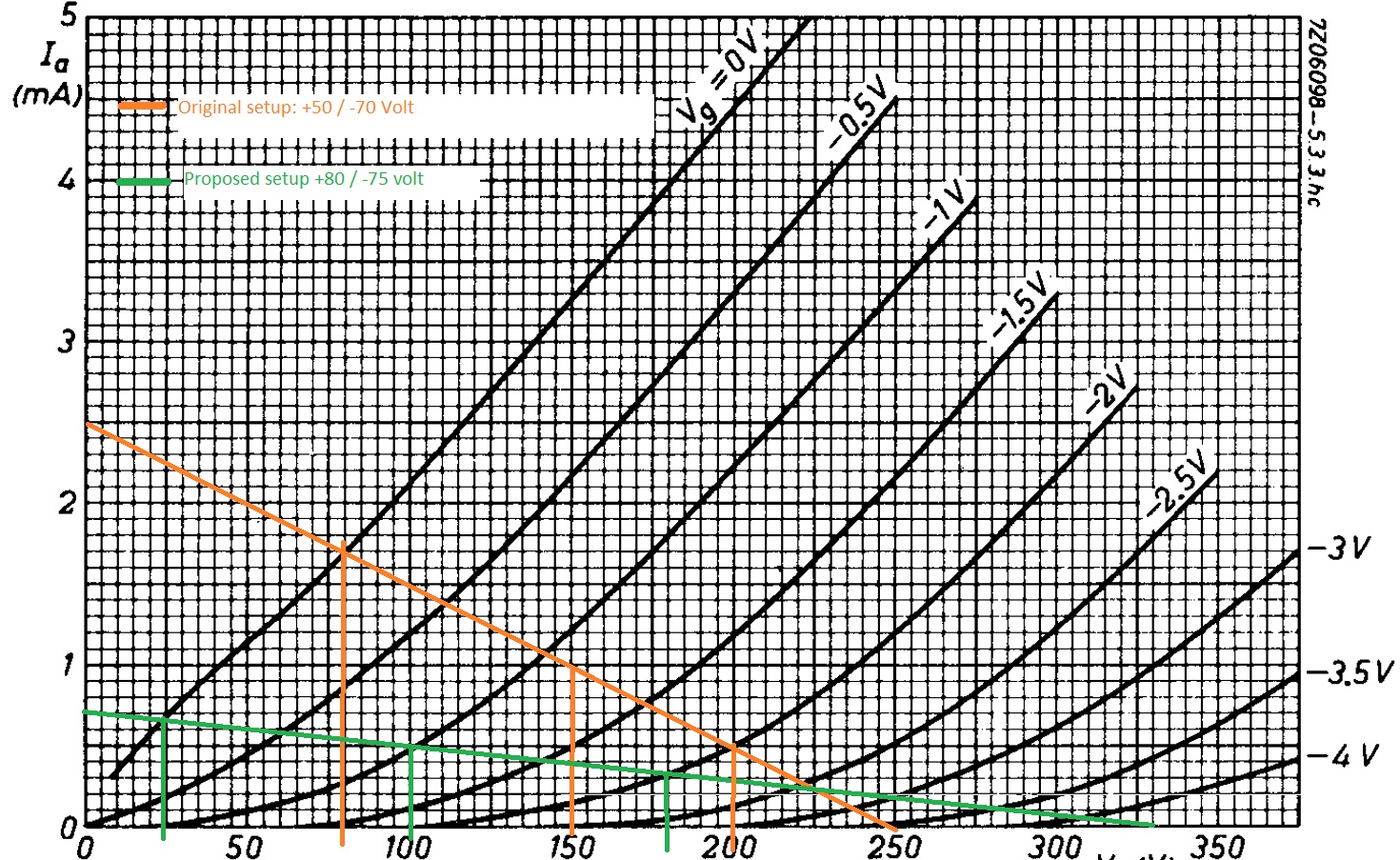

On the 12AX7, try 100VP, 1V of bias, and 0.5mA of plate current. Make that 47K power supply dropper into 4.7K. Use a 500K plate loading resistor. Total resistance under the cathode drops to about 200 ohms. This will give you very high gain from the 12AX7 with very low distortion, and it will reduce the amount of voltage dropped across the CCS.
The LTP will give you some gain, but you need to lock down a number for the bias voltage on the output tubes, then work backwards to be sure your driver stage can deliver the goods.
So to see if I have started to grasp load-line theory, I've attached a graph:
The original setup will be as per the brown curve lines, with a +/- 1V input generating a +50 / -70 volt output.
The proposed load-line with a 2K cathode resistor, higher plate resistor and increased supply voltage will be as per the green lines with the same input signal generating +80 / -75 volt output.
This corresponds to a gain improvement of 1.7 dB at a much lower distortion. The cost is the increased output impedance.
If I understand correctly increasing from approx. 42K up to 68K. I understand that this may have a negative impact on the input stage ability to drive the phase splitter and consequently the frequency respons.
The new tail voltage for the ECC82 phase splitter will be about 95 volts - is this sufficient for bias setting using a simple resistor or is CCS still recommended?
Grid voltage is about -26 Volts and 6L6 current approximately 66mA. I guess that means that my LTP need to swing between 40-50 volts p-p with Va-k of 230 volts.

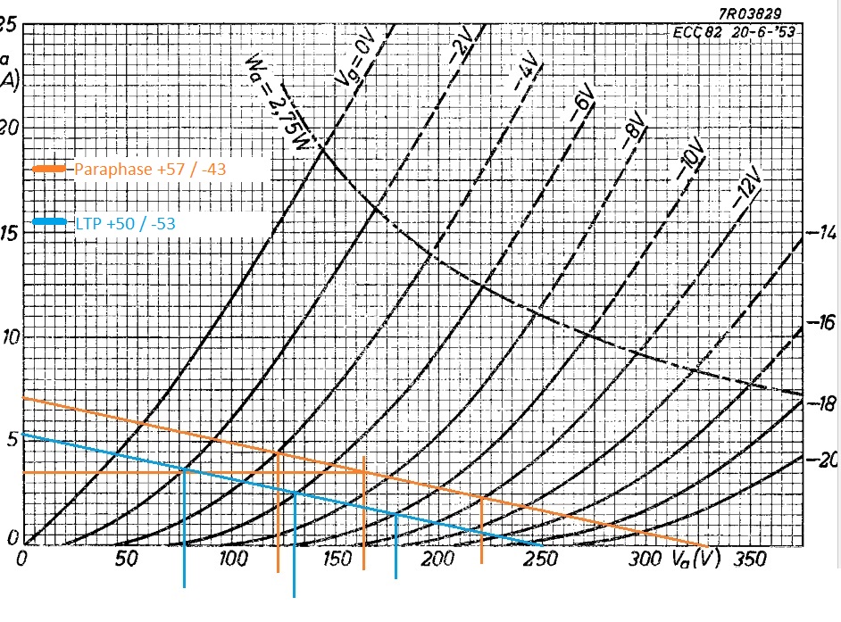

Would I be right in thinking that 2.5mA per triode (-6v) would be a good operating point for the LTP and that this would equate to 18K tail resistor? (assuming DC coupling to 100V anode of input stage)
Do plan to use a CCS, it makes a humongous difference in a LTP phase inverter.
The new load line for the AX7 looks good. Output impedance isn't earth shatteringly important here since the LTP doesn't have a ton of gain (keeping cMiller under control).
I'd aim for a little extra bias voltage on the LTP if you can get away with it.
