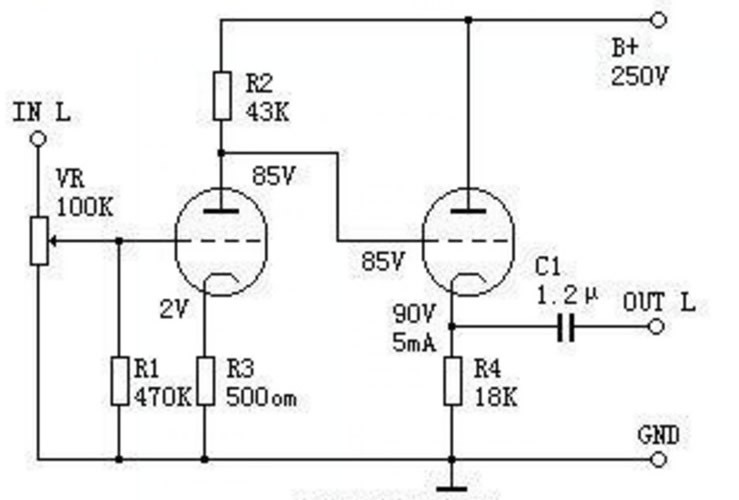

Just for giggles, I simulated the circuit in the second link, https://a.aliexpress.com/_mOTjWjO.
The audio circuit is basic, simple:
I will assume the power supplies are competent. I didn't check them.
LTspice predicts 13x gain (22dB). For a 1kHz sine wave input, 1V rms out into a 100k ohm load, THD is predicted to be 0.04%, which is OK/mediocre.
The first triode draws about 4mA plate current. The second triode draws about 5mA plate current.
The voltages and currents on the schematic agree with the voltages in the simulation, so the design looks OK.
This looks like it should be a good choice if all you want is a line level control preamp that adds a bit of tube sound.
The gain is quite high, so it will be best used with power amp or powered speakers that aren't already very sensitive. If you have powered speakers that can be set to 'pro' +4dB level (instead of 'consumer' -10dBV level) then this should work fine.
How would one improve it?
You could try Broskie's 'CCDA' idea and get the plate current of the two triode sections to match. That would require getting the voltage at the plate of the first triode to be about 125V (half the B+) and adjust values of R2, R3 and R4 so that both triodes draw the same plate current and the value of R2 equals that of R4. Whether this would be an actual improvement in use is debatable. It would reduce the gain a little.
PS - You can make it a CCDA by changing the value of R2 and R4 to 22k (2W or better), leaving R3 at 500 ohms. The voltage at the plate of the first triode (on the left) would be about 124V. Both triodes should then draw about 5.7mA each. Gain would be about 10x (20dB) and THD would be just a bit higher.

https://a.aliexpress.com/_mOTjWjO , which I’m completely unfamiliar with.
This preamp, with some good tubes, actually was the winner in my china preamp shootout. Lots of gain, sounds sweet with the only downside having a bit of hum, which would only be a problem with super efficient speakers. I fixed most of the hum simply twisting the wires that go to the front mounted switch.

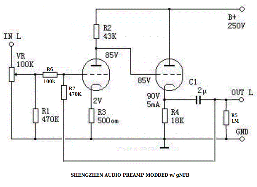

What we want is a line preamp with no more than 12dB (4x) gain.
One cheap 'n easy way to do that is to apply a little negative feedback (( 😱 ))
R6 and R7 create negative feedback to reduce the gain of the circuit to about 3x, You could make R7 a bit larger in value (560k or 680k) to reduce the amount of gain reduction from negative feedback, to your taste.
R5 is added as good practice. It provides a load to the cathode follower even if it's powered up but not connected to anything.
