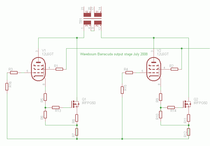

A vertical loadline will not exactly minimize distortion for a triode. Worse yet, you lose a LOT of volts, since the D3a in triode will want at least 120V on it at any sort of decent current, else grid current will become an issue.
If you're going to put the FET on the bottom, might as well put one on top as well. Makes for the same sort of pentode-ish construct...or just use a pentode; that'll do jus' fine. The cascode element could be of *VERY* low capacitance; the lower element controls this, in concert with the d-s voltage likely established by battery biasing the upper one ~10V over it.
Also, according to the Philips triode data, most of the curvature is over with by 10 mA plate/g2 current, and by 20 mA it is quite a straight line v g1 voltage. That is hardly worse than a 12B4. I also drew a vertical load through tis curves at 100V; the spacing is quite even, as long as we stay away from the bottom( but that is also true for any load line steepness).
cheers,
Douglas
I've done it with a jFET (2N5566) on the bottom and a MOSFET (IRF820) on the top. It was indeed quite linear and swings a lot of volts. Tube fans wouldn't be pleased...
One thing I never got to work but seems worth exploring is to reference the gate voltages of the top devices to the junction of the sources of the bottom devices instead of ground. A battery might work in that application.

A voltage divider will serve well here. Bypass the bottom R( with the ref voltage across it ). I've had good results with this method with triodes on the bottom, and there is no reason it would not work just as well with FET's.
AFIK, there is no reason, sonic or otherwise to avoid the FET on top aside from Religious Fanaticism if a FET is used on the bottom...matter of fact, a fine enhancement-mode heaterless pentode amp can be made using the cascode element.
IMO, the gate capacitance variation due to varying d-s voltage is responsible for any issues I have with 'SS sound'. A good pentode design can be directly implemented with these devices; just be careful of D-S voltage ratings...for the power stage, 900 or 1k2V devices( on the 'top' element) would be very useful...there is no recovery from 'red-plating' a MOSFET...🙂

How about a straight BJT Darlington on the bottom and triode on top, allow a small DC offset on the input, quite small. Again some won't be pleased but is really does work. Use 2SC2547s. BTW, have you tried IRF710, a lot less capacitance and slightly less V and I rating.
Come again with that one? Hmm, that's interesting, but definitely fets on the bottom, otherwise a lot of batts in series. If source resistors, then reference it to the top of CCS.
But does it have to be battery? Look at above Vacuum State schematic and the use of LM329 6.9V @ 8mA - connect to CCS and any current thru LM329 allow an extra 8mA in CCS, otherwise your Anodes will go up.
Joe R.
The 329 approach is exactly the one I took, but it never worked right. So, it makes sense to revisit with batteries, which removes the issue of current. For me, it makes the most sense to have the SS stuff on the bottom, which makes the battery requirement simpler. In fact, you don't want the Vgd to be more than 7V or so anyway, else gate current starts to increase.
The IRF820 was the best device I could get in 1985 when I was doing these experiments. No doubt there are better choices now. I needed the extra voltage rating since the circuit was supposed to drive a screen drive output stage. That said, the capacitances are much less of an issue with the top devices- the gates are either at ground or a low impedance source. Bandwidth of the stage was superb- if memory serves, rise time was something under a microsecond.
