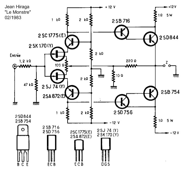

what are the modern incarnations of Jean Hiraga "Le Monstre" published in L'Audiophile n°27 (ancienne série) in Feb. 1983 ?

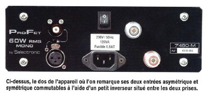

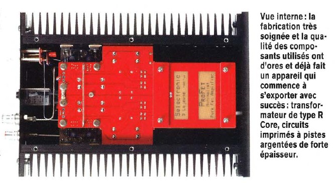

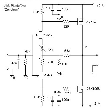

Or maybe Selectronic licensed the J.M. Plantefève "Zenotron" schematic and industrialized a deluxe version with a R-Core transformer and 8 x 10,000µF in the power supply. Jean Hiraga himself reviewed the Selectronic ProFet.
Wait a moment. This is a mono amplifier. I count 4 MOSFETS in total. It is a bridged tied load "Zenotron" incarnation with a floating power supply.
I'm looking to other schematics like "Zenquito" or "Buzquito" (or Mosquito). They feature a symmetric voltage amplification stage between the FET input stage and the power MOSFETS. Because of the additional phase inversion, the MOSFETS are now source followers. Shall we say these are modern incarnations of Hiraga "Le Monstre" ? If not, what is their generic name ?

How I can I convert Hiraga's "LeMonstre" to a CSPP version (cross shunted push pull)?

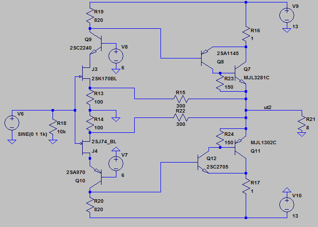

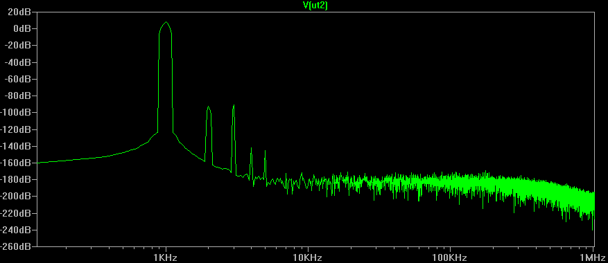

Very nice simulation ! What transistor models are you using ? The THD pattern looks very nice, like in a fully optimized amplifier. Are you sure you have not tweaked the models, making them more symmetric (or asymetric maybe) than they should ? By the way, I'm very curious to see the power supply rejection.Here is something I recently started to play with based on the old le monstre. I'ts in no way optimized but it is a start.
I use a few different models found on this board and for the outputs models from bob cordell.
Haven't begun in earnest with the PSRR as I'm using ideal voltage sources for biasing the cascodes.
Only voltage gain of x4. Hard not to plot a clean 1stW with that much feedback.
I know the voltage gain is low but there is no point driving the amp to more than clipping. The open loop gain is about 38db the closed loop gain 12db so its not more than about 25db used for feedback.
