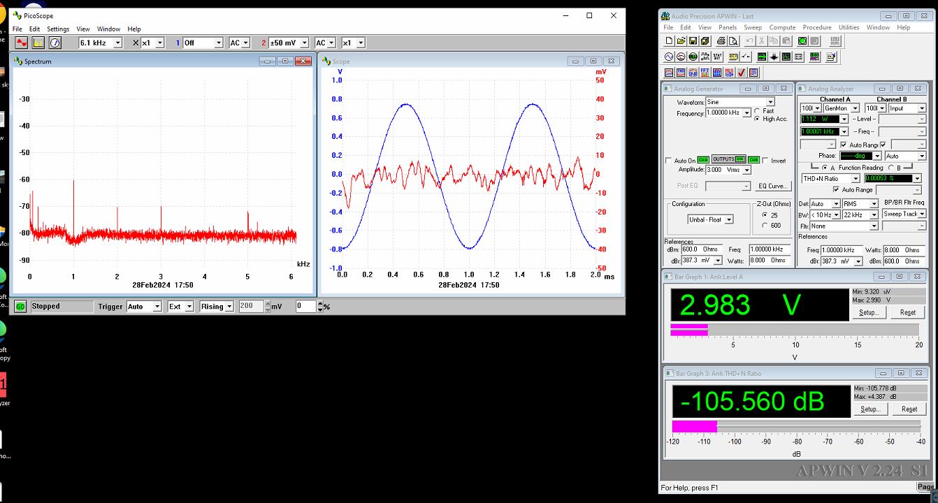

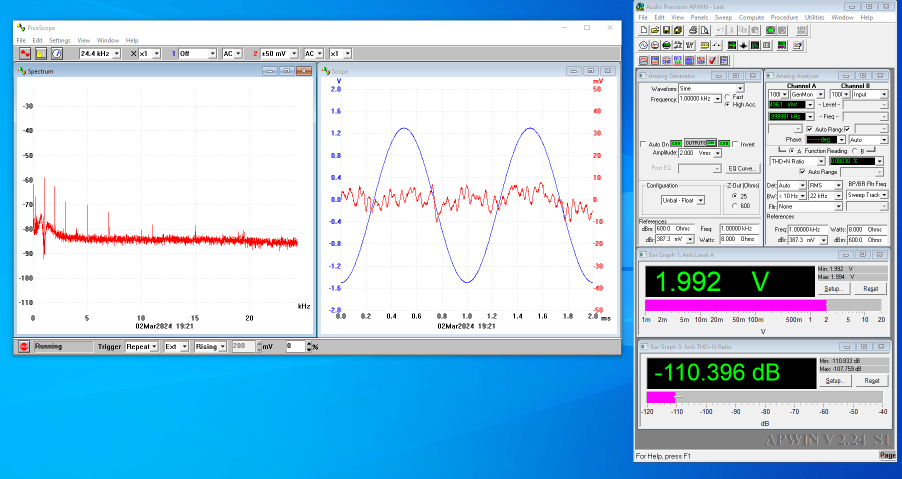

FWIW here is my setup with an AP system 1 and a Picoscope ADC 200-100 sharing a PC and screen. In this application the vintage 8 bit unit is more than adequate. There is a bunch on e-bay https://www.ebay.com/itm/1863168146...PzQR1X0dKrKFJdmKrF/JCSO9H9|tkp:Bk9SR9Cdlam-Yw and the old paralel port units can be made to work in a modern desktop PC. I find the PC scope klutzy for troubleshooting but great for waveform monitoring.

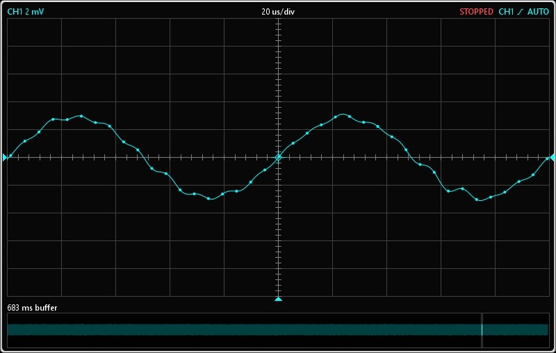

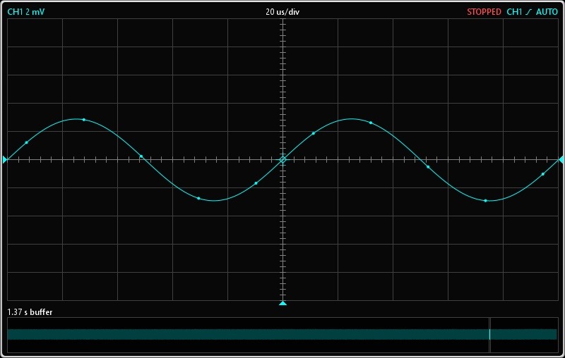

Have you tried REW with a usb interface? REW offers a crude scope display. May be enough for your time domain stuff.

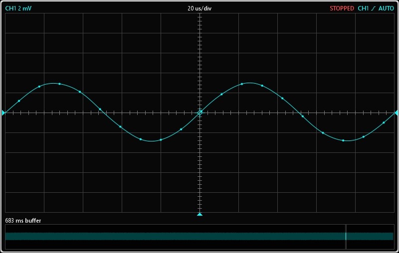

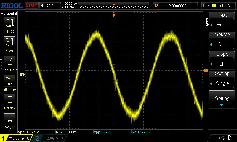

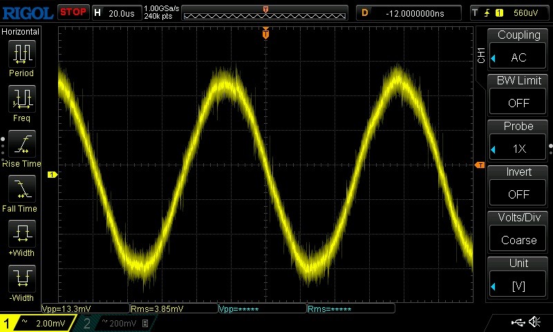

REW scope display is not crude. It has the basic adjustments of an oscilloscope (not yet an X-Y mode).
The basic difference is in the display of the signal, as displayed waveform is bandlimited to 1/2 the sampling rate of the soundcard.
Sometimes this is a feature (cleaning up a noisy signal), other times this is a limitation (don't see HF self oscillation)
Below is a weak 10kHz noisy signal.

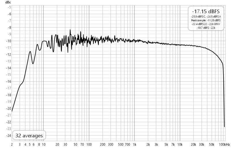

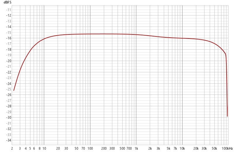

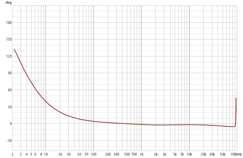

I have a Focusrite Scarlett 2i2 interface, with 44.1/48/96k sampling rates, but the frustrating thing about these "audio" interfaces is none that I've seen give frequency response above 20kHz. Has anyone actually measured them, and perhaps put the results on a webpage?
This is from the Creative E-MU 0404 soundcard.
Loopback test@192kHz sampling rate

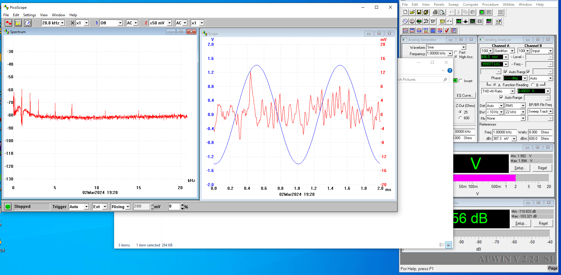

The picoscopes both arrived today and I had a chance to test both. This is 12 bit of the same as above:
And this is 16 bit:
in this application not much difference.
I'm sure there w be in other applications
FWIW the old parallel port Picoscopes are quite a value if you have a parallel port (no USB parallel ports) and a 32 bit Windows.
The 12 bit Picoscope is an ADC212/100 and the 16 bit is an ADC216. The 16 bit does have a larger dynamic range. What you are seeing is the Monitor and "reading" outputs of the AP S1. The composite value of the displayed noise is -110 dB from 2V at the input of the AP. For a very clean source there isn't much to see, just some very low level harmonics. The 16 bit FFT shows lots of blank space. The 16 bit scope has a max full scale sensitivity of 10 mV which make a lot of sensitivity with 16 bits. However this version has an 80 KHz bandwidth. The later one has more but costs Much much more.
The Picoscope software has a lot of options. The linear frequency scale makes it easier to see harmonics.
