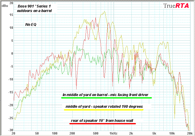

I never liked Bose, not the 901 and even not their best one, the 301. And the measurments explain perfectly why. It's response is very ragged and dispertion is not that even
If you want a broad dispertion, there are way better designs than Bose. They mostly are multiway and use a wide dispertion horn for the tweeter and a woofer with a very flat cone that is as small as possible. An other way of doing it is like the Kii Audio Three BXT or the Dolby Atmos systems, a lot of drivers in all directions and a lot of advanced processing. And that is something for specialists, not something that can be easely done by diy people (altough nothnig is impossible in general, see the story of Dutch & Dutch, the brand that started as a diy guy who tried things).
If you still want a fullrange driver doing it, it will be limited anyway (just basic physics) but a flat cone driver like the Mark Audio 11MS is best at this, and only in a box that has as littel flat front as possible.

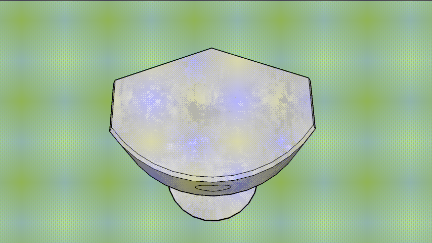

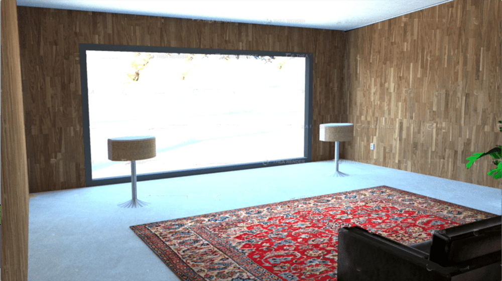

The only product from Bose I was ever interested in is the 901. OK, for a while I glanced at their NC headphones but that has stoped. But I will perhaps one day build myself a pair of modern "901"s - in concrete - just for fun. They are stylish. But for my endgame system, I have other things in mind.
