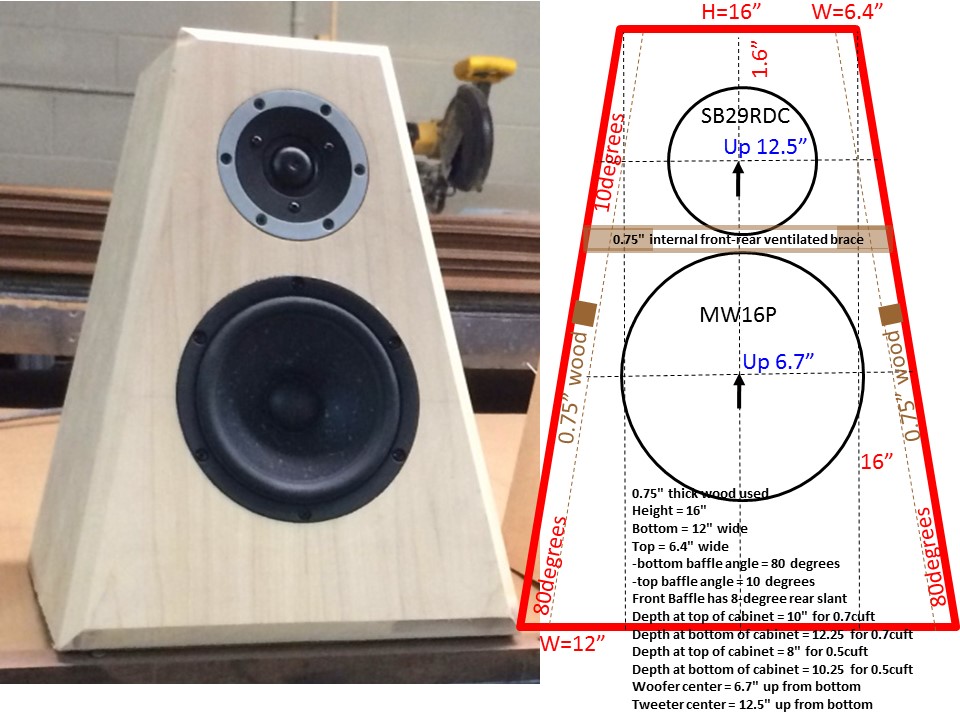

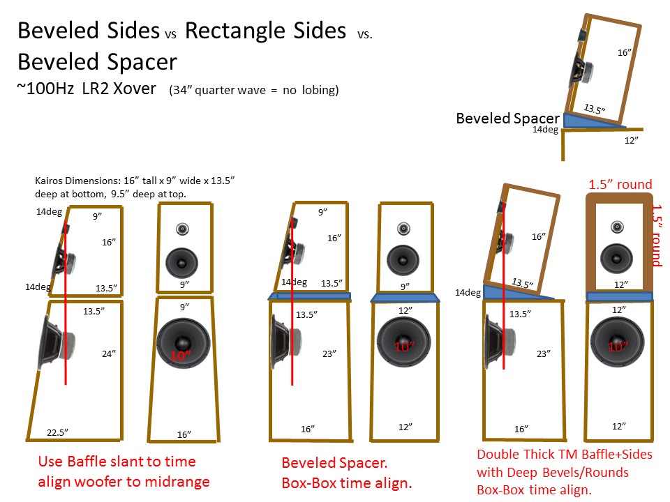

Satori MW16P-8 midbass and SB SB29RDC tweeter

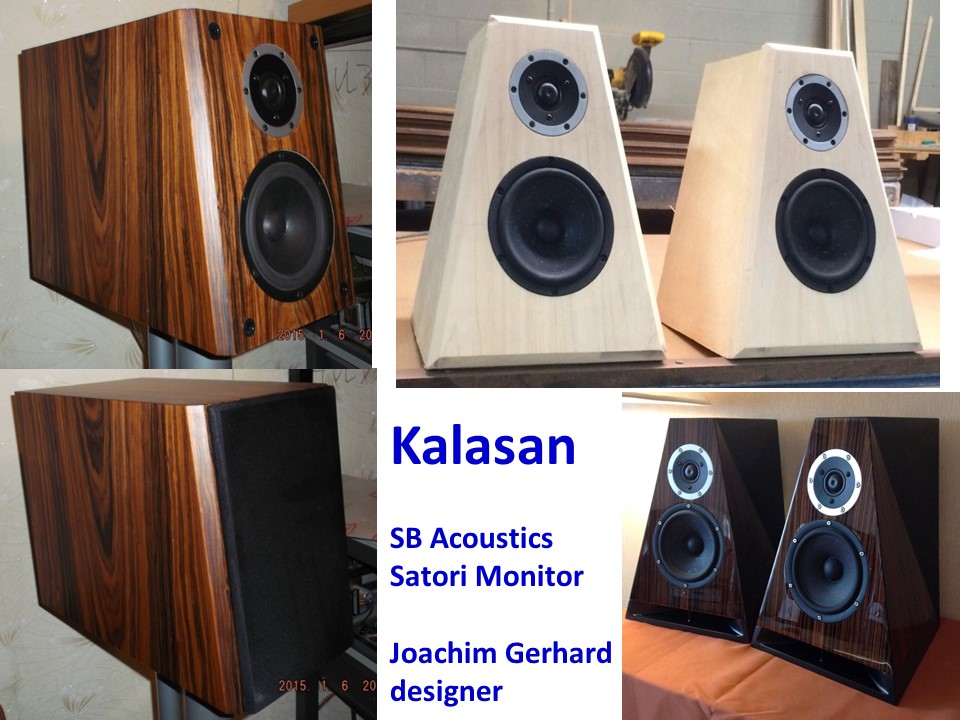

If you want a traditional dome+midbass two way dessign, consider building the diyAudio Kalasan with the $70 lower cost SB29RDC-4 dome tweeter plus passive L-R-C components which can meet ~ $275/speaker budget. Two cabinets discussed: slanted bafflle tilted - 8 degrees; pyramid. You can also build flat baffle cabinet, and build a 8-degree tilt-ramp to put under the front edge... flexible slant!
World Famous Designer Joachim Gerhard developed the Kalasan SB Satori monitor in a well documented diyAudio thread. Pyramid cabinet for diffraction control. MW16P-8 midbass + TW29R-4 tweeter.... you can swap the lower cost SB29RDC tweeter with little sonic difference. There is also a tilted - 8 degrees slanted baffle cabinet similar to Jeff Bagby's Satori Kairos(baffle tilted 14 degrees).
Joachim Gerhard final Satori Kalasan crossover 5.0 circuits from the Kalasan diyAudio thread. # 700
SB Acoustics Satori Monitor
measurements post# 699
crossover circuits post# 700
photos post# 801 762 746

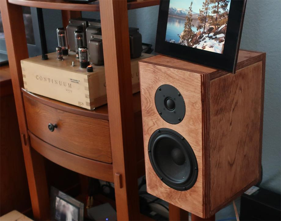

One benefit of building our (CSS) kits is that we give you a 30 day money-back guarantee (minus shipping) if you decide you don't like the kit. No other company offering kits does this as far as I know. So if you build the P215 and aren't satisfied, you can still return it even if the cabinets and crossovers have been assembled. However, we have yet to have anyone return one of our speakers.
I built the SR71. I was thinking they might end up being an upgrade for my garage speakers but they give our main speakers a run.
I may try the 20 ohm resistor across the tweeter as they are a little bright. I also over stuffed them and had to take some out.
