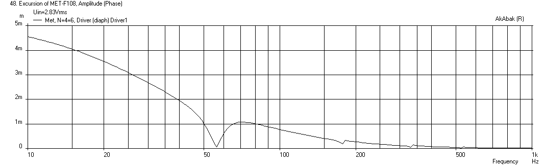

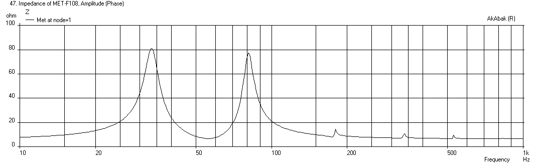

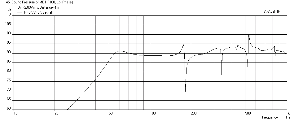

For the FF165WK in a Met prescribed as:
L = 55"
SO = 5"^2
SL = 90"^2
zdriver = 30"
zport = 53.25" [actually exits out the bottom]
rport = 1.5" [3" dia.]
Lport = 2.5"
I get a 55 Hz impedance dip too with Akabak. I am assuming the port is located 55 in at the base and not 53.5 in.

Yes, the resonant freq should not be that far off from the MJK simulation. I have damping in the top above driver but shouldn't change freq that much. It might have to do with volume of speaker. I have chosen some values for depth vs width based on the CSA provided but depending on how deep or shallow a speaker is for a given CSA the volume will be different. Maybe make it square cross section (depth and width the same) to maximize volume? In MJK and HR I wonder if CSA is round square or rectangular? Because my model uses actual width and depth of top and bottom.

Sound is round', so CSA = net circular area regardless of shape, driver encroachment, ergo net Vb should be identical in both MathCad & HR's theoretically ~infinite limits. If it's not in AkAbak, then you're using the wrong dimensions. IOW, actual build dims should ideally take all this into account.
Anyway, it's obvious that MJK has a real world acoustical resistance factor included as shown by the damped harmonics, but what stymies me is they still line up well in HR, so can't think of a reason why its fundamental is so far off.

You are right, CSA is independent of shape, I was mistaken. My Akabak script takes the actual width and depth and converts it to CSA for use in the actual acoustic element. I see that David McBean and Bjorno both get something higher in the fundamental freq compared to the MJK WS.
