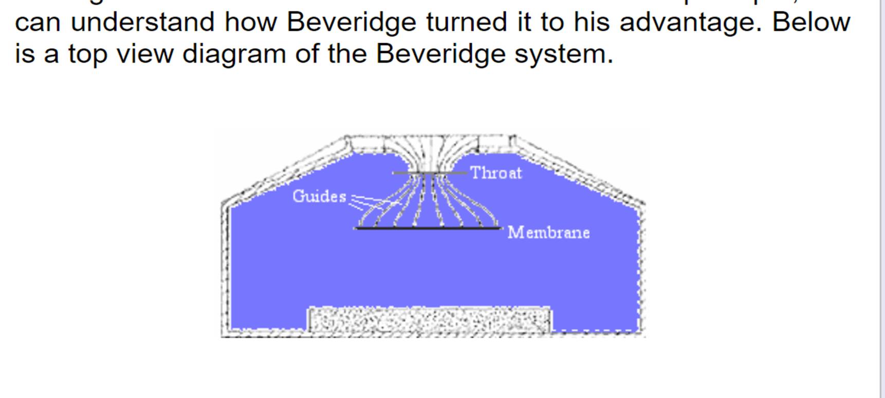

I think a Beveridge type lens in front will help
That's not easy to build, that will become a real PITA with the asymmetrical front slots. And it will not help much because it's not a magnetostat like in the link, it's an AMT, the air between the folds would work like a compression chamber but with a way too high volume, working then as an unwanted lowpass.
Aside from that, the sound running difference isn't reduced, that causes interferences at the horn throat, leading to a jagged response.
