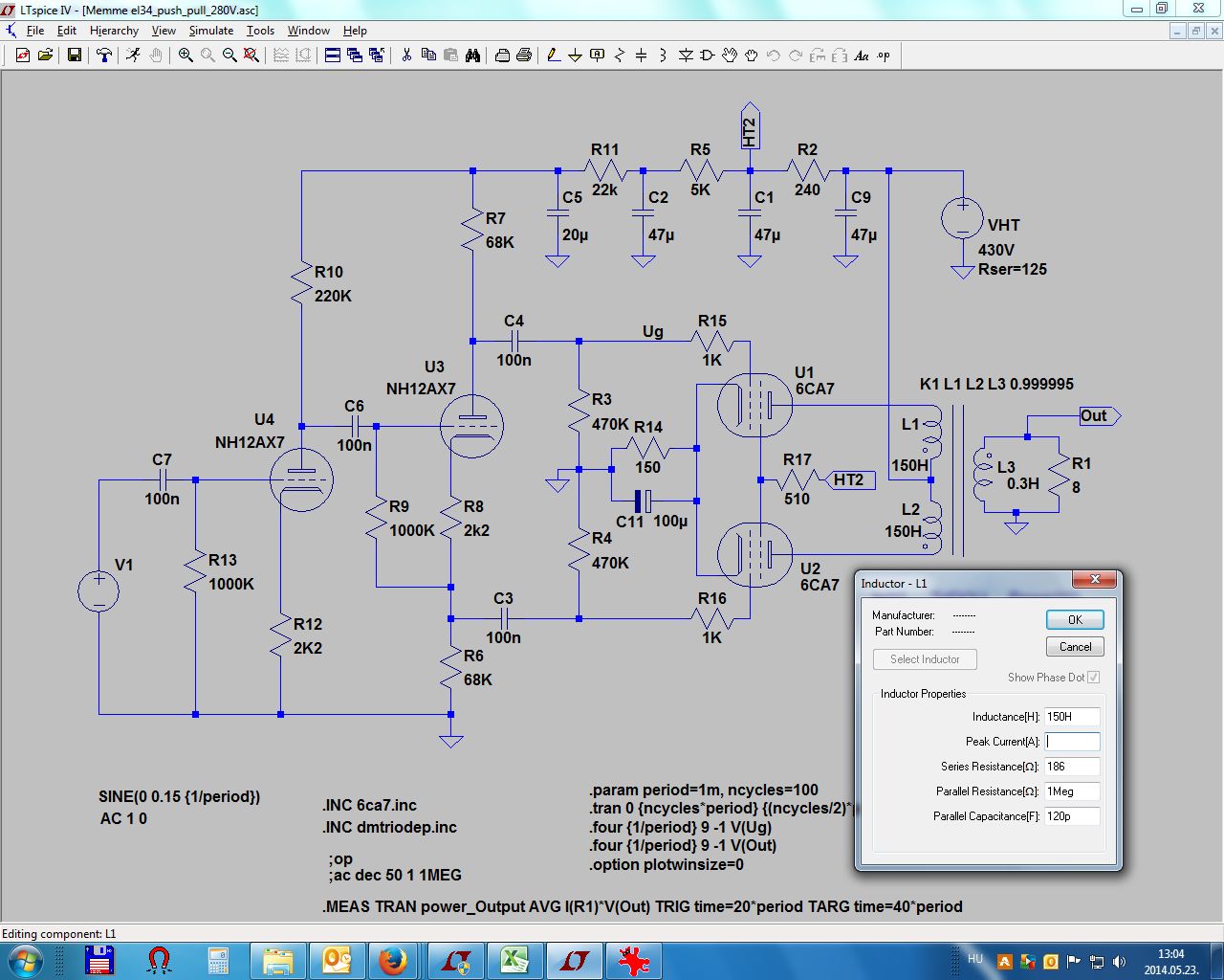

I use the folowing sims for my single end and push & pull sims
http://forum.zelfbouwaudio.nl/download/file.php?id=65461
including series R and parallel C help get more realistic as well as the right K less than 1.0 to include leakage L - can then see more of the (high) frequency response
if you include the parasitics in the L def in LTspice you should check the box for them to be displayed on the schematic so people can see what your using

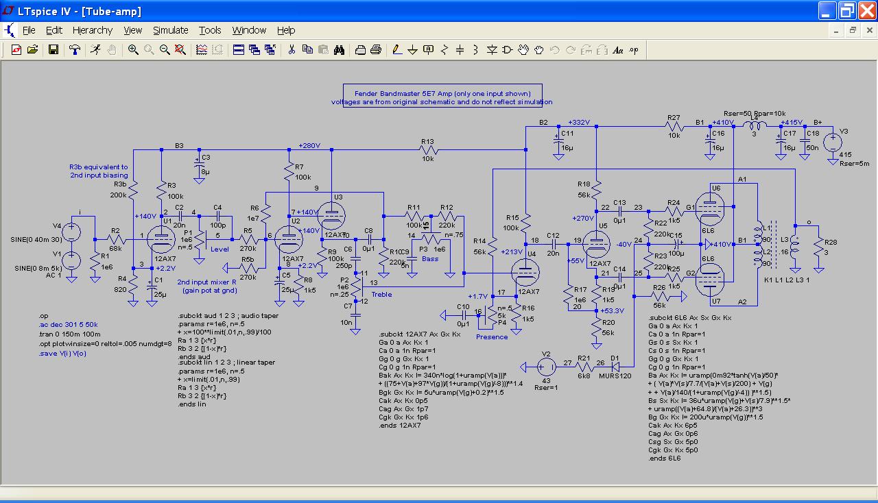

I also found this
The inductance values for the Bassman are way too large

adding explicit Rseries, Cparallel works but LTspice claims the solver works better with the internal device spec'd parasitics

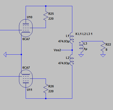

What would be more realistic jazbo?

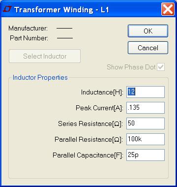

For the Marshall JTM45 (based on the Bassman), Hammond offers this replacement OPT. At 240V and 50Hz, they spec the input inductance at 136H (open circuit on secondary). I would presume that is across the full primary.
I'm curious why they rate the inductance at such a high voltage and low frequency? I'm guessing the rating at such a low frequency is important for low frequency drive considerations. Does the inductance increase with voltage? If so, why?

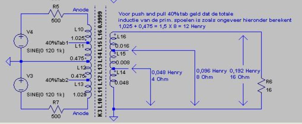

how to calculate the screen grid tap inductance (40%)?
40% is 0.4
Inductance goes with Square of turns.
So 0.4*0.4 is 0.16 of inductance.
The G2-P part of the winding is obviously 0.84 of inductance.
Also
60% is 0.6, so 0.6*0.6=0.36
Then, deff (*)
L1 = 0.16 L, L2 = 0.36 L
Then
L = L1 + L2 + 2 M
M = k √(L1 L2)
For k=1 (this was already assumed)
M = √(L1 L2)
Et voilà
L = 0.16 L + 0.36 L + 2 L √(0.16 0.36 )
Hint: Assume (*) as an approximation and make
k = √(1 - Lleak / L)

Thanks so much for that.... but still there is a confusion on it. ...I think the picture can be more clear. My question is:
L10 = 1.025, L11 = 0.475 and L15 = 0.008 is how to calculate it?
Although I use TINA rather than LT Spice, I have always found that first you put in an ideal transformer, with the correct ratio.
Then you add an inductor of the real primary inductance across the primary of the ideal transformer. If you have measured the leakage inductance (measured at the primary with the secondary short-circuited) then you add two series inductors (assuming a P-P output in each half of the primary windings. You can of course improve the model by adding the values for the winding resistances and stray capacitances.
Doing things this way, starting with a perfect transformer model, you can see if the basic design is OK, and how much it degrades as the model is made more like the real thing.
