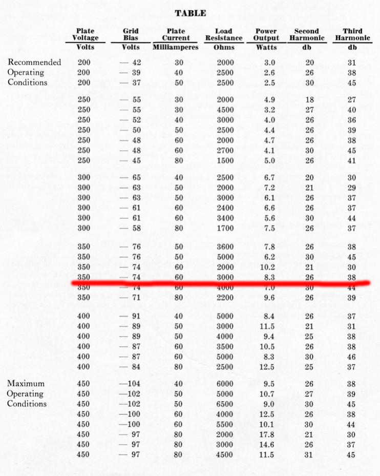

If these are correct, then I'm confused about what the plate voltage rating on a tube datasheet means. As per my original post, the WE datasheet recommends the following combination for a 60mA idle current into a 3K load (attached):
350V plate, 60mA, -74V grid into 3K for about 8w output
Does it mean 350 volts anode-to-cathode (as opposed to anode-to-ground)?
If so, then the 351.7Vak combo listed above is pretty close to the op point line underlined in red in the attached datasheet image.
On these sheets, yes. On the test bench, a 0-100V variable bias supply is much more convenient than a big hot variable cathode resistor. "Most" tube data is given this way.

Note that WE (who was supporting talking-movie houses who disliked failures) gives 450V with 97V bias, total 547V, as an allowed condition. While the 80mA is high for the OT you have, it will NOT burn-up, not even suck at 133% rated current. May shave 3 semi-tones of deepest bass at a given exact THD. You could run the amp this way for many days, and certainly long enough to take measurements and ponder alternatives.
BUT---
If we collect all the WE published data for 300B at 3K load, there is a bump.
From theory and observation, we know a tube stage optimized for one supply voltage will work very well over a wide range of supplies without value changes. As the B+ drops to half, we might increase Rk 20%-40%, but the trend is smooth.
The WE data for 400V(pk) is different from the rest. Ip is shown lower for 400V than for 350V. The implied Rk is way larger, and the harmonic figures are 5+dB worse. I think the tech mis-guessed the optimum.
In the attached image, the pink line is OP's original pick; the odd 400V is the next line down.
I believe the optimum Rk for a 3K loading can be 1.22K over the range 350V-450Vpk (424V-547V of B+). At 400Vpk this suggests 70mA with 85V bias.

Your sim sheet in Post #19 shows 300 V on the anode and 50 V on the cathode of the 300B. That's Vak = 300-50=250 V.
350 V plate, -74 V grid should tip you off that the cathode is at ground. That gives Vak = 350 V and Vgk = -74 V. You can achieve the same results by lifting the cathode and plate by 74 V and grounding the grid. Note that the data sheet specifies two limits for the 300B depending on the biasing scheme used (cathode vs fixed bias).

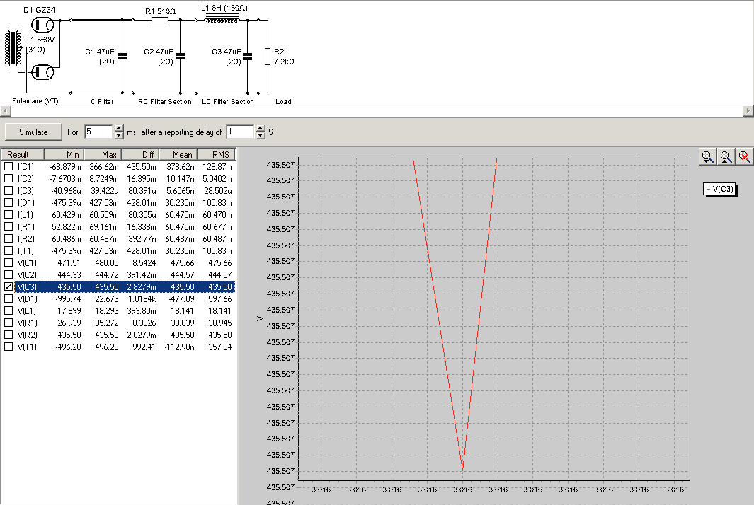

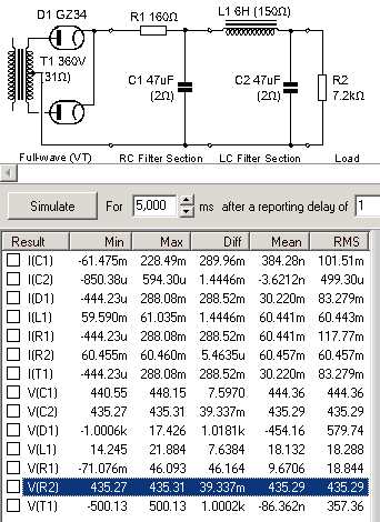

OK, I can't stop simming because it's too fascinating. Curious about power supply for the 350Vak slot discussed above, which needs a 435V B+ supply. Going with PRR's figure for R(pk eff) of 5.8K (post #27), and adding 1.25K for the cathode resistor and 140R for the OPT primary's DCR, we get an effective load of 7.19K for the B+.
Using my existing PT, choke, and GZ34 rectifier in PSUD2, rounding to a 7.2K load resistor, the closest result comes with the 360V winding and a 157R dropping resistor before the pi filter (attached).
The voltages and current are as predicted in the LTSpice model, which is really cool (attached).
However, Diff is now 39.4 mA, which I gather from PRR's discussion in post #9 is the ripple measurement. His example with 416V supply in post #9 showed ~8mA Diff. If 39.4 mA Diff will be noisy, then maybe I should aim for lower operating points.

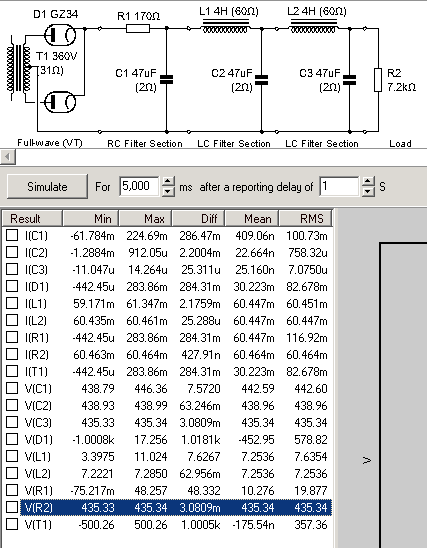

Playing around again to keep the PT but try different chokes, I created a double pi filter with two Hammond 159S (4H, 225mA, 65R) and increased the dropping resistor to 170R, resulting in the required voltage and current on R2 but about 3mA Diff -- MUCH lower (attached).
I'll play around with this some more and will then turn to Morgan (promise) to see what he has to say about it.

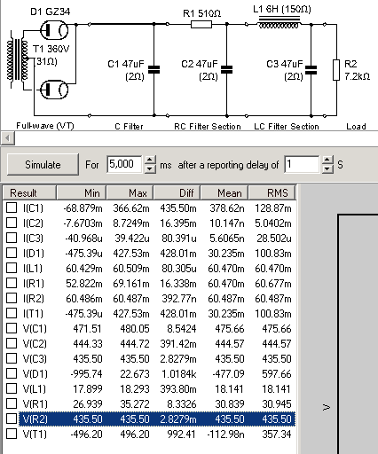

Duh, forgot filter cap before dropping resistor. With that added in and values adjusted to work with my existing equipment, Diff looks even better at below 3mA, for the 350Vak operating slot.
> Diff is now 39.4 mA
PSUD is weak on Kirchoff's Law.
I prefer to look at V. V(C(last)) looks like 37mV down to 3mV. Estimating peak plate swing as 200V, and about 2/3rd of B+ buzz dropped across OT, max audio is 60,000 times bigger than hum or 95dB down from max output. Taking 95dB SPL/Watt speaker effectiveness, and say 6 Watts or 103dB SPL max, buzz is at 8dB SPL which is very low. Lower to the ear because of poor ear sensitivity at 120Hz. Because there are two stages filtering after the first cap, we expect higher harmonics to be very low. (Is the not-shown wave-form sine-like or jagged/spikey?)

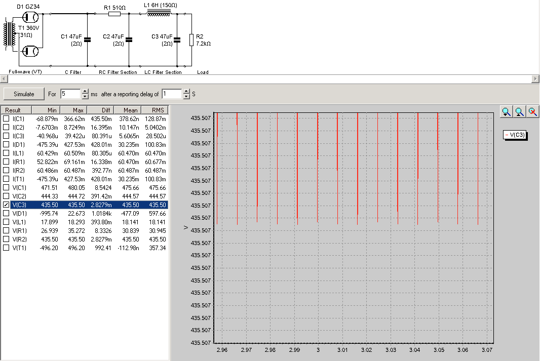

Attached is a graph showing a closeup of the wave at C3 (the last capacitor), which looks spiky more than sine-like to me. Edit: Added an even closer-up screenshot that reveals a pointy waveform.
My speakers are 91.5db efficient.
Thanks for going through your explanation of calculating hum. I'm not sure I completely follow, but I'm reading Morgan Jones, which is easier to grasp now, and will be getting to the PSRR section soon.
