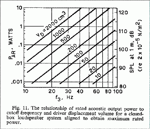

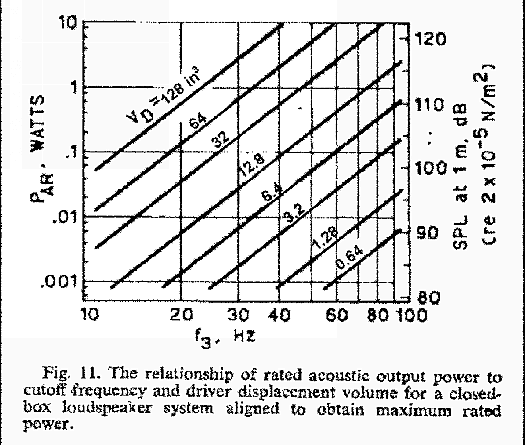

O course, another thing you can do is to use the displacement chart below. For closed boxes, just calculate your cone area, multiply by your plus -r minus excursion, and see what your SPL requires.
So you would need 32 cubic inches of air moved, (Sd times plus or minus excursion), to produce 105 dB at 30 Hz.
For vented boxes, where the Fb is somewhere near the Fb, you would require only about one fourth as much air movement. So instead of 32 cubic incheds of air moved, if your Fb is anywhere near 30 Hz, then you would require only 8 cubic inches of air being moved.
See how much more output vented boxes give? That is why, even though they give somewhat more distortion, the vented box should be your first choice for bass output, (unless you are one of those people who really don't like the sound of them).
