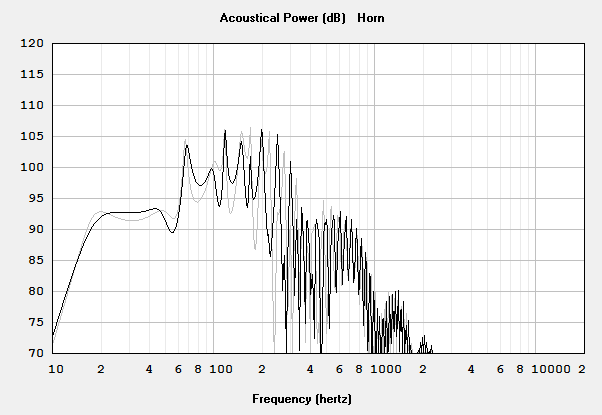

Then 60 hz it is. Or 70 hz with minor damping. Was thinking of a sub that is about 250 cm tall and a footprint of ~60 cm wide and 50 cm deep depending on the modeling. That's about 650 liters.
OK, HR sim attached. You'll have to use Brian's folding designer to see how close you can get to your dims.
edit: Added a DTS sim that extends the HF a little bit by ~filling in a basic TH's 3rd harmonic dip by offsetting the driver's location. Overlay: TH/dark, DTS/light trace
The light trace is acceptable. Room acoustics will change things regardless so I need to do some eq anyway.

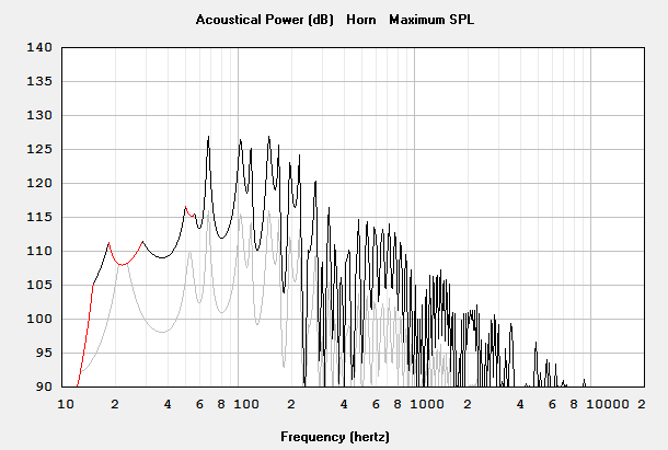

Could you plot max spl at xmax for me please? Both graphs would be nice.

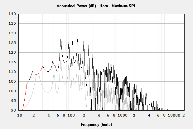

As you can see you'll need some significant room/corner gain to boost the 1st two octaves (~16-64 Hz), i.e. basically its entire gain BW.

Ok so it seems that at low spl there is a 3.5 dB dip around 55 hz and at max spl a 5 dB peak according to the dark graph. The light one (adjusteds driver position) shows in my opinion a really undesired response at max spl.
110 dB at 18 hz is acceptable for me. A second sub makes it only better with the right positioning. I'll stick with the first model and play around with room positioning and eq.
