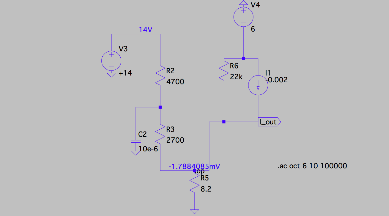

I have created and attached a simple Spice simulation from this part of the actual circuit in a Marantz CD94 with a TDA1541 to try and develop a little insight. I'm just learning Spice but I think this has captured at least some of the necessary behaviour.
R2 and R3 come down from the +14V rail into the current source at I_out to provide the 2mA current that the DAC requires and to keep I_out at around 0V. With the op amp in circuit it's sitting at about -0.4mV.
I am modelling the DAC O/P as current source I1 in parallel with R6. 22k was arrived at by comparing measurements with the simulation. I removed the op amp and attached 3 different resistors to ground then measured the voltage across them:

This simulation is not far from that but there is still room for improvement. For example, open circuit produced -400mV whereas this sim gives -2.1V. Of course, the + voltage rail may not be at exactly +14V (didn't measure it, this value is from the schematic) and the DAC might be pulling a little more or less than 2mA.
In the end, trying to get a better model than I1, R6 & V4 is what I am aiming for.
Anyway, it's a start. Interested in your thoughts.

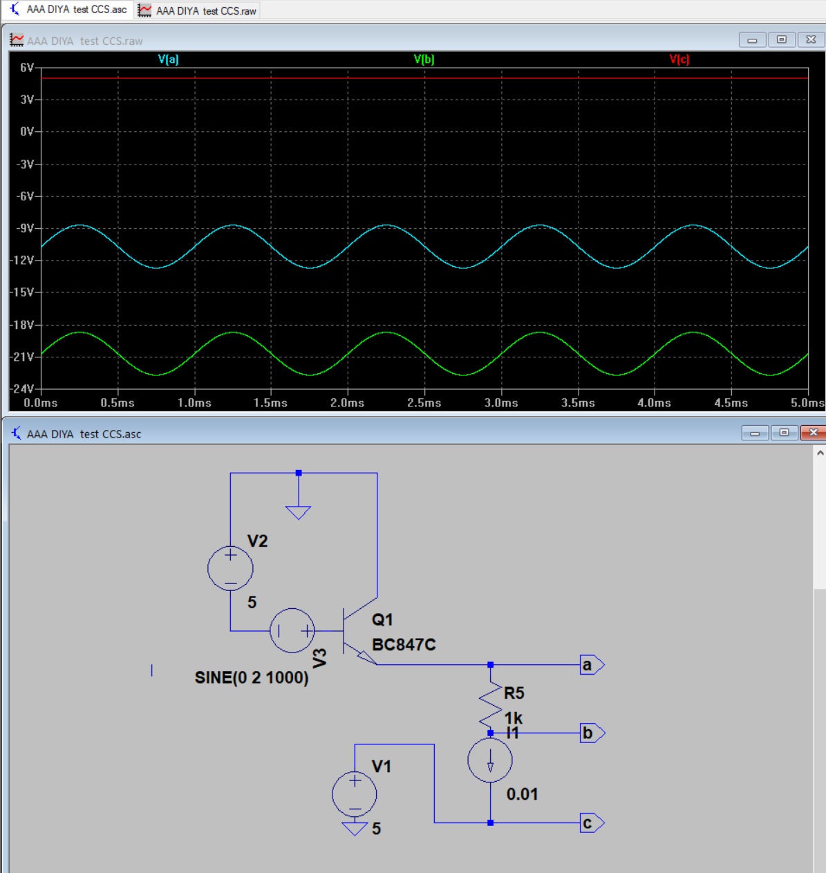

@MarcelvdG if you can get the Spice file working have a look and see what happens when you change the termination of the CCS. Not sure if this is what should happen in a real case or is a vagary of Spice.
I'm sure it hasn't changed, an ideal current source is an ideal current source and conducts the specified current no matter what.
We are talking about CCS termination voltages. Ref pic below

I haven't tried and I have no intention to try it, but if you plot .png pictures of both versions I'll have a look if I can explain the difference.
Did you only reconnect I1 or also R6? Changing the connection of R6 will definitely affect the result.

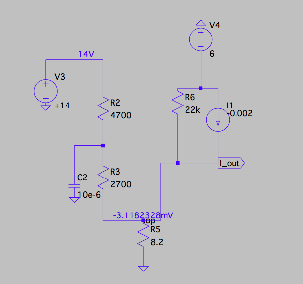

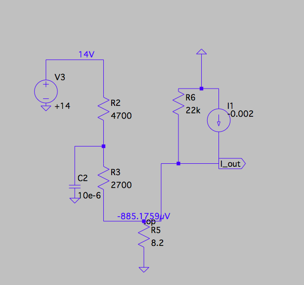

I have attached 2x PNGs with everything the same except where the CCS is connected at the other end. Note the difference in DC offset across the I/V resistor. Please ignore the previous DC offset - I don't believe I re-ran the sim after I changed the value of R6 to 8.2 ohms.

The difference in the way R6 is connected changes the short-circuit current by -6 V/22 kohm = -272.72727272... uA. Multiplying that by the parallel connection of 8.2 ohm, 22 kohm and 2700 ohm + 4700 ohm is the difference in voltage that you see: -2.233056847 mV. When you reconnect I1 without changing R6, you won't see any difference.
As to which is more realistic: if I understand things correctly, that 2 mA is the current a TDA1541 draws when its output is grounded. In the left circuit, I1 and R6 indeed draw 2 mA when shorted to ground, in the right circuit they draw 2.27272727... mA. Hence, the left circuit is more realistic.
Maybe it's a good time to check the +14 V and the 4.7 kohm + 2.7 kohm then, although the +14 V would have to be as low as +12 V to explain the offset you see.
You removed the op-amp, but is there still any unintended DC path anywhere, via the feedback resistor or so?
@MarcelvdG you are correct. I just checked the circuit diagram and there is an error on it! On one channel the feedback resistor is shown returning to the +ve op amp terminal but of course this makes no sense as this is connected to earth in a virtual earth I/V setup. So yes, there is a 1k78 feedback resistor still in circuit. It's not easy to describe how this gets to DC gnd as all its connections through resistors end up at caps except for the +ve input of the following op amp which is at 0.6V DC when everything is in circuit - I haven't measured this point with op amp out of circuit. Looks like I need to get my voltmeter out, and I will try to find a diagram to illustrate.
