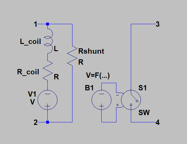

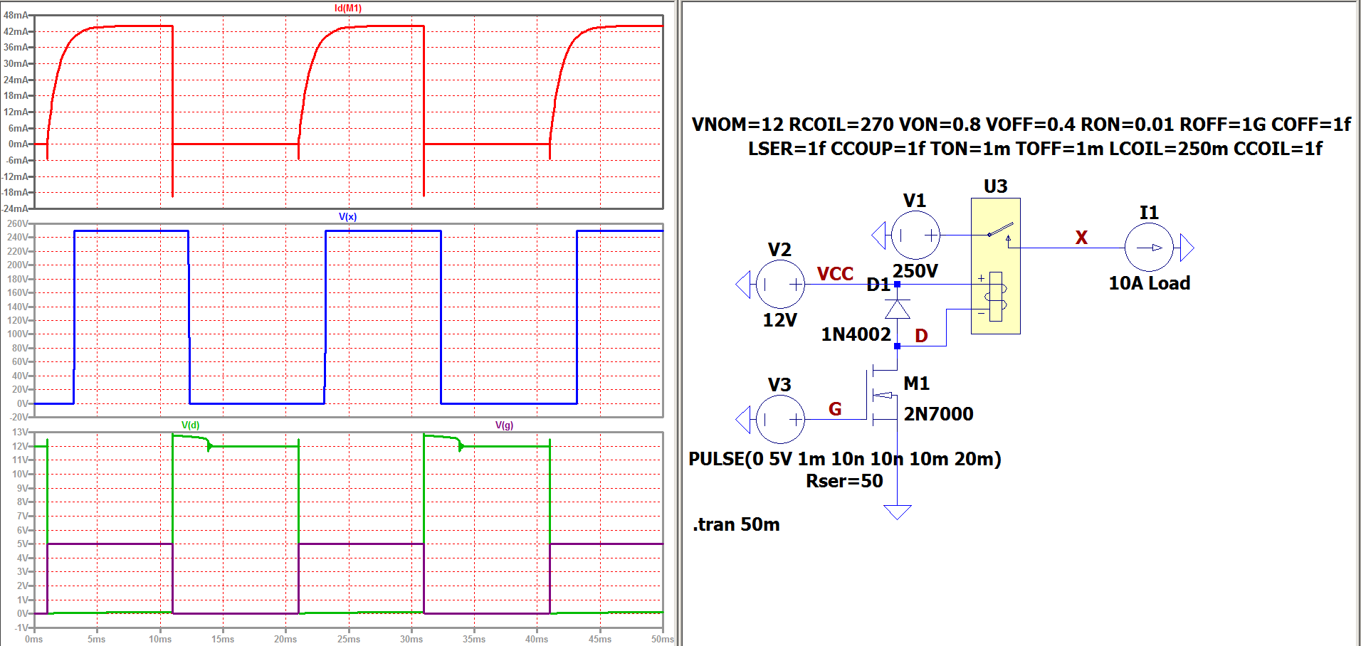

Mayday Member Joined 2004 2021-05-29 10:58 am #1 2021-05-29 10:58 am #1 I wonder if one of you guys would be able to help someone barely a newbie on simulation software with a model (info in title and a screenshot of the symbol attached) Attachments B-plus_realy_LTSpice_model.jpg 22.7 KB · Views: 107 M Mello4 Member Joined 2021 2021-05-30 12:57 am #2 2021-05-30 12:57 am #2 Check out this: Including Relays in PSpice Simulations | PSpice Attachments PSpice App Note_Including Relays in PSpice Simulations.pdf PSpice App Note_Including Relays in PSpice Simulations.pdf 154.7 KB · Views: 162 jackinnj Member Joined 2002 tech-diy.com 2021-05-30 7:34 pm #3 2021-05-30 7:34 pm #3 Here's an example -- you can simulate "bounce" by using a pulse function for V1, Behavioral Voltage B1 etc. Attachments RelayModel.png 8.4 KB · Views: 90 B bordodynov Member Joined 2015 2021-05-31 9:16 am #4 2021-05-31 9:16 am #4 See Models: For LTspice users. Libraries of models, examples, etc Attachments 2021-05-31_10-53-32.png 51.2 KB · Views: 99 Relay12V270Ohm.asc Relay12V270Ohm.asc 1.6 KB · Views: 71 You must log in or register to reply here. Share: Facebook X (Twitter) LinkedIn Reddit Pinterest Tumblr WhatsApp Email Link
