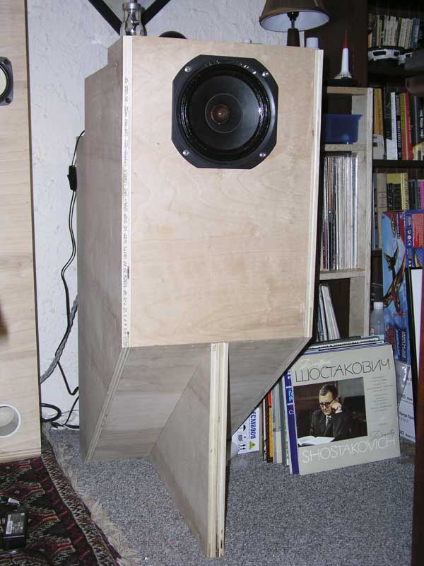

Ok, so, I decided to post an image of my design. I have worked for months and months to get to this point. Horn theory, horn theory, horn theory. From King to JBL to Voight to Paul Klipsch to Gustavas, I have tried to research and learn the entire field. I am by no means fully knowledgable yet but I am getting there. Thinking of going back and getting my Doctorate in acoustics now. (That will go over well with my boss as I am a professor of art and theory here in Washington D.C.). After the last year and 15 sets of speakers, here is the beginning for me.

Audio Nirvana Super 8's
37 Hz BLH (I get around 34 against the wall, 23 in corners)
They will literally shake the entire house with Bach's Fugues.
The response is amazingly flat for a horn. After running these drivers in, they became amazingly musical. After hearing them in these enclosures, I believe they beat out any fostex I have heard. (purely subjective of course) The next itteration will probably be for AERs or Lowthers. The time it takes to develop a speaker! Hopefully I will be showing a viable saleable unit within six months.

Any chance of sharing???

Re: Any chance of sharing???
For now, I am not going to release plans to them. As this is a stepping stone to a commercial product. Sorry As the designs go on though, I will have a public domain design before long. Hang in there. Realistically, to run in these drivers took around 150 - 200 hours. Though they are good to begin with, stick with them, they improve immensly!

Mine didn't open up until 4 months went by. That was around 10 higher-volume hours per week. So, not soon.
