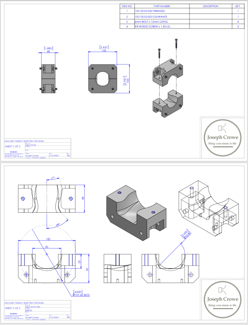

if you want to build an 290 (not S, but the question is generic) for a 1.4in driver (like 4594nd) how would you design the end bit (throat etc)? Is it ok?
A smaller throat does present an opportunity to improve the transition between the compression driver’s own exit angle and the 45 degree horizontal throat angle in the A290.
The Radian 850PB for example has a wide 16 degree exit angle, so the transition should be made as smooth as possible. To this end I do offer throat adapters with very complex internal geometry to reduce the effects of the abrupt physical change in the flare geometry in the throat. To machine the adapter requires a two piece assembly so that I can approach it with my CNC machine’s ball nose cutter.
For DIY I can share the design or solid model, just email me at Joseph_crowe(at symbol)Josephcrowe.com
