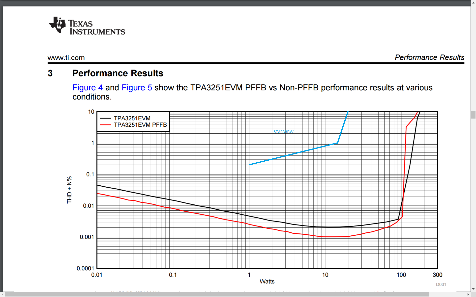

All new Nad amps are Hypex so it seems and they all are more or less immune to speakerload because of feedback. A very small amp can be made filterless maybe, that would be a future for digital input devices. But really, come on, requiring a very good psu to get to this ??? blue line. How bad a dac do we need to attach to TI analog input new series tpa32xx 40-700 watt that also will be less speakerload sensitive with second external feedbackloop ?? Red line is with postfilter feedback added.
