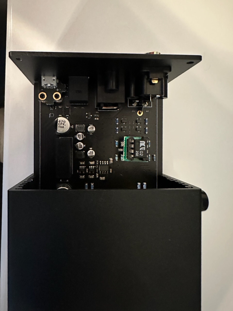

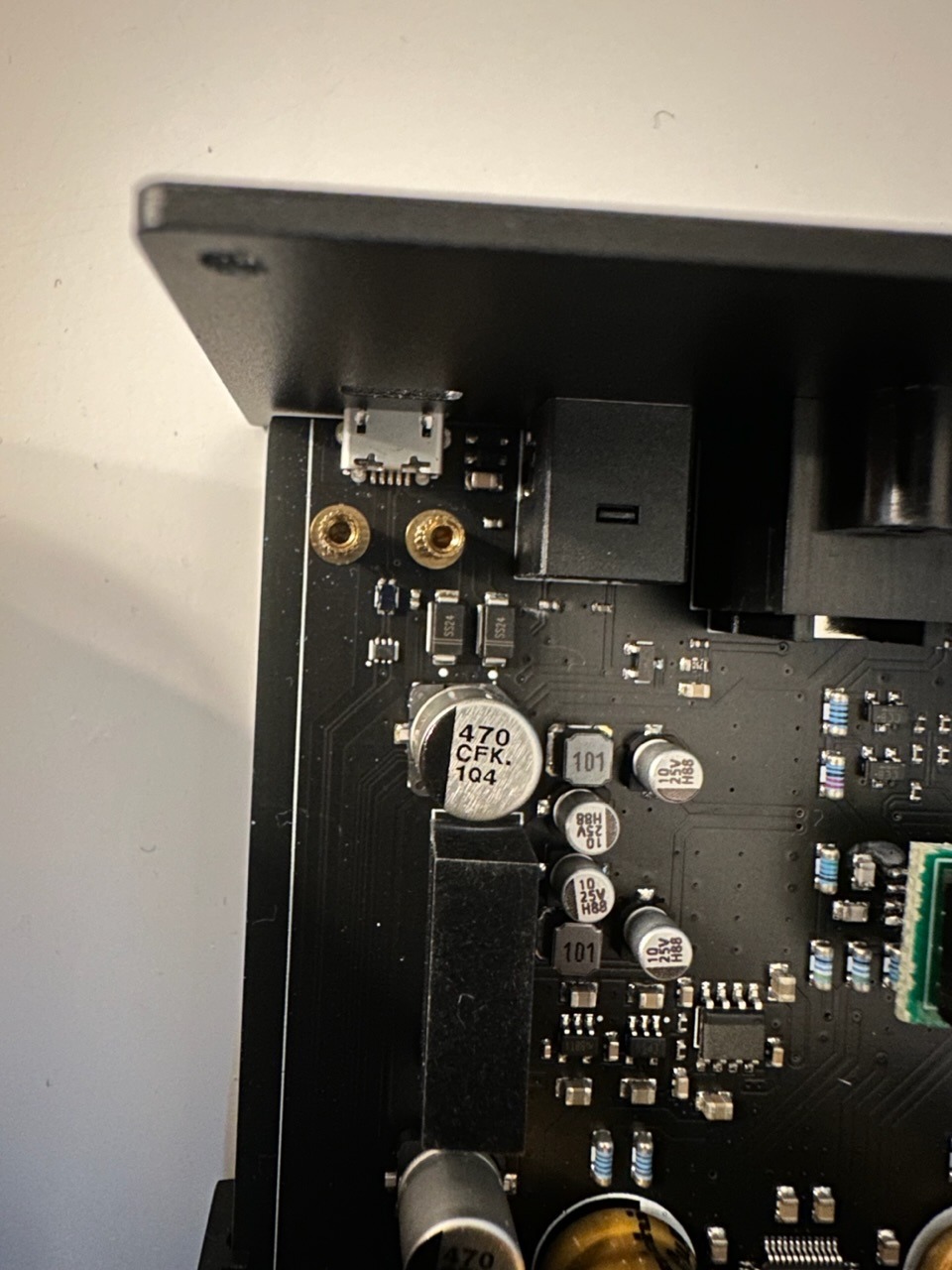

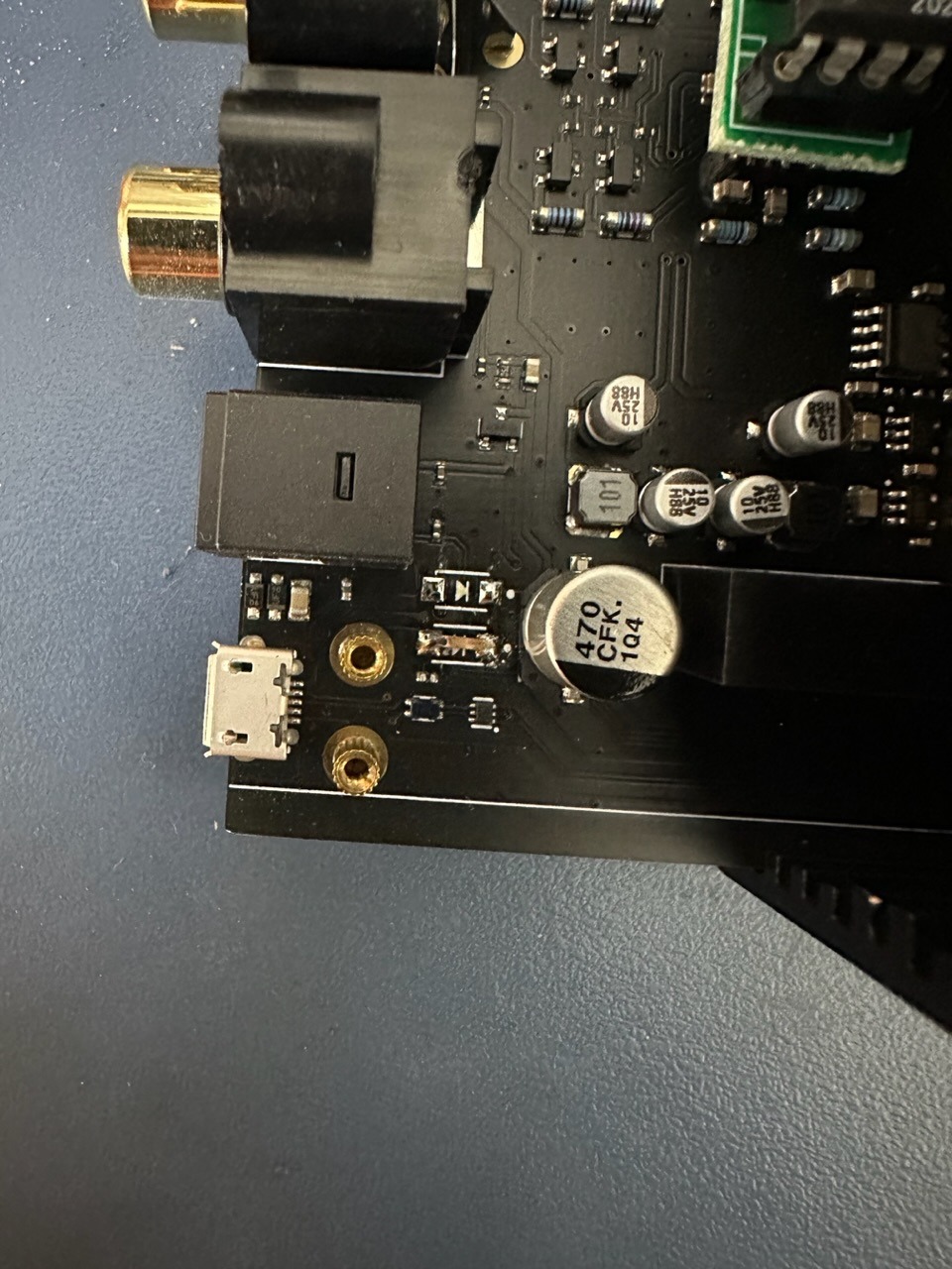

Right one is bus power diode, left one is aux.
This is with both USB connectors in place. Aux one is very easy to remove, only two screws which are also supply contacts from aux port
Hi, I removed the upper micro-USB PCB and also the brass mini standoffs. I then used a new and way better connector for AUX power and soldered the wires to the PCB pads where the brass standoffs used to be (and bridged its diode). Please see post #1. That way the micro-USB for USB signals still works OK and I could connect a linear PSU via good connections.
Both diodes were removed as I wanted the Vref to be 5V instead of 4.7V.

Btw, I forgot I don’t have supply wire in USB cable, which puts this mod down to bypassing aux supply diode in my case. Small difference in character of DAC is there, but I can’t tell why.
A 5.5 x 2.1 mm jack can also be used but the Lemo is nicer I think.
Yes with a wire bridge instead of the diode the Vref will be 5V as it should be. I heard it directly. The 5.6V created by the switcher stays 5.6V regardless of 5V or 4.7V input. It then has 2 diodes in series (making it 5V again 🙂) and then goes to a circuit I haven't figured out yet. Seems a power on circuit of sorts.

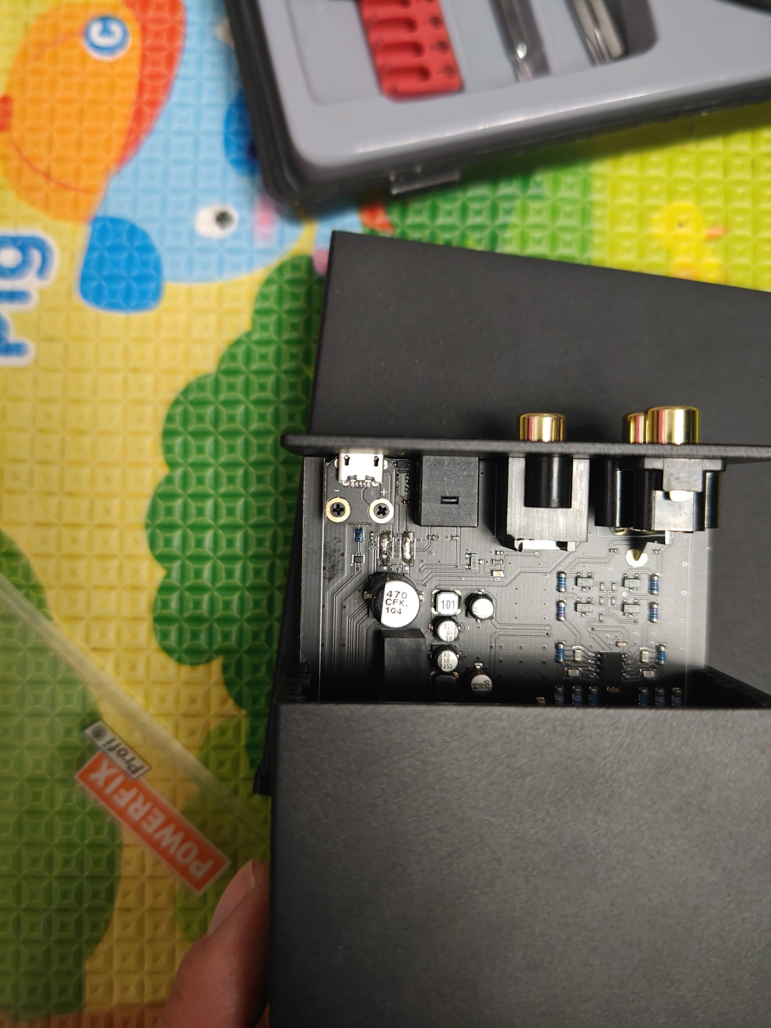

Hi I just tried to modd sanskrit mk 2 by removing the diods , however after removal device is no longer recognized by PC, everything else seems working ok. Any advice what could go wrong? Thanks
