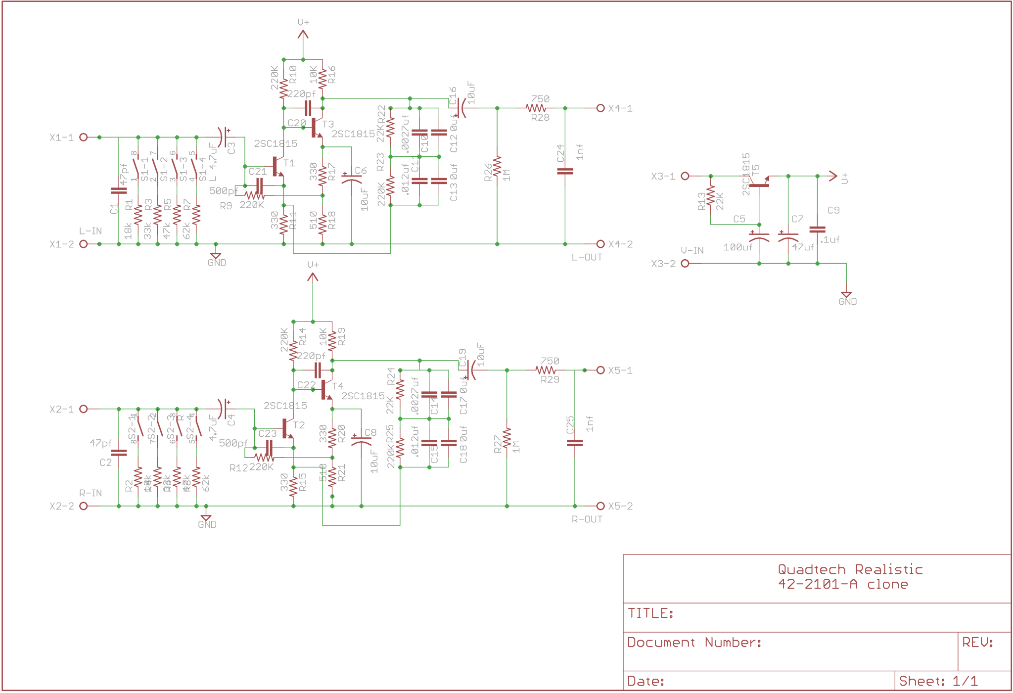

Let's do it from scratch

1)
We consider the last stage first, open the feedback loop and set a load on the collector (circuit output):
V2 = Tr2 => model transistor
RC2 = R9 => 10kOhm
RE2 = R11_15 => ac-shorted
RF = R17_19 => (220k+22k)
RL = Rload => input resistance of our preamplifier 10kOhm
Au2 = Gain
Ra = RC2 || (RF || RL) = 4899Ohm
Now we calculate the resulting voltage gain of the stage:
Au2 = - (h21 * Ra) / (h11 + delta_h * Ra)
Au2 = beta * 4k899Ohm / ((rbe + (rbe/rce - beta*D) * 4k899Ohm)
It is now questionable whether we can use rbe if the dynamic output resistance of the first stage is in parallel to the base-emitter path.
rbe´ = (beta*RE1 + rce) || RC1 || rbe
with
RE1 = R7 = 330Ohm
RC1 = R5 = 220kOhm (percy changed to 100kOhm)
rbe´ = 4k592Ohm
Au2 = 346 * 4899 [V/A] / 4971 [V/A] = 341.4
OLG is now calculated as 50.66dB with typical preamplifier load and also RF as additional load -> the voltage gain of the loaded, simple emitter circuit of the bipolar NPN or PNP transistor.

2)
Now we are missing just under 30dB of the first stage to achieve a really sufficient core amplification of 80dB.
In the next step we allow ourselves to set Ra = rbe' from the 1st step above and now determine rbe' with rbe || RB1, with RB1=R14.
rbe' = 1/( 1/4847Ohm +1/220kOhm) = 4k742Ohm
Next, we allow ourselves to use a simplification for the time being and consider RE1 as short-circuited, which is of course not allowed - but let's see what comes out and decide at the end whether we were allowed to simplify.
S = beta / rbe'
Au1 = S * Ra
= 73.1mS * 4k592Ohm = 335.5 -> (50.51dB)
k = RE1 / (RC1 || rbe)
= 330Ohm / 4k742Ohm = 69.6*10^-3
Au1´ = Au1 / (1 + k*Au1) = 335.5 / 24.4
= 13.78
OLG is now calculated!
22.8dB (+ 50.66dB) = 73.46 dB

2.1)
Let us briefly neglect the load of the first stage and consider it alone. RB1 = R14 = 220kOhm is considerably greater than rbe we will also ignore it.
S = beta / rbe = 71.5mS
k = RE1 / RC1 = 0.0015
Au = (S * RC1) / (1 + k * S * RC1)
with
RC1 = 220 kOhm -> 639.6 -> 56.12dB
RC1 = 100 kOhm -> 609.8 -> 55.70dB
2.2)
Now we load the source with our second stage and the value of rbe.
r_source = ra
ra = ((beta * RE1) + rce) || RC1
ra_a = 144k744Ohm || 220kOhm = 87k304Ohm
ra_b = 144k744Ohm || 100kOhm = 59k141Ohm
a_a = 20*log[rbe / (rbe + ra_a)] = -25.6dB
a_b = 20*log[rbe / (rbe + ra_b)] = -22.4dB
Au1(RC) = 56.12dB - 25.6dB = 30.52dB
alternativ
Au1(RC) = 55.70dB - 22.4dB = 33.30dB
Now you can see the originally assumed gain expressed as just under +3dB.

2.3)
The same procedure with the second stage.
Au = S * RC2 = 714.7 -> 57.08dB
ra = rce || RC2 = 7k527Ohm
Rload = RF || re_preamp = 1/(1/242kOhm +1/10kOhm) = 9k603Ohm
a = 20*log[Rload/ (Rload + ra)] = -5.03dB
Au2(Rload) = 57.08dB - 5.03dB = 52.05dB
If we now add up, we get exactly what we want, namely greater than 80dB gain -> now we could theoretically design the RIAA network without correcting the time constants, if we could still assume an ideal source at the same time.
Finally, the prize question remains: who will find the error and be able to correct it?
2.3.1)
Unfortunately, RC2 is not sufficiently larger than rce and therefore we are not allowed to simplify and work with the approximation.
At this point we have to use S * ra and minus "a" let us get = 49.6dB.
2.1.1)
The same applies here and we end up with (48.1dB - 25.6dB) = 22.5dB
2.4)
OLG with this permitted method is actually 49.6dB + 22.5dB = 72.1dB
A = 3589 / 3590 = 0.99972145
B = 242kOhm / 330Ohm +1 = 734.333
close loop gain is now for very low frequencys 57.32dB; unfortunately, we do not couple back a voltage, but a current at the emitter of the V1 - the emitter as a negative input, that already suggests the next inattention!

hbtaudio / Percy, I added the 1nF at the end , and also put in C03/C05 from the original Realistic
schematic, which can be populated only if needed.

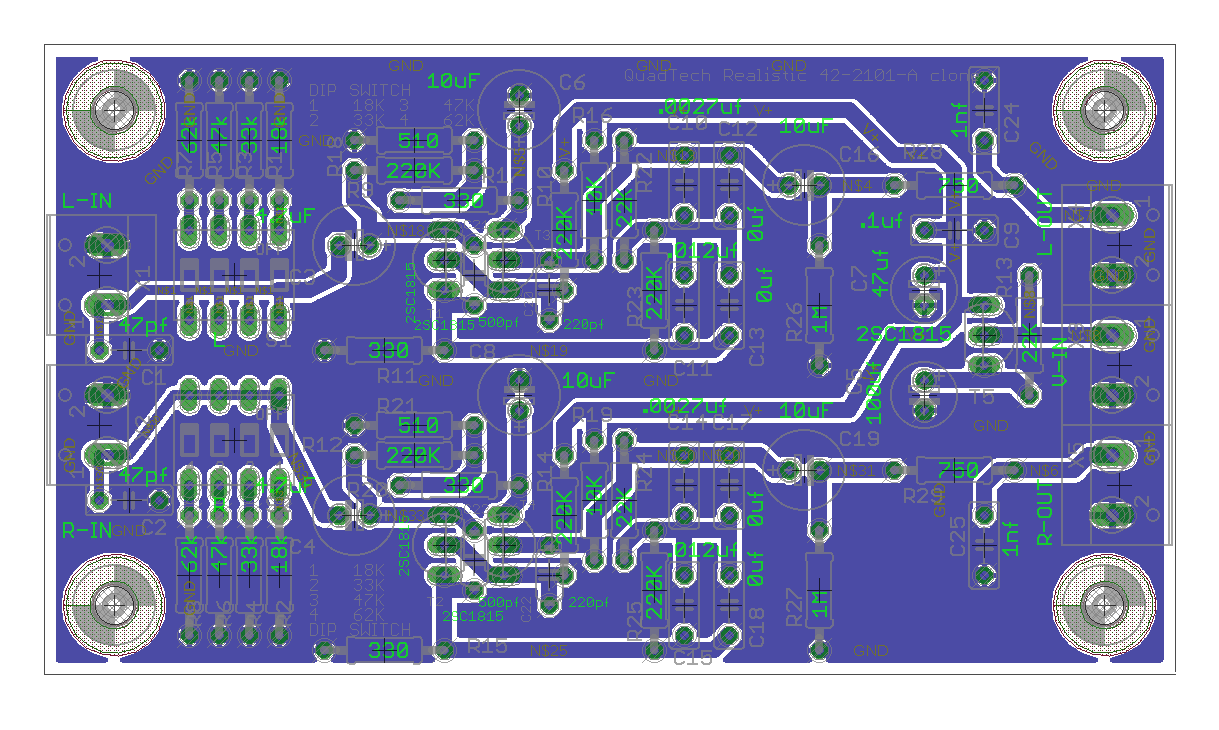

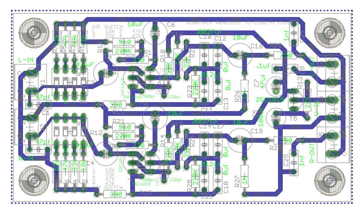

C20, C21, C22, C23 have no place on the PCB, they are counterproductive - also the Input DIP-switch selection!
Do us a favor: please remove my name from the board and the drawing, instead refer to the forum "www.diyaudio.com" - if there are commercial intentions, consider the warranty... etc.pp.
Noted the feedback - thanks - will address next weekend I am free.
Disclaimer to all - the files I posted were made for my own learning, untested, for diy use.
