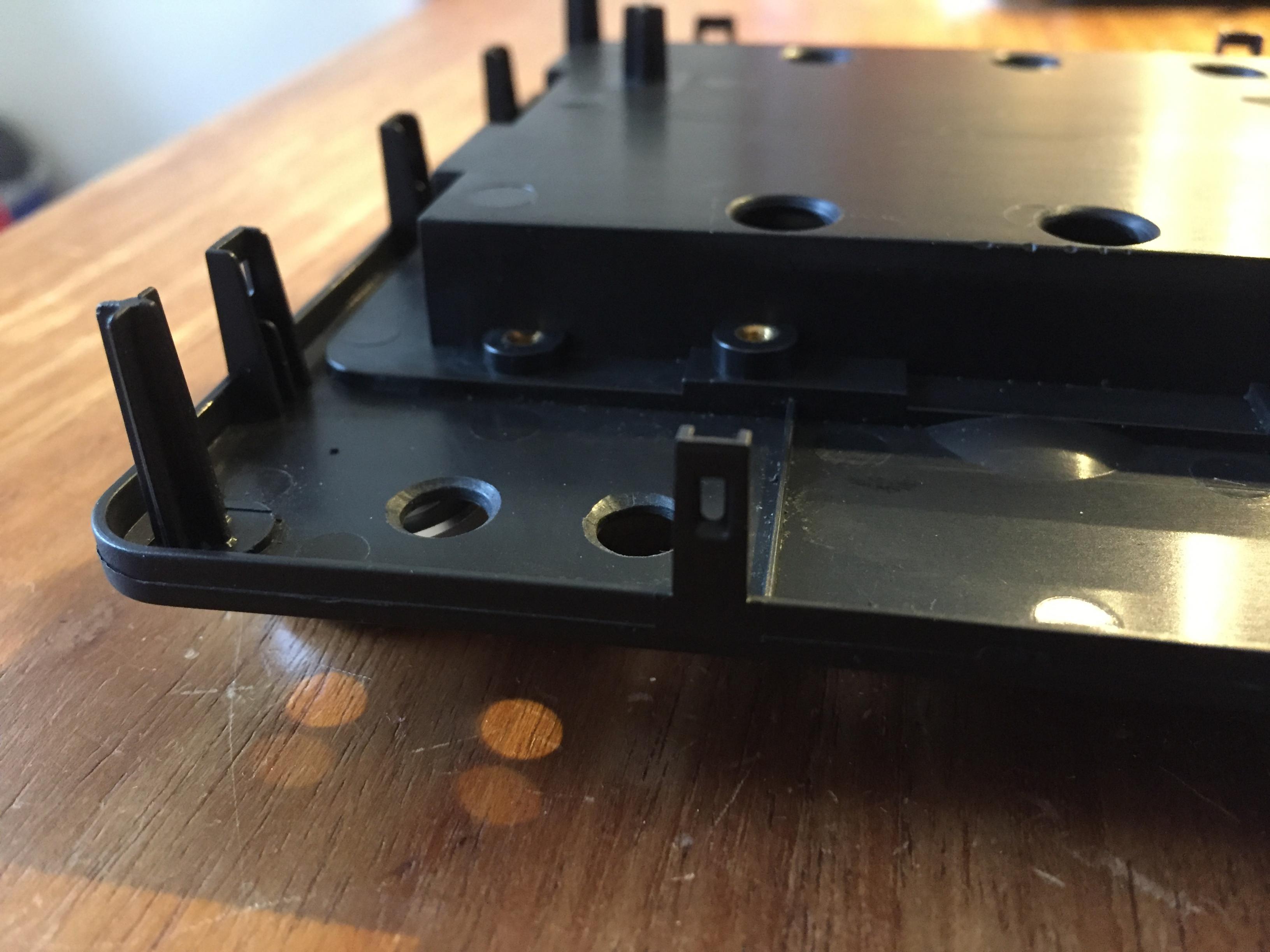

The CPU is upside down and uses its shield to transfer heat to that plate. Best would be to glue a heatsink to the CPU but then the shield must be cut with a dremel. Would be the most effective solution.
I must admit I put it together but i forgot the exact sequence of shield/plate 🙂 Seems right when I think of it.
Your solution also works but then you must drill the holes in the plate slightly larger as they can misalign somewhat. The holes will be in sight which may even be worse than my work although that is hard to beat 😉

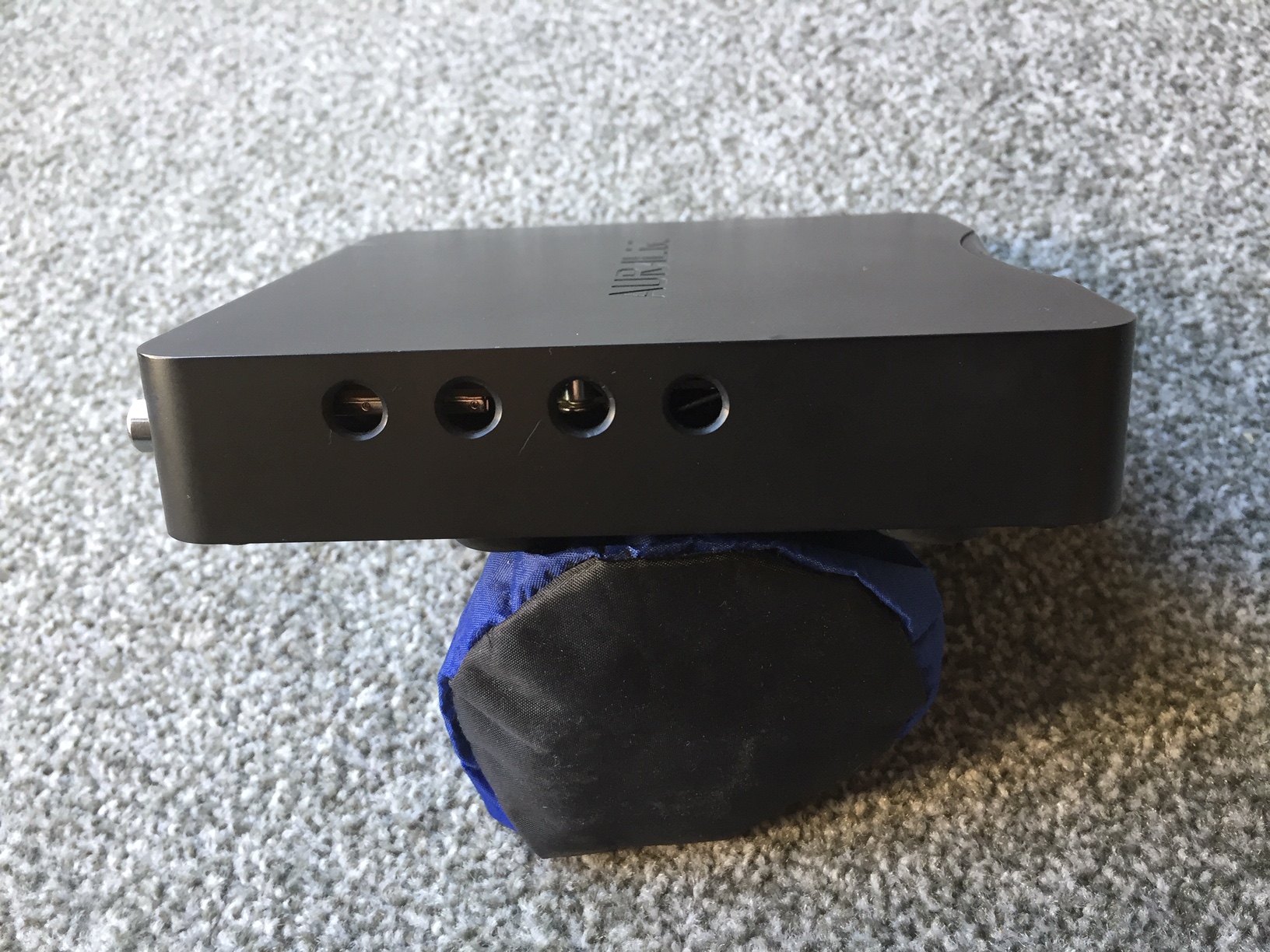

Ok, it took a while but I modified 3 casings and this is the best till now. This was done by a professional CNC guy. The heat difference between a modified casing and the original one is 10 to 15 degrees Celsius easily. Regardless of the shape of the cooling vents I never measure higher than 40 degrees on the upper side of the Mini.

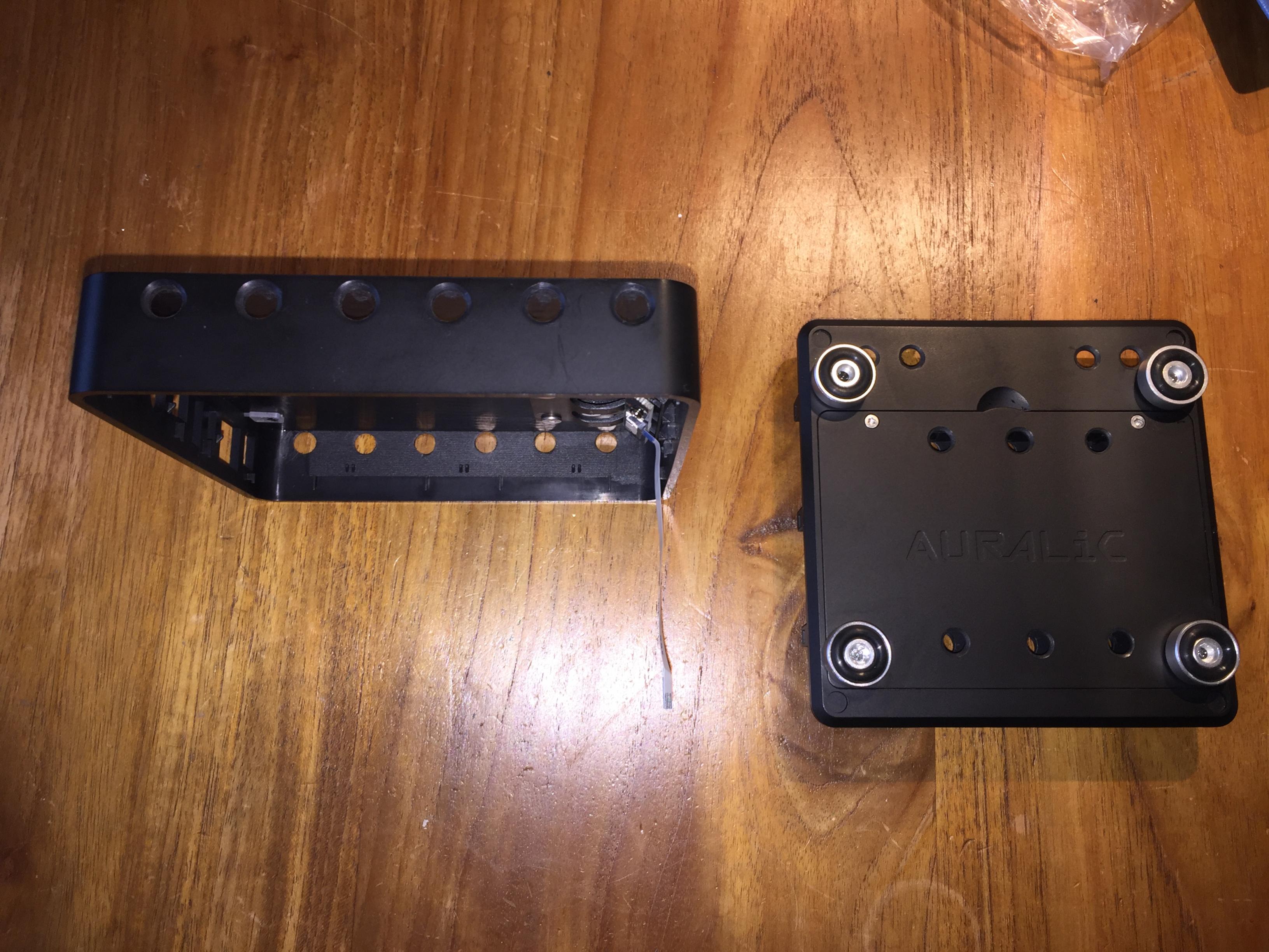

Meant for glueing aluminium heatsinks to ICs etc. In the case or Aries Mini there is a thick plastic upper cover between the top plate that also serves as heatsink. Any new construction should transfer the heat from the heatsink to the outside. With a layer plastic in between this will not be optimal. Surface of the top plate is OK, just add a few holes at the bottom (also through the SSD bracket) and at the sides of the upper cover.
Like this. Please note the elevated rubber feet (for better convection) and the holes near them. That is where wireless electronics are which also heat up.

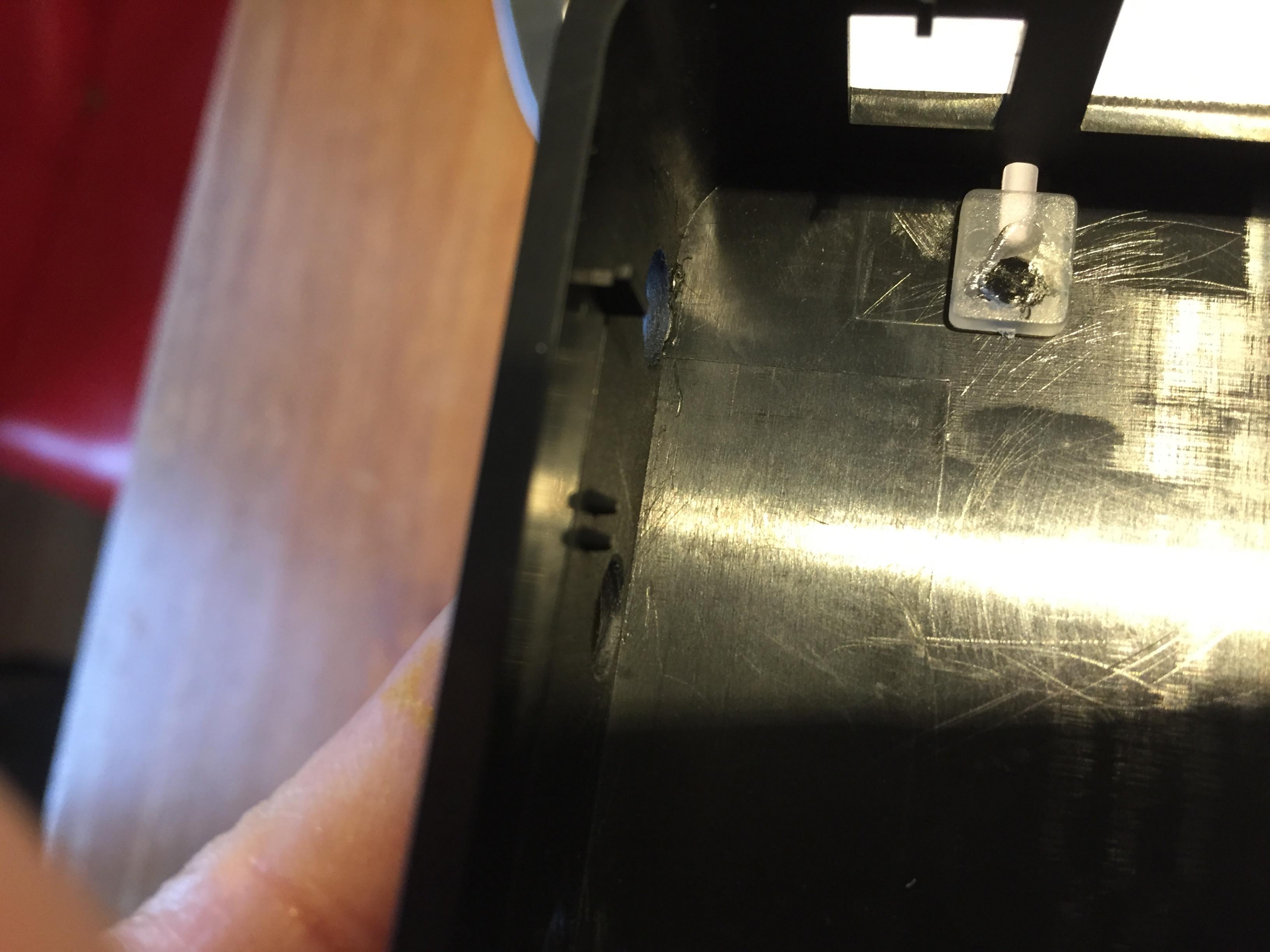

Removing the bottom cover is easy peasy. The hard part is removing the electronics from the upper cover. Please make sure you have a "fresh" Torx screwdriver as the stainless screws are tightened extremely and strip very easy. In fact you may damage them at the first try. It is best to replace them for normal Philips or Pozidriv types made of galvanised steel.

Yes that is possible certainly when you obtain the same RCA connectors. With regards to the heat: try to drill 5 or 6 mm holes where the heat occurs. I studied on this carefully so you can use the spots as determined to have impact, most important are the backside ones. Just take a look at the pictures.
