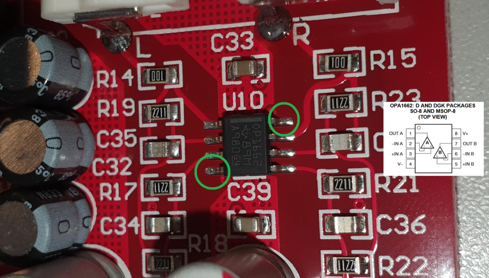

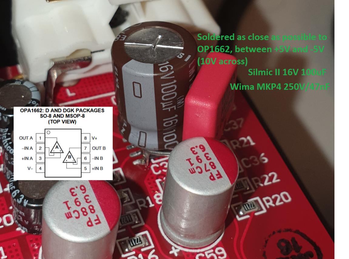

I just did a simple yet extremely efficient mod on my Modi3: For less than 1 euro (I had remaining components from my previous Cambridge Audio 640C / 640A mod).
Components / Cost:
- 1x Elna Silmic II 16V/100uF - 0.6euros on mouser
- 1x Wima 250V/47nF MKP4 - 0.2euros on mouse
Improvements, ranked by importance:
Mids and Highs are more silky, less grainy than before. They retains their details even as low level, which was not the case before (I do not have to push volume anymore to hear all details).
The bass now go deeper, with less fuzz messing the low mids.
Stereo Imaging is more precise.
I am stunned with the results and wonder why this is not by default in every device.. From my experience all HiFi equipments benefit from Capacitors mod.
Below are some pictures of the mod:

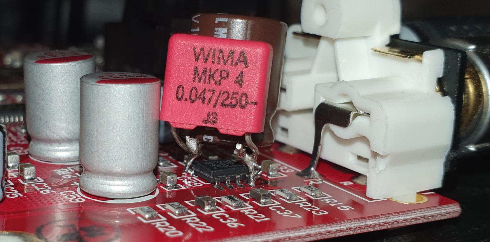

Looks cool. So if I understand you correctly, you soldered the wima cap to the elna silmic using the wima long leads. You then solder the elna silmic leads. To the IC . But how do you solder the leads .to the IC. Doesn't the cap get in the way of your iron?

Indeed, I tried to solder the leads as close as possible to the IC, and soldered from the side. Below pictures shows the side view.
Now that's a bit quick and dirty. To do it properly, I d even shorten the Wima leads to the IC, and put the Elna Silmic II with longer leads on top of the Wima, and cut the extra unnecessary lead.
I noticed that there was no output caps on this Modi3, and other ICs have much smaller pin spacing. So not much to do appart from beefing the PSU at the moment.
I confirm that there is a noticeable improvement, as I tried removing those (easy for not risk-free if done too many times) and listen again.

Yes its the audio output op amp.
Picture s a bit misleading. Both leads are directly soldered to the chip pins. This is a picture of the first rework. Since, i shortened the leads and cut unecessary tails. With a 250kS/s scope i did not see any issue on the Vcc+/-. It was actually cleaner with the mod.

I may have missed the obvious but why didn't you solder those caps to the PCB bottom, directly at the IC pins? Safer and cleaner.
Jan
This way I am able to re-assemble the Modi3 and close the box, which would not be possible with a cap below the PCB since it's just 3mm clearance between PCB and bottom of the case.
Also, this makes for slightly shorter cap leads to the IC.
If you really feel like adding the output capacitors, you can desolder the RCA center pins and bend it over the board. Then use caps as bridges between the board and the bent pins.
I personally plan to use opa1612 instead so I probably will do fine without output caps.
