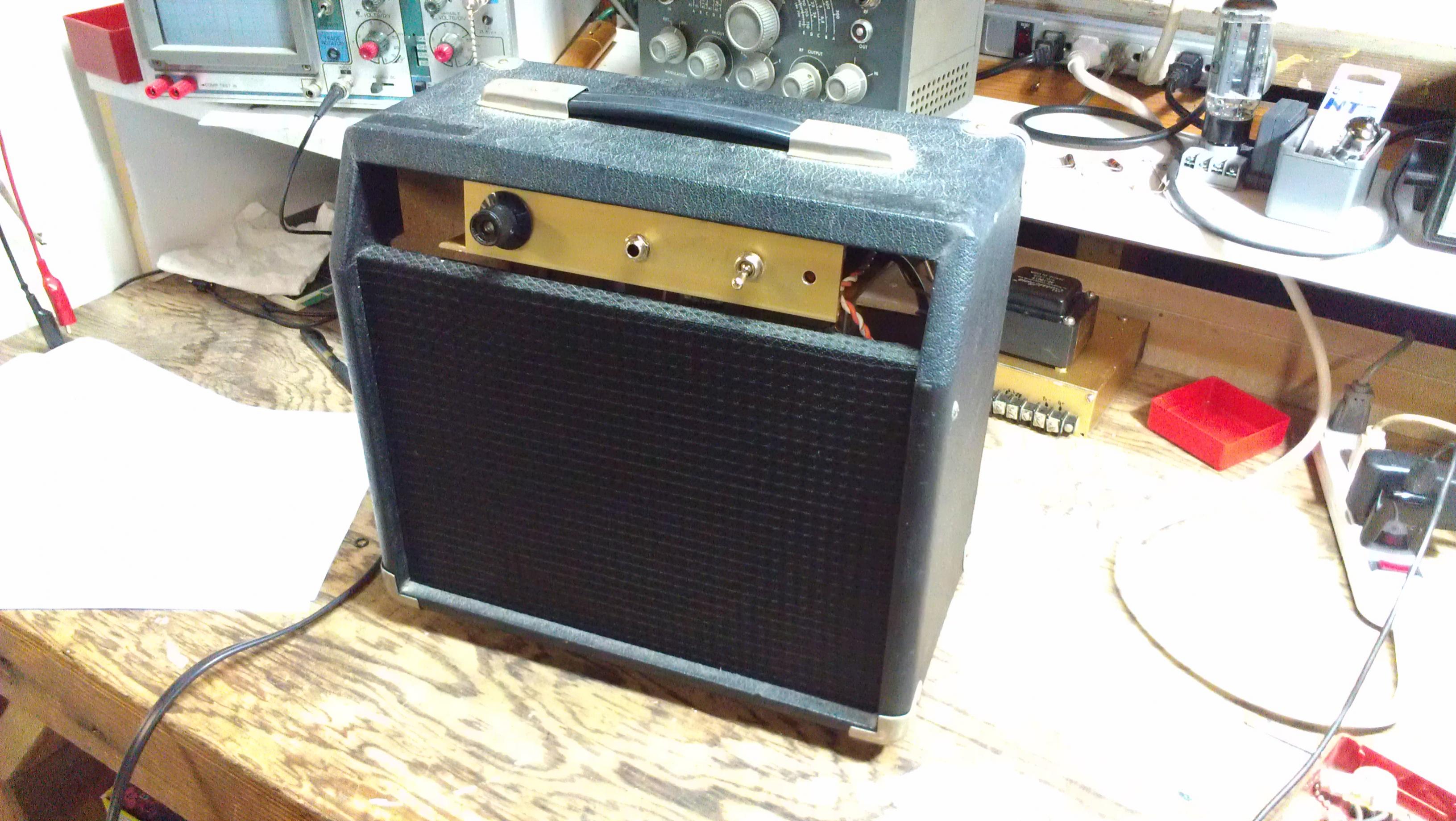

So I did not buy the Frontman 25R amp (at least for now) because I don't need to have their logo stuck on a practice amp. What I am in process of doing is design-build of a retrograde amp board . This will be the opposite of an ''upgrade''. Start with less features, focus on tone and build from there. Can use the cabinet/transfo/chassis and knobs of the donor amp (Fender or other practice amp orphan, or scratch build it. Scavenge the chip amp form the donor or e-buy a TDA board to keep the kid's costs down.
If a kid can upgrade a speaker, and swap a board for a reasonable cost, maybe it is worth it to him or her. People install computer board upgrades all the time, so just imagining this should not be too difficult.

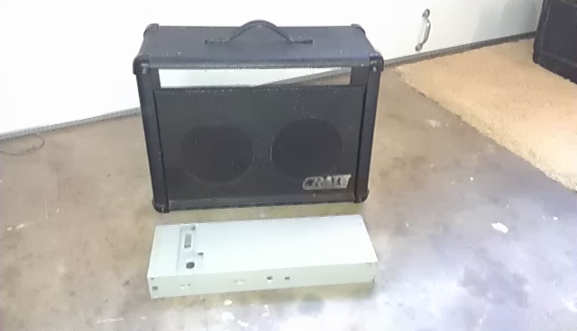

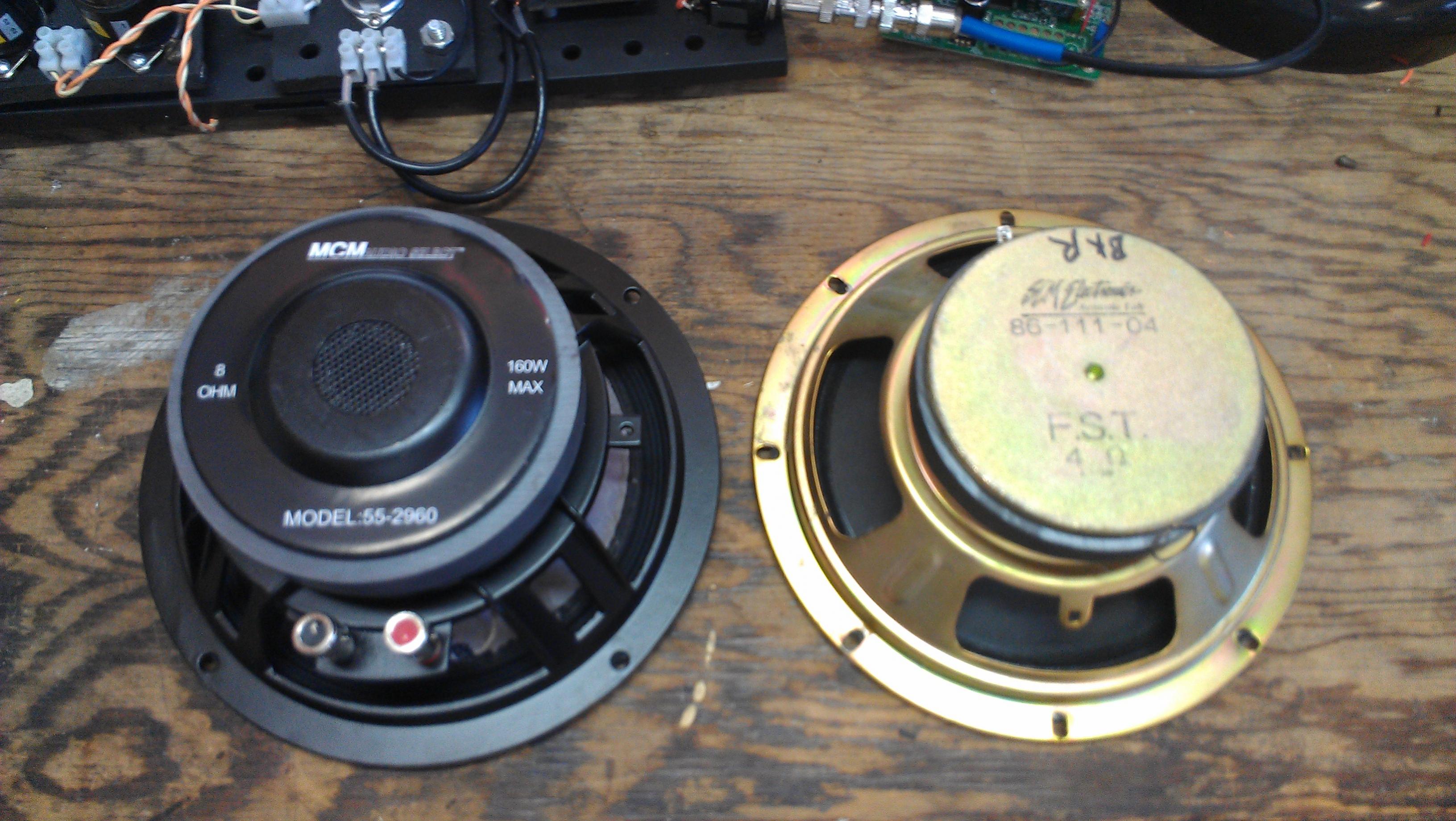

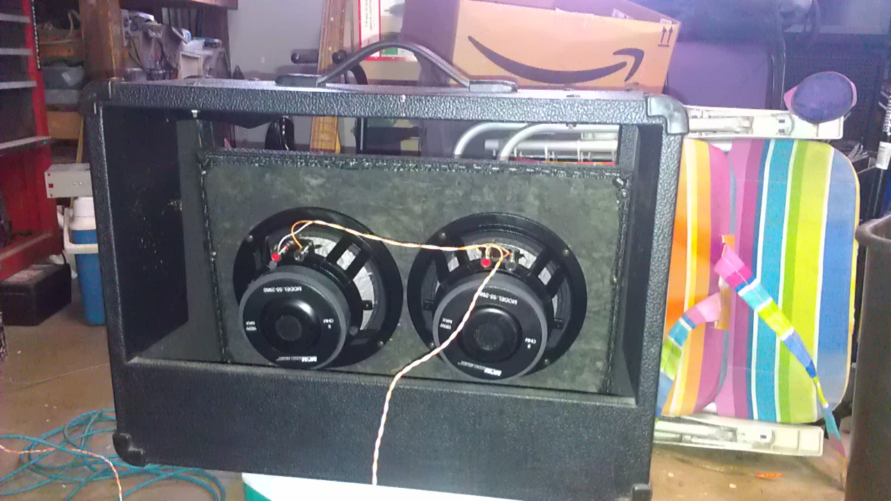

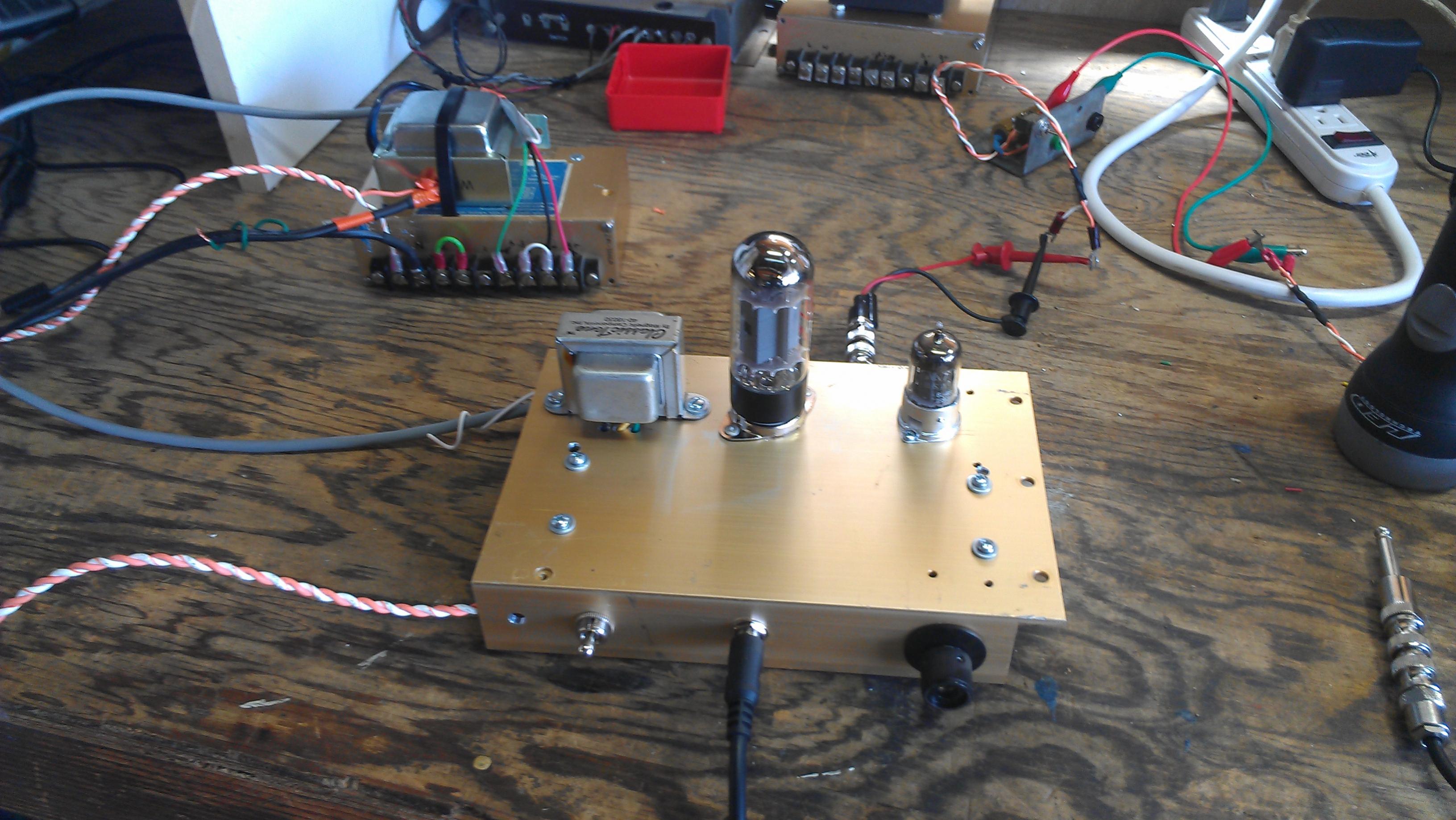

Yes everything was tight, and with me placing the 6V6 in the middle (for "symmetry") it was 1/4" away from the stock speaker! So I relocated the tube socket, and put in a 4 ohm from a Crate GX-40D cab (also shown) - which was a stereo chorus amp. It's getting a 5E3 Deluxe stuffed into it, with two 8 ohm MCM speakers. I's doing all this on the cheap, but still learning a lot. Only been into tubes for 1-1/2 yrs.... The amp drives a 2x12 cab nicely, so will have an ext jack so it will work for low-vol practicing, jamming, and maybe small stage use (with an external cab).

Hi JM, Right on about that. Could you compare the mod series with say a C10R or a C12R ''small magnet'' ceramic? I am now comparing the Fender stock Eminence (Blues Jr 50W rated big magnet) with a reconed C12R (25W) from 1967. To my ears, as I bring up the volume from zero, the lower wattage C12R sound comes alive much earlier (maybe less than 1W). The 50W Eminence starts to hit its stride at guessing 3 or 4 W, is more ''forward'' mid tone.
I am running a TDA 2030 chip amp at 14W max and the C12R just nails the mid 60's Fender tone. The C12R that I have is a special 4 ohm, I can't remember which amp companies were using these in '67. The new Jensen ''vintage ceramics'' are also very reasonable about $50 or $60.
So I guess choosing between various speakers comes down to tonal preference and matching speaker wattage to power amp watts. I really like the 25W rated speaker for a 10 to 15 W amp..especially at very low volume setting. The 50W rated speaker cone travel at very low power settings sounds a bit brittle and weak, but if you run it at 4 to 10 Watts it's really good. On a 25W rated amp, the big magnet speakers would be perfect.

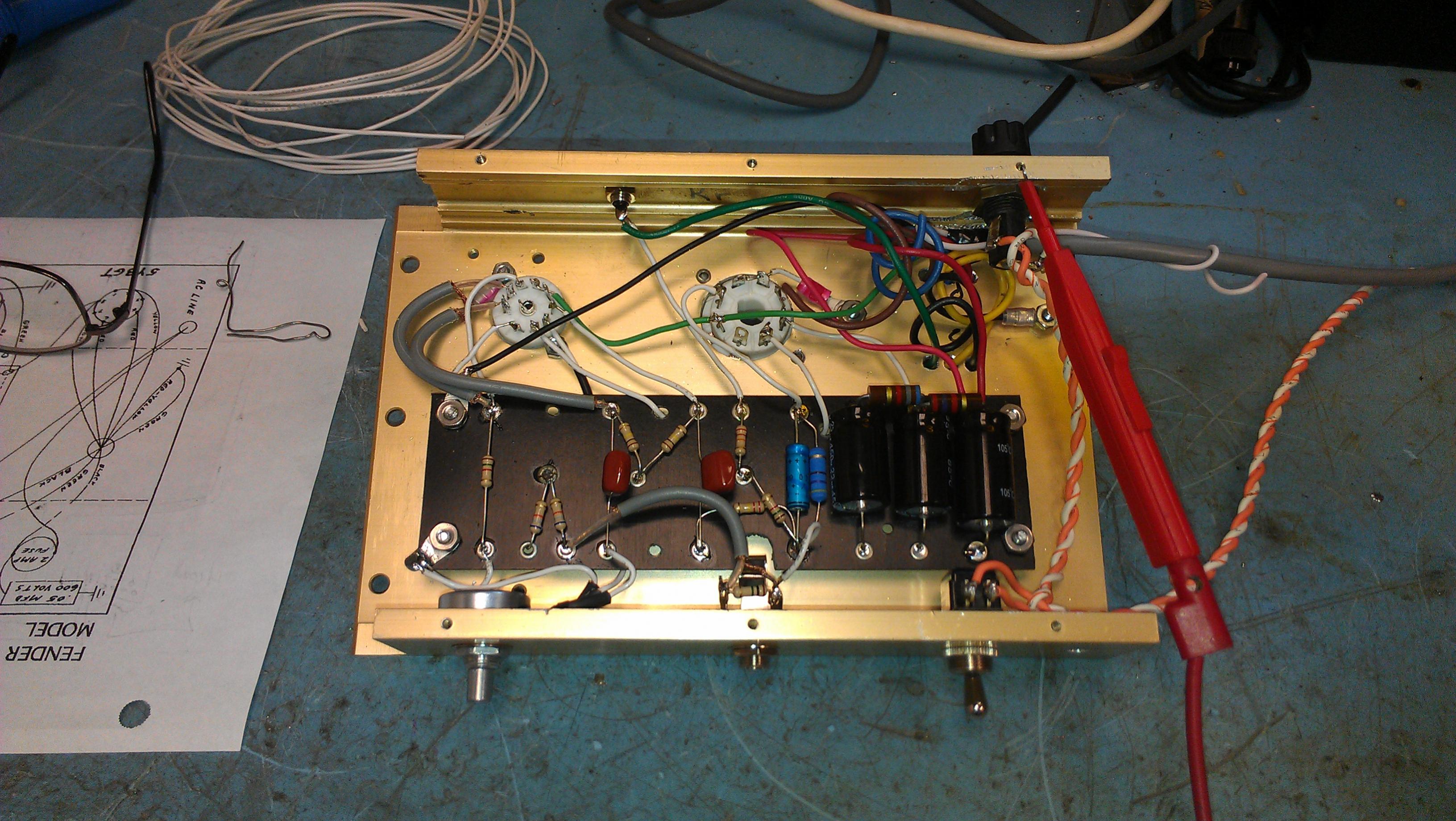

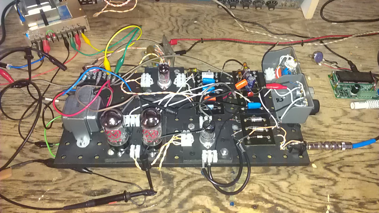

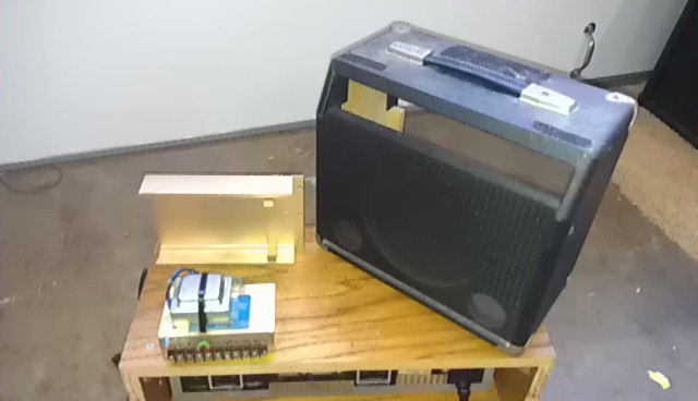

Just an update on my build and tests. I physically divided the amp sections onto separate boards. This was better for me to experiment, and I think that if someone wants to re-work an existing low cost practice amp it will be simpler to build and test section by section. Have a look at the section of chip amps in DIY Audio, and you will find excellent reference material, pictures of very good quality built amps .
My power amp is a TDA chip amp ''kit PCB'' and there are a few on the market which are around $15 for single channel with all components. The board was of good quality with plated through holes and I just modified so it could accept the current feedback, but it is not absolutely necessary to run with current NFB. I could have easily built it point to point on perfboard, but wanted to see what the quality of components would come with a ''low cost'' kit. They were adequate, but I think I'll replace with higher filter cap ratings on the electrolytics , a couple of film caps in place of ceramics and bigger heatsink.
The power supply board (rectifier diodes and 2200 uF / 63V filter cap) is perfboard and hard wired up . That is about $3 to $5. Or free (we like free in DIY!) if you pull the components from existing boards or junk parts bin. I am running 30Vdc to the power amp for about 14W into 4 Ohms. This is more than loud enough for a practice amp with the 12'' speaker.
The preamp board is built, it's ''old style'' point to point hardwired. 3 gain stages -3 discreet transistors in Class A. It's got a pre-gain adjust pot on first stage (with pull-to-boost switch), a volume pot, and single tone control (which I am in process of tweaking). I have some wiring to clean up but all is working well. Budget cost about $15 to $20 tops.
I can overdrive the gain stages very easily with the pull to boost switch, and get very nice overall response.
