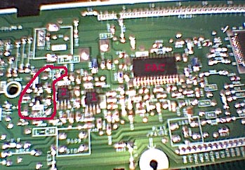

I bought a cheap sony CDP-212 for $NZ100 (~$US50) because it was a good transport, it would play even the most destroyed CDs without a hitch; and I am a poor student! However, it was a little harsh I thought, with a bit of sibilance on hi-hats and "S" sounds that had me reaching for the tone control on my tube amp (home made of course!)
After reading heaps of NGs and this site (what a great resource!) I went for it and did some hacking around.
The player has two PCBs, the main board directly behind the display and buttons with the audio and control circuitry marked CDP 212-312; and a small board at the rear of the player with transformer, filter caps and RCA jacks.

The DAC in this player is a ???2565 or something, the chip has been coated to make it impossible to read. This feeds into two 4558 dual-op-amps (see pic), through a couple of 100uF caps, muting transistors (circled) and then about 5 cm along the PCB to the aforementioned ribbon cable. Most components except the big caps are SMD which is a pain. The muting transistors turned into dust when I tried to unsolder them!
Just for a laugh, I drowned both crystals in a blob of epoxy resin. (Hey they vibrate right?!)
According to the datasheet for the 4558, the outputs are at pin 1 and pin7, which here fed directly into the 100uF cap. After reading 0.05 and 0.02 VDC across these caps, I felt pretty safe in subbing a 0.15uF film cap, which should easily block this level of DC. I connected the other end of the caps directly to the RCA jacks.

What do you mean the schottky diodes gave you weird power supply voltages? I would have thought they would be great with their lack of reverse recovery and therefore quietness. Also what is the deal with removing the mute transistors? Are they shunted across the line and therefore add distortion or something?

You might want to consider replacing the 4558's. I recently modded my Sony DVP-NS500V, and replaced a 4558 opamps with AD8620. Though, I feel you might get more bang for the buck with an OPA2134, especially if you find the sound on the dry side... the OPA part sounds to my ear more musical, lush and full (as if those words can really convey what I hear... heh), whereas the AD part seems to have a slightly dry analytical sound, but is somewhat more transparent. Also, on my 500V, I just shorted the output cap instead of replacing it, with no problems. I suggest the opamp swap first to see what kind of DC offset you're left with, but if it's just a few millivolts, I recommend going DC coupled. There are more details on modding the Sony players here: http://www.diyaudio.com/forums/showthread.php?s=&threadid=3971
Check out the diyaudio wiki, and you'll find my guide to SMD soldering, which I hope will help you deal with those little SMD critters in the future. You might also find out how to read the part number off that DAC which is probably a relabelled AKM part.
