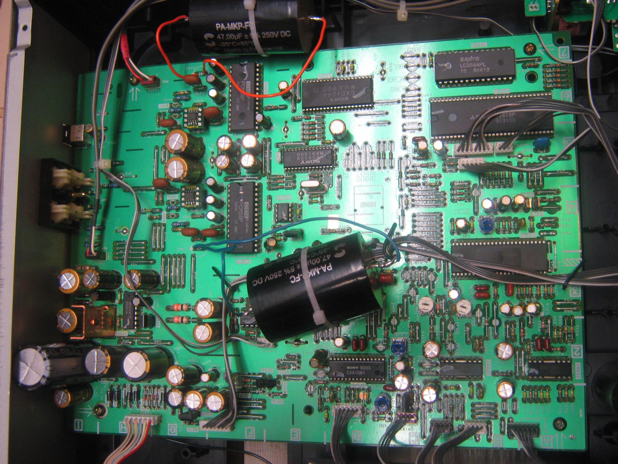

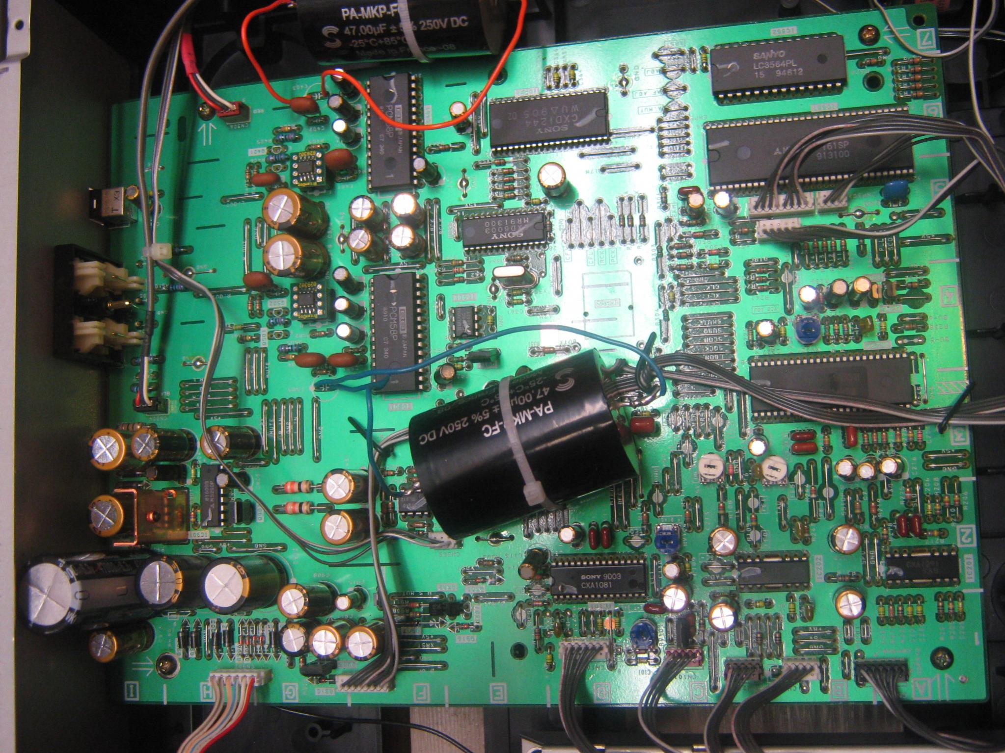

I just rebuilt a Sony CDP-508ESD.
Work performed:
1. Complete electrolytic recap with Nichicon Audio Grade Fine Gold series caps;
2. Belt replacement;
3. Deoxit of Volume pot;
4. Replaced all rectifier diodes with Schottkys;
5. Replaced resistors in signal path with metal film;
6. Replaced 47 uF caps in signal path with Solen polypropylene;
7. Removed output caps coupling signal path to ground;
8. Removed muting transistors (no noticeable clicks or booms);
9. Replaced opamps with BB OPA627s on brown dogg adapters;

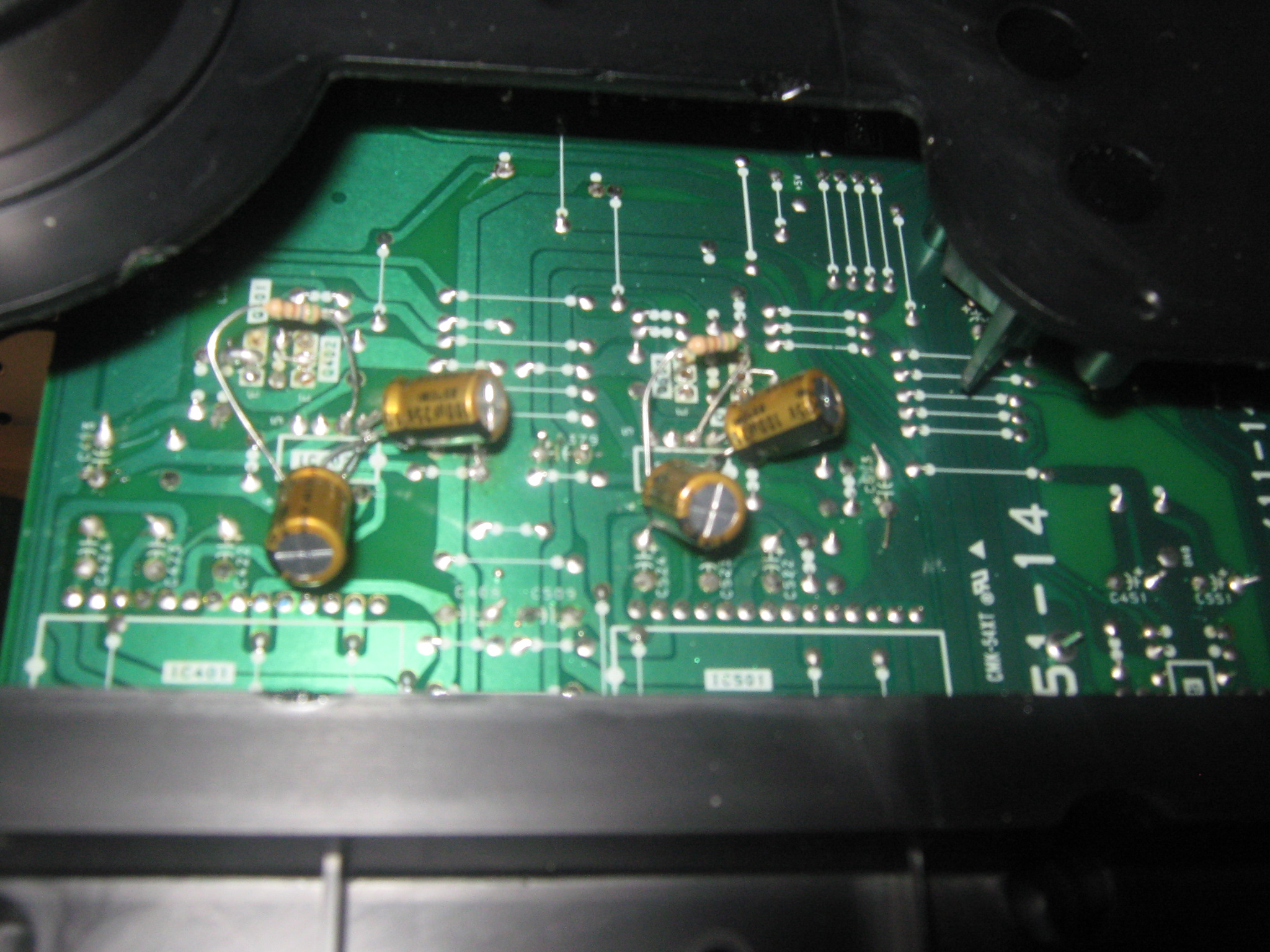

10. Added 100uF bypass caps to +V and -V on opamps to improve dynamics (see underside photo); and
11. Added 560 Ohm resistors from outputs to -V on opamps to creat 9-10mA biasing current to bias opamps into class A mode (see underside photo).
The player sounds good, but I'm not sure it lived up to my expectations. Does it sound better than my Oppo BD-83? Probably. But it's just different. The Sony probably sounds more analog with tighter bass, but the high end is a tad muted compared to the Oppo, and I think the Oppo has a wider sound stage. I need more listening time with this unit.
Comments?

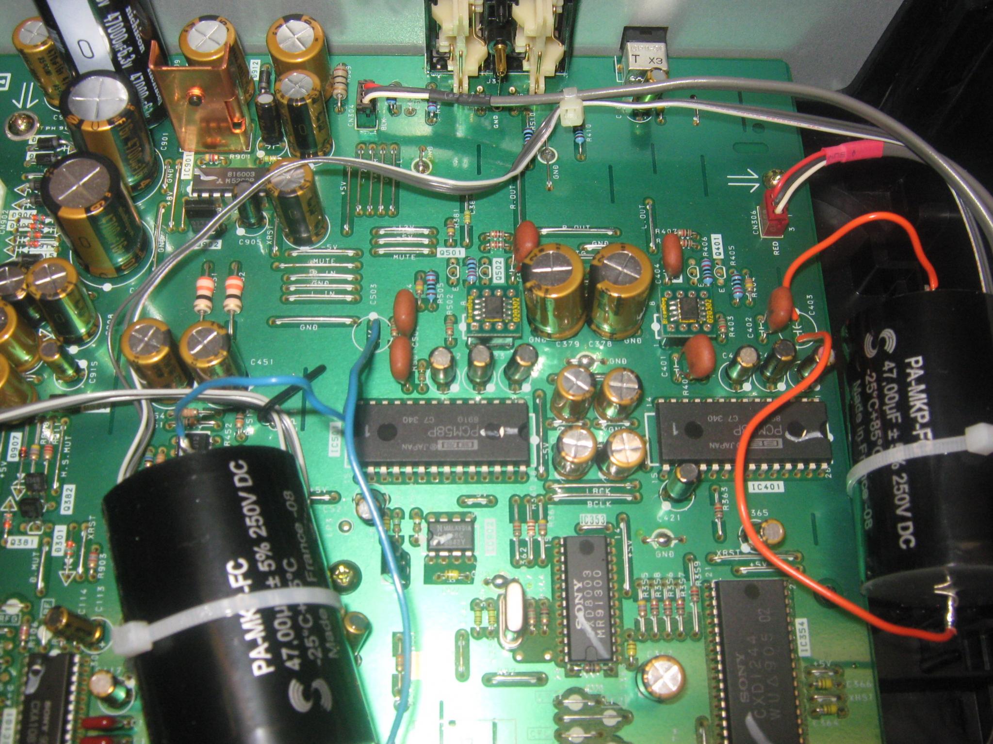

Those large caps connected by long wires might negate any benefits and also be prone to stray pickup etc.
See your other thread for thoughts on the opamps ;)
Also try decoupling the opamps rail to rail directly across the supply pins with a small 0.1uf cap rather than large electroylitics coupled into the grounds.
Why not try a FET device such as the OPA604 (dual OPA2604) which I find excellent as an I/V convertor/buffer.
I definitely agree with Mooly about the big caps. The thing I would consider though is whether you needed a cap that large in value at all.
Assuming the downstream device has an input impedance of 10kR, the cutoff frequency of the high pass filter that big cap forms is 0.34 Hz. A 4.7uF cap would give a cutoff frequency of 3.38 Hz, which is far enough away from 20 Hz to be fine.
I'd swap that huge cap out for something more reasonable, either 10 or 4.7 uF. You should be able to mount one of them right on the board with very short leads.
Yeah, electrolytic output cap are almost always much larger than they need to be. I guess it because they are cheap and small, and it may make up for their other deficiencies somewhat.
If you run the cap directly to the output, and there aren't any long leads, it should be okay. You've bought and fitted the 47uFs, I wouldn't go back and change them now.
I must correct the original message: this CDP sounds great and clearly beats the OPPO BD-83.
I had originally hooked my amp up via the variable output of the Sony, which has the sound running through a long cable that goes to the front of the unit, through a pot, and then back to the rear.
After trying the fixed output, the sound improved noticeably. I then installed new outputs connected directly to the solens, and DAMN.
Mighty fine sound. I've very pleased with this unit now.
