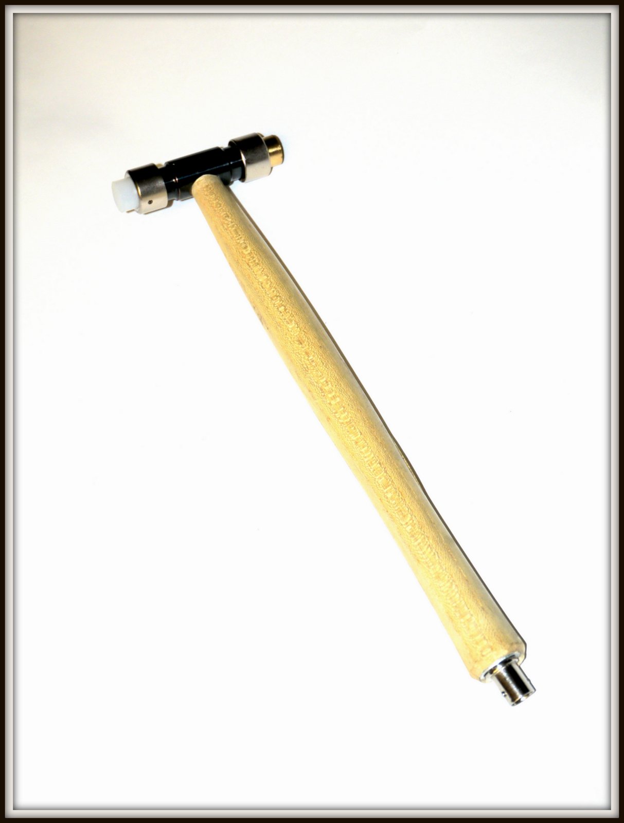

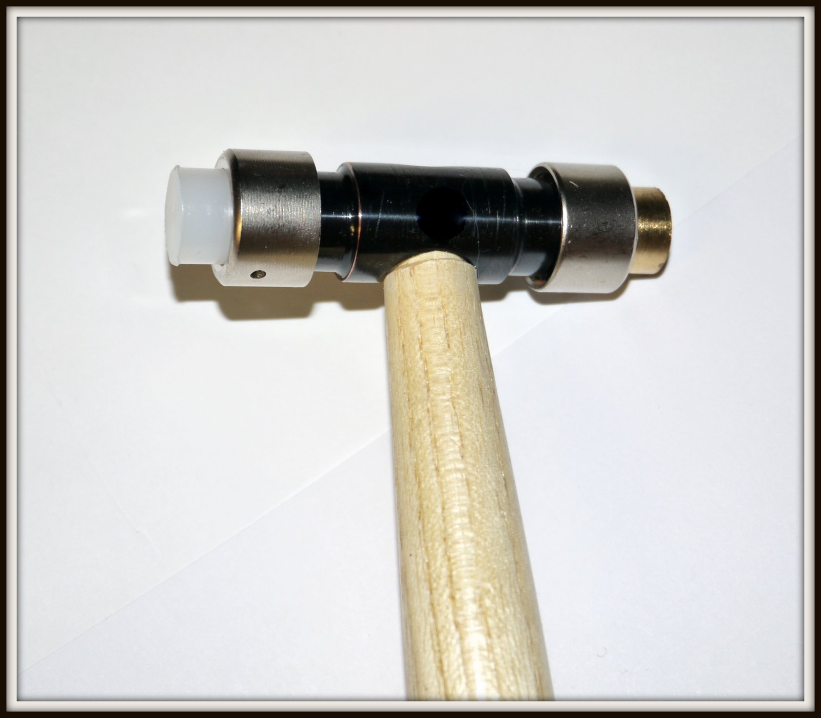

The modal analysis hardware has made some more progress lately, so I thought I'd start a new thread to post the updates. There have been a number of upgrades and improvements in this version of the hammer and it's about ready for a market test on eBay.

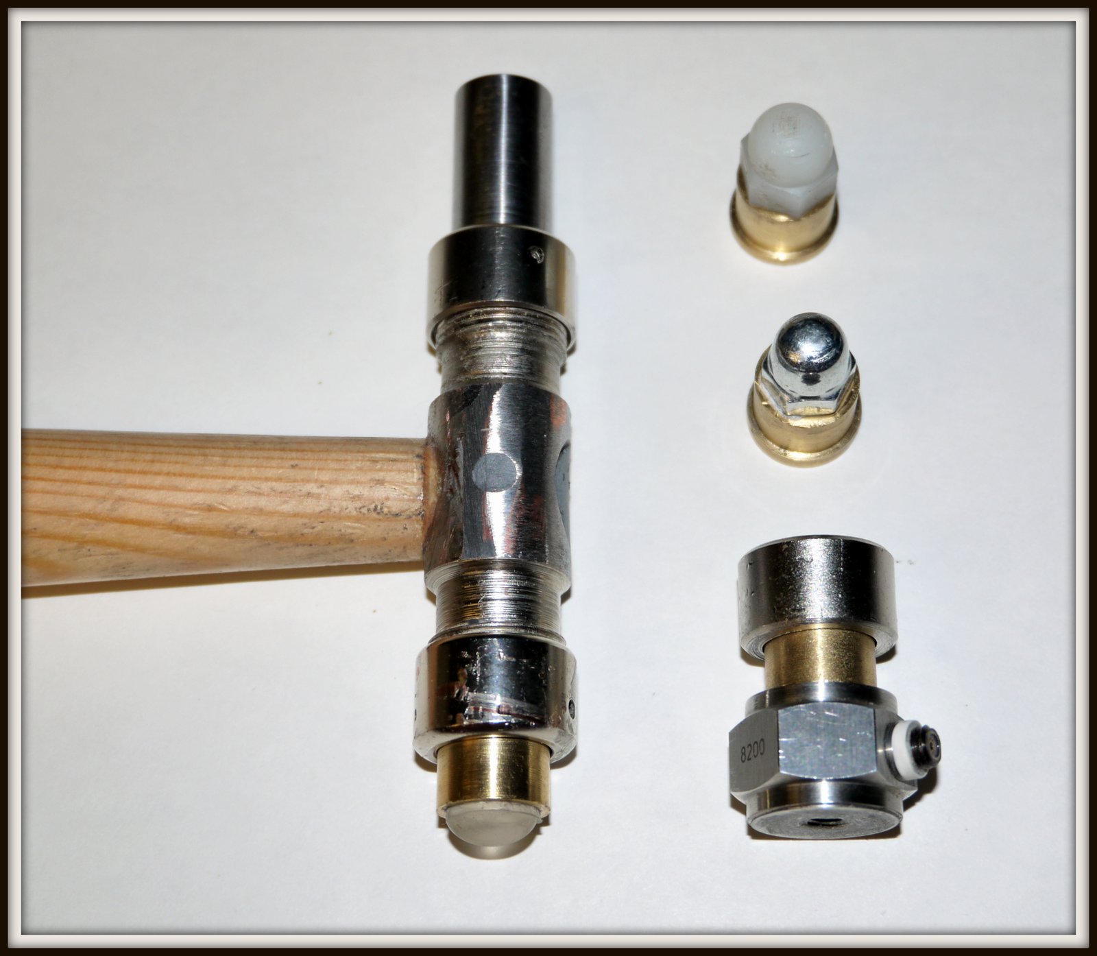

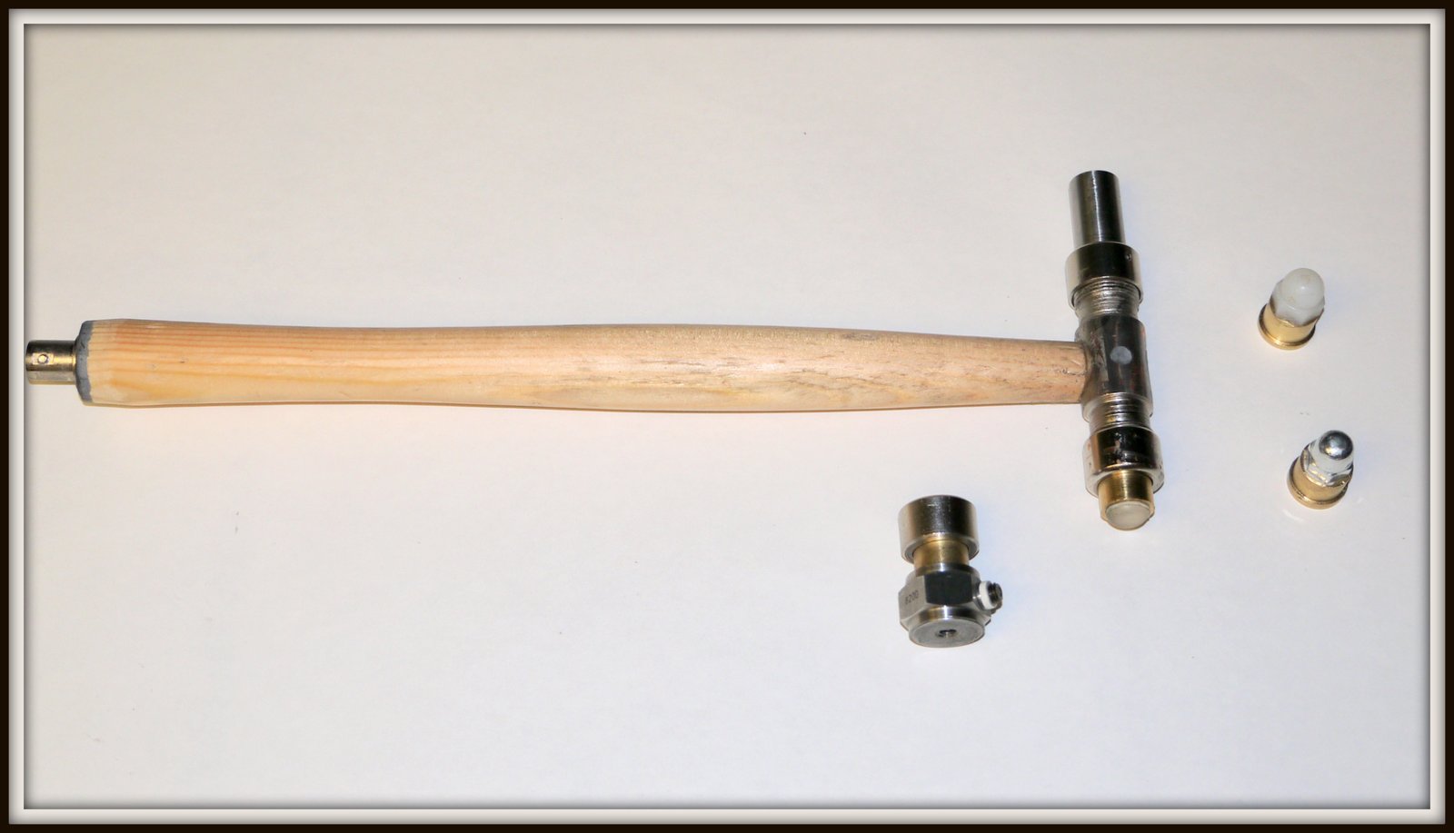

The photos show one of the latest versions of the hammer and its different tips. The tips include a choice of rubber, Nylon, or stainless steel. There is also a detachable added mass for the back of the hammer to improve the signal output of the soft rubber tip when needed.

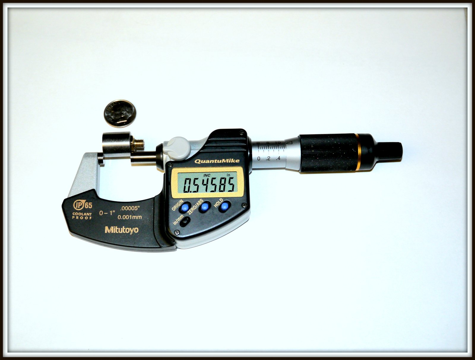

The other attachable item in the photo (not included with the hammer) is a Bruel & Kjaer 8200 force transducer that can be mounted on the front of the hammer and behind the selected tip. This adds an extra comparison calibration for the hammer's installed force transducer.

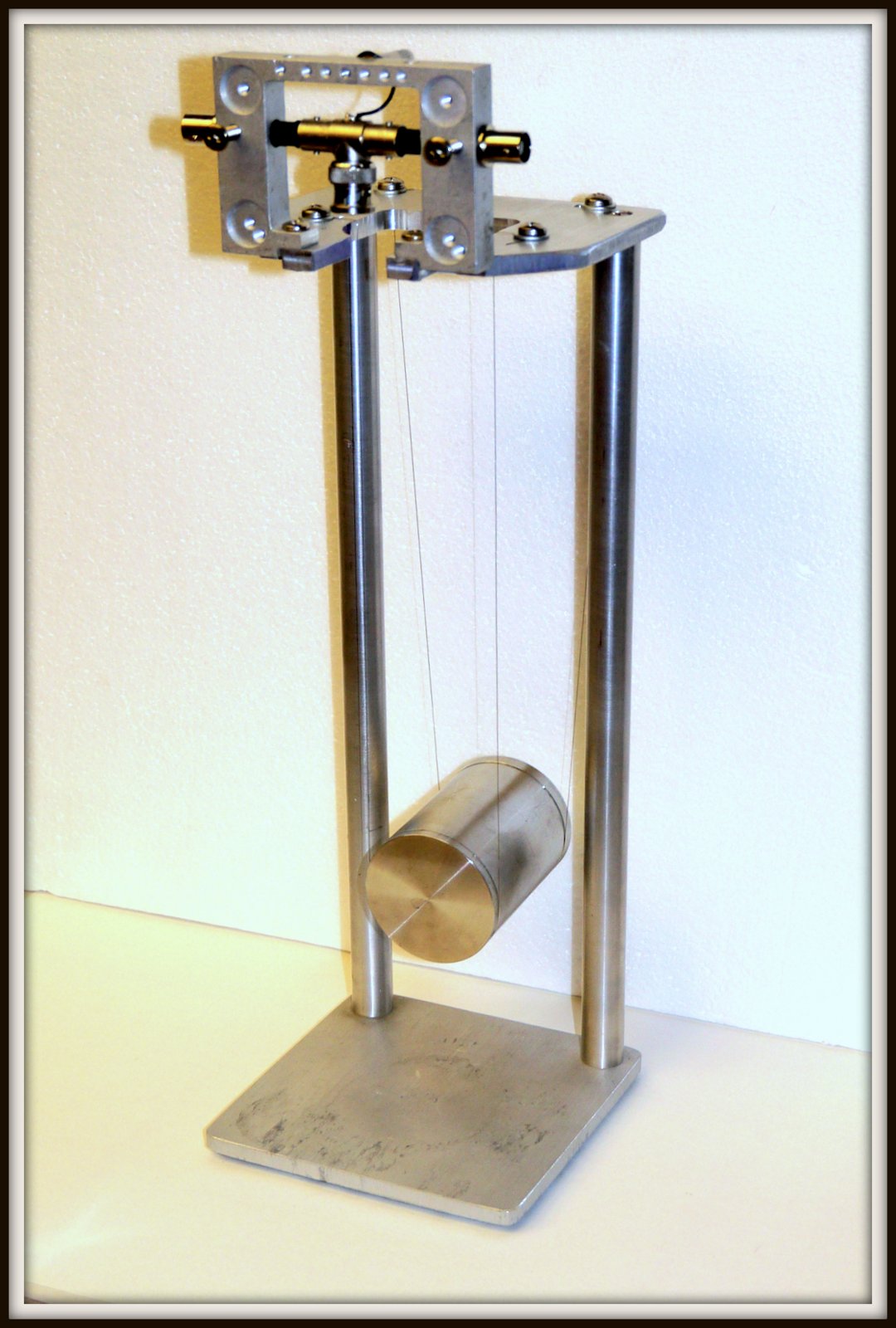

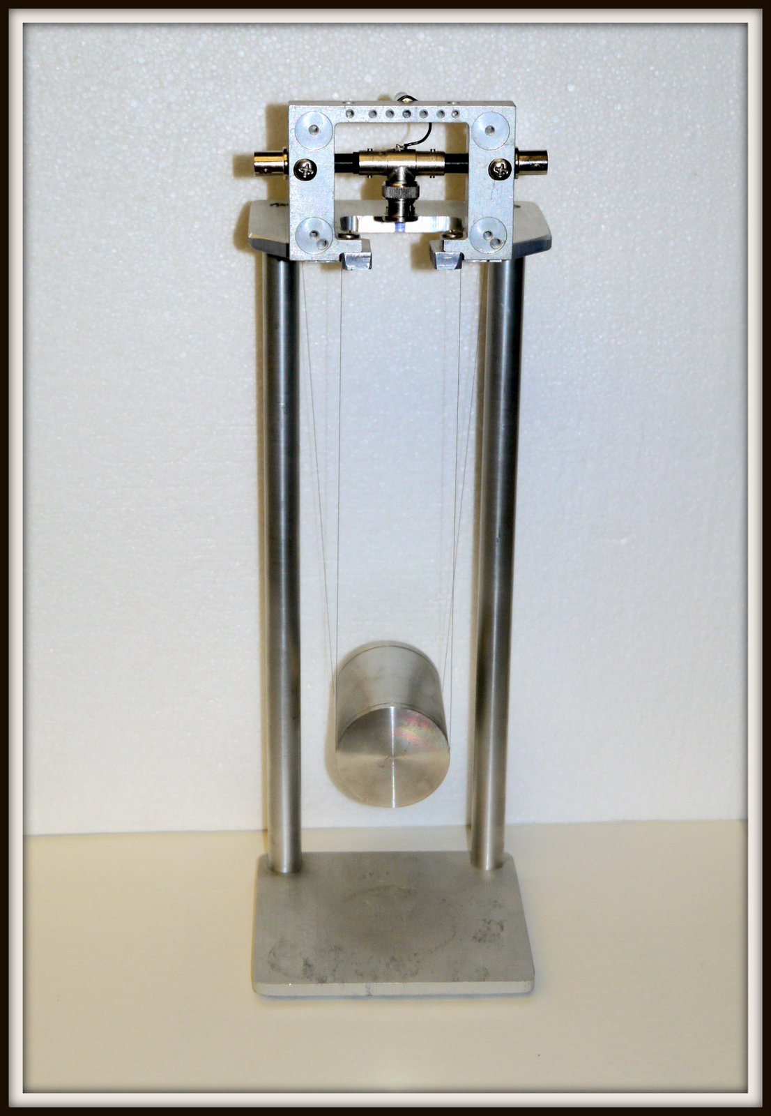

The calibration test stand consists of a cylindrical test mass supported on thin Inconel wires. The mass has a calibrated B&K 4384 accelerometer installed on its backside as a further calibration point.
The accelerometer design and testing is also close to the finish line and should be ready soon as a compliment to the modal hammer. The plan is to offer the pair as an entry level front end set of transducers for those who want to move up to the next level of speaker enclosure testing and evaluation.

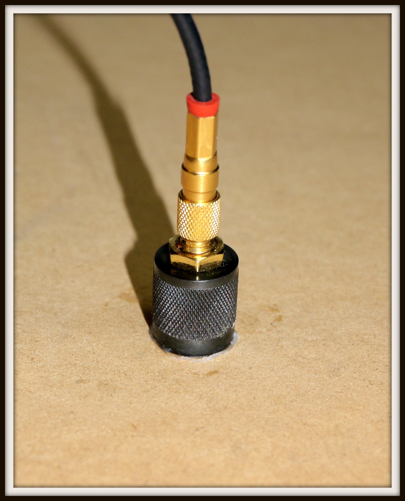

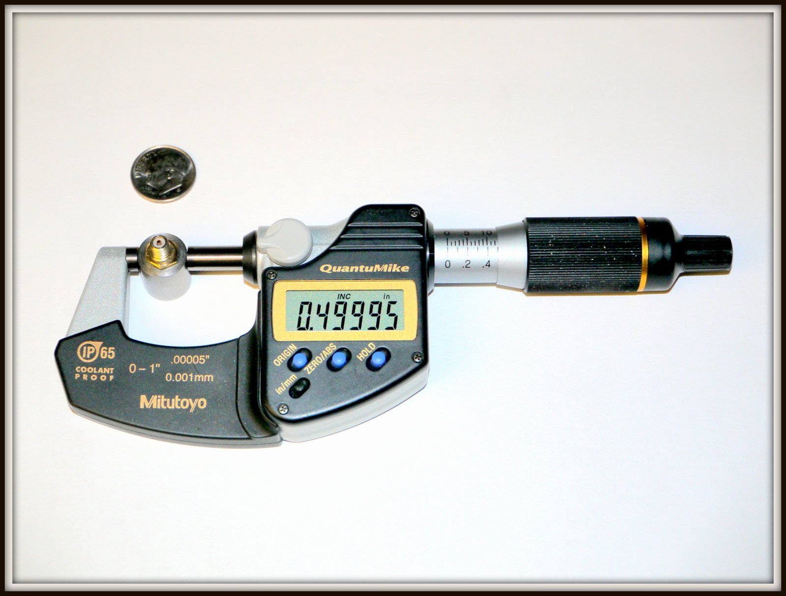

I think I've finally arrived at the last accelerometer design and a working prototype for the time being. This one weighs in at 11 grams and should work well with any speaker enclosure that's out there. Typically an accelerometer should not weigh more than 10% of the structure that is being tested. That would limit this ones practical use to a panel weighing no less than about 4 oz. I don't think there will be any mass loading problems with most enclosure tests.
I've just finished the final assembly tonight so the full characterization won't be done for a couple of days. The basic design incorporates a magnetic base for attachment to any ferromagnetic structure. Otherwise the attachment can be done with things like super glue, double backed tape, or microcrystaline wax. I'm a big wax fan! It's easy to use, very tenacious, and cleans up easily.
The photos indicate the size of the device.

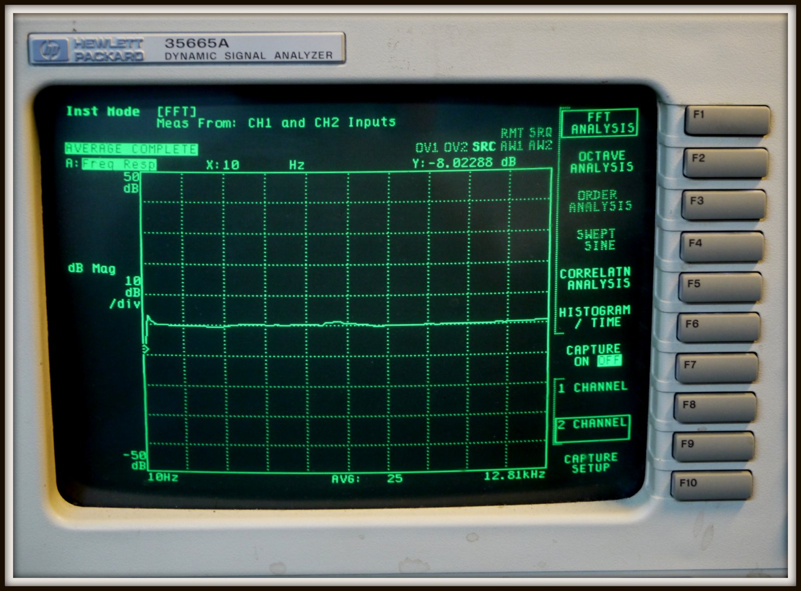

Some of the measurements that I've been playing with lately are transfer functions on the accelerometers. Using an HP 35665A Digital Signal Analyzer (DSA) I'm able to set up a network analyzer and do frequency response plots. Single point measurements using the B&K 2970 Sensitivity Comparator is useful when writing specs for the devices, but the frequency response plots hold much more information about overall performance.

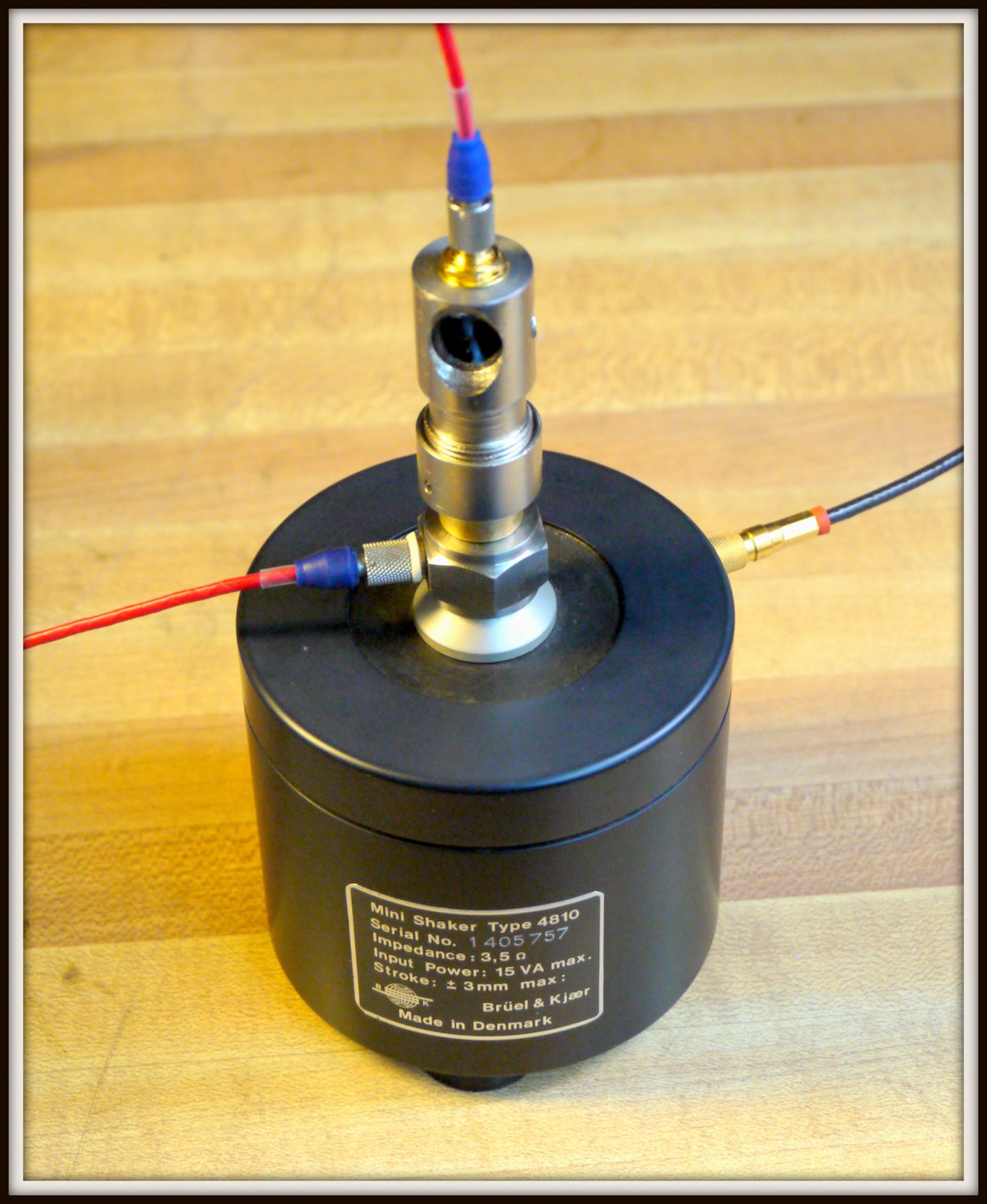

Utilizing the DSA's random white noise signal source and running it into a B&K 2706 amplifier, a B&K 4810 shaker can be used as a stimulus. The response is then generated using a B&K 8200 force transducer attached to the shaker along with the accelerometer to be tested coupled to the 8200.
I'm interested in how flat the frequency response plots are with the accelerometers that I'm building. The range needed to test most speaker enclosure panels would be about 10 Hz to 12 kHz. The 8200 is a flat line in that range, so any deviation from flat will be the transfer function of my devices.

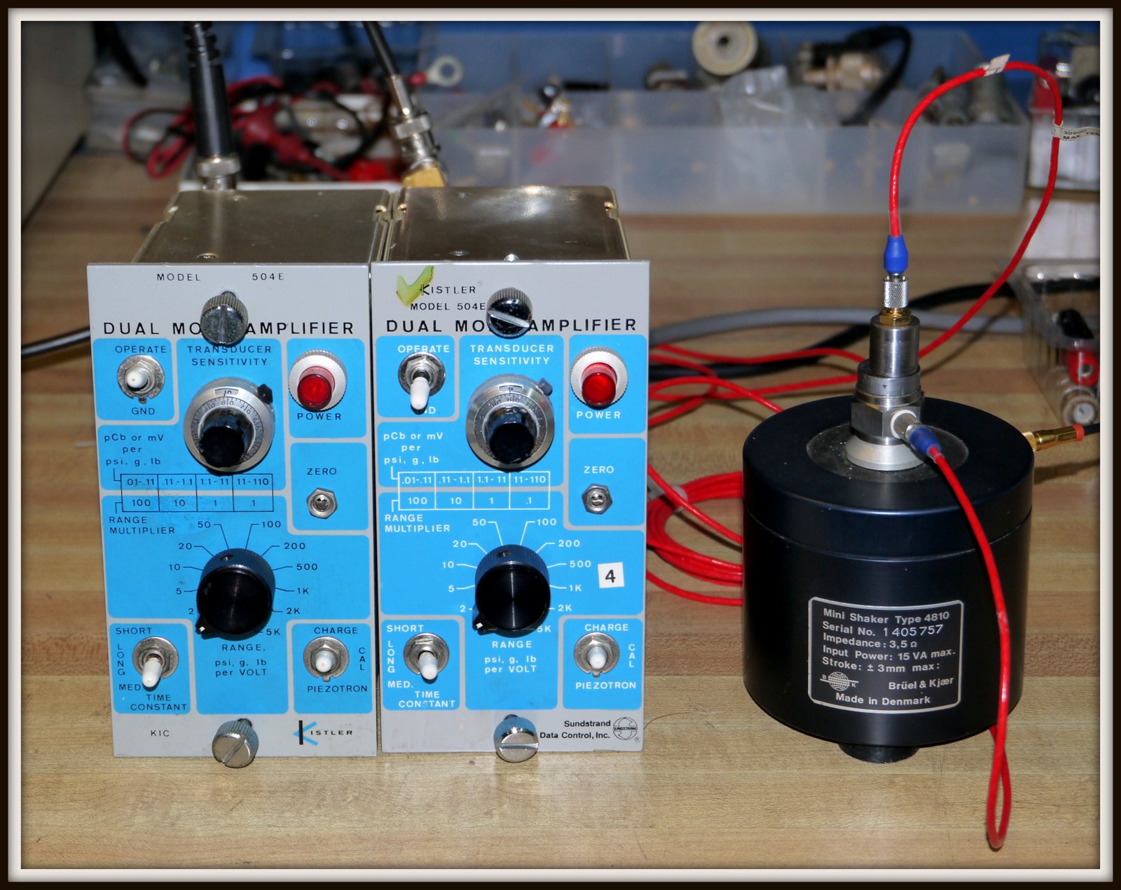

Here's a quick update on the accelerometer testing. The photos show the mini-shaker with the 8200 force transducer mounted to the table and the accelerometer mounted on top of it. The accelerometer has a magnetic base built into it for easy attachment to ferromagnetic surfaces. I machined a steel mounting plate to fit onto the 8200 for these tests. Wax or glue can also be used as an attachment option.

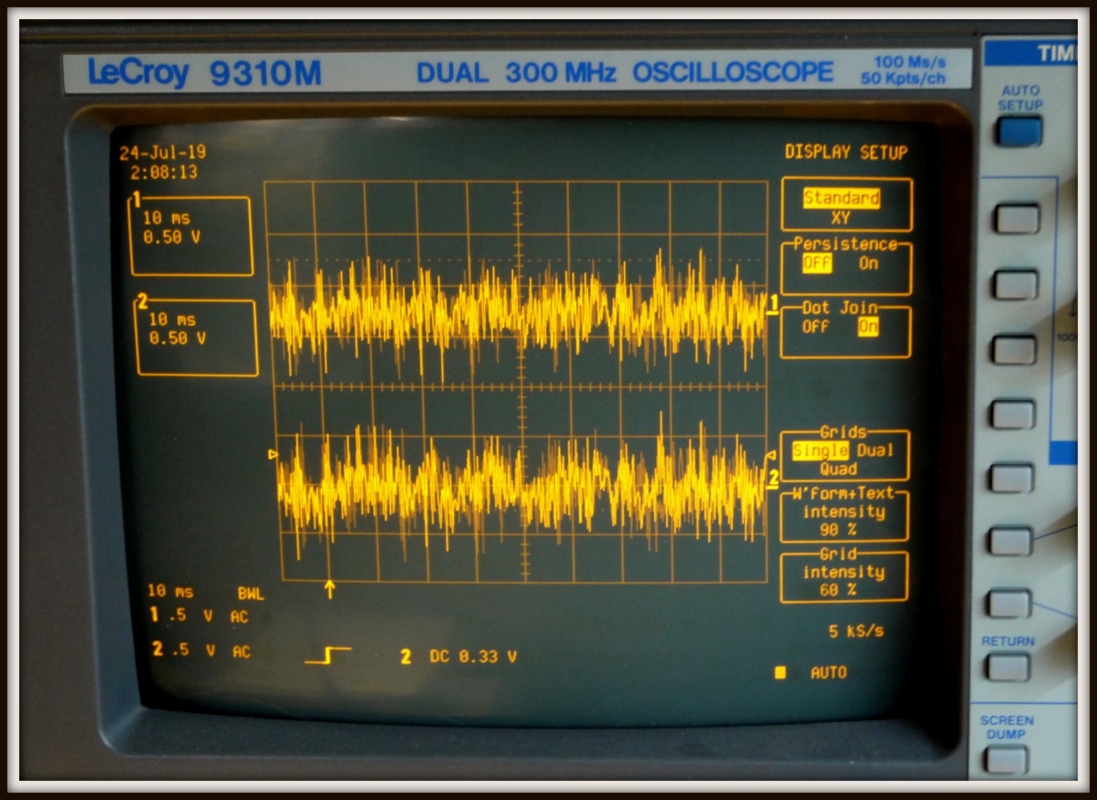

The DSA is set to do a frequency response plot from 10 Hz to ~ 12 kHz. The scope photo shows the random noise signal coming from each transducer. The response is well within what would be needed to do a simple modal analysis on a typical speaker enclosure.
The charge amplifiers are from eBay and also readily available from a source here on this forum.

I've gotten to the point where the modal hammer's load cell design is built as a discrete component. This allows each transducer to be tested as a frequency response transfer function without having to build a full hammer assembly for testing. Previously I had to build a complete hammer for these measurements.
The photo shows the setup for doing these tests. The same 8200 force transducer is mounted onto the table of the 4810 mini shaker that's used for testing the accelerometers. I've modified one of the modal hammer heads to allow it to be mounted on top of the 8200 the same way as an accelerometer would be mounted. The load cell can be inserted into the testing head and be preloaded for the measurement.
When a load cell is deemed worthy, it's transferred and permanently sealed into a finished hammer. Further measurement and calibration is then done using the pendulum impulse apparatus that was shown in a previous post.

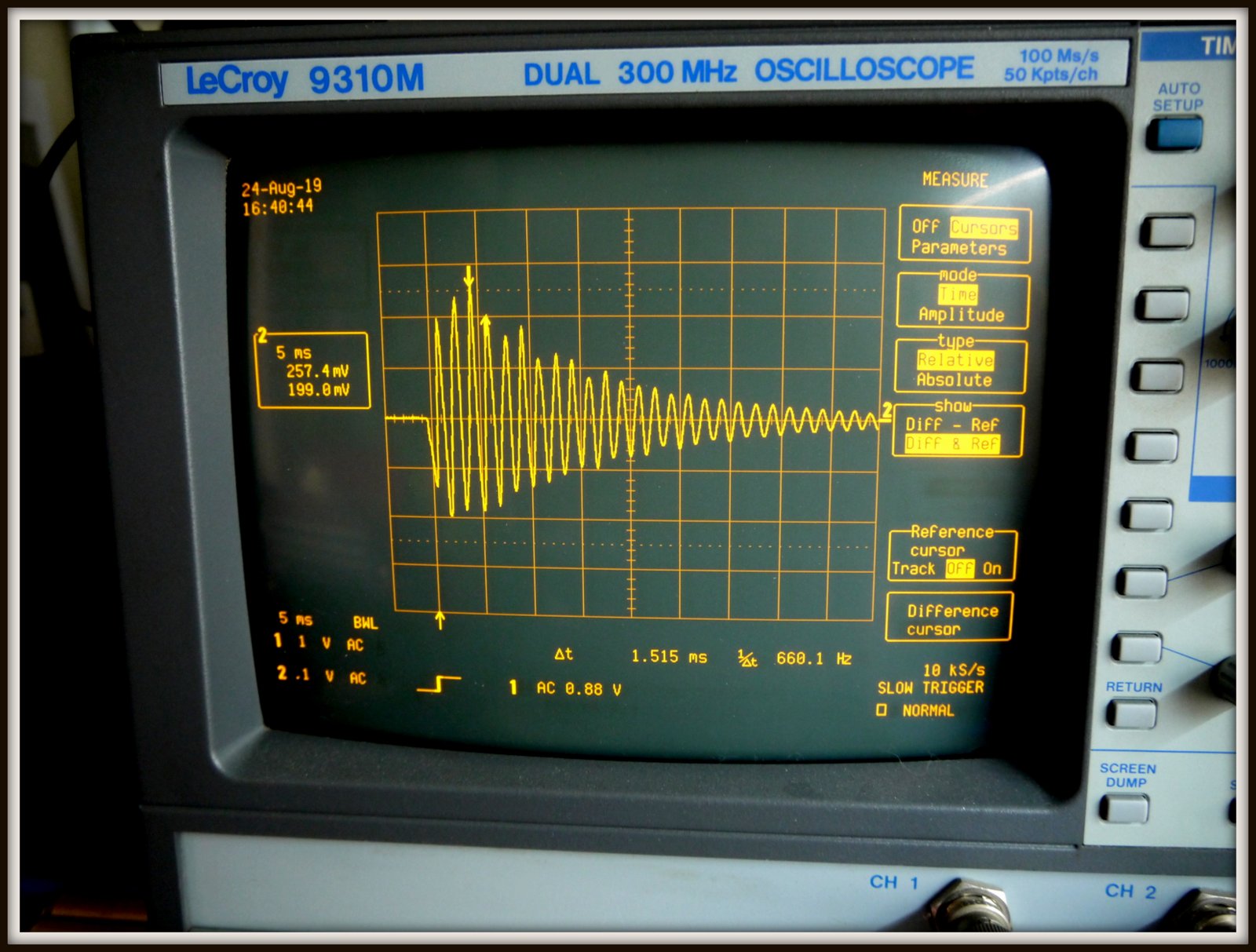

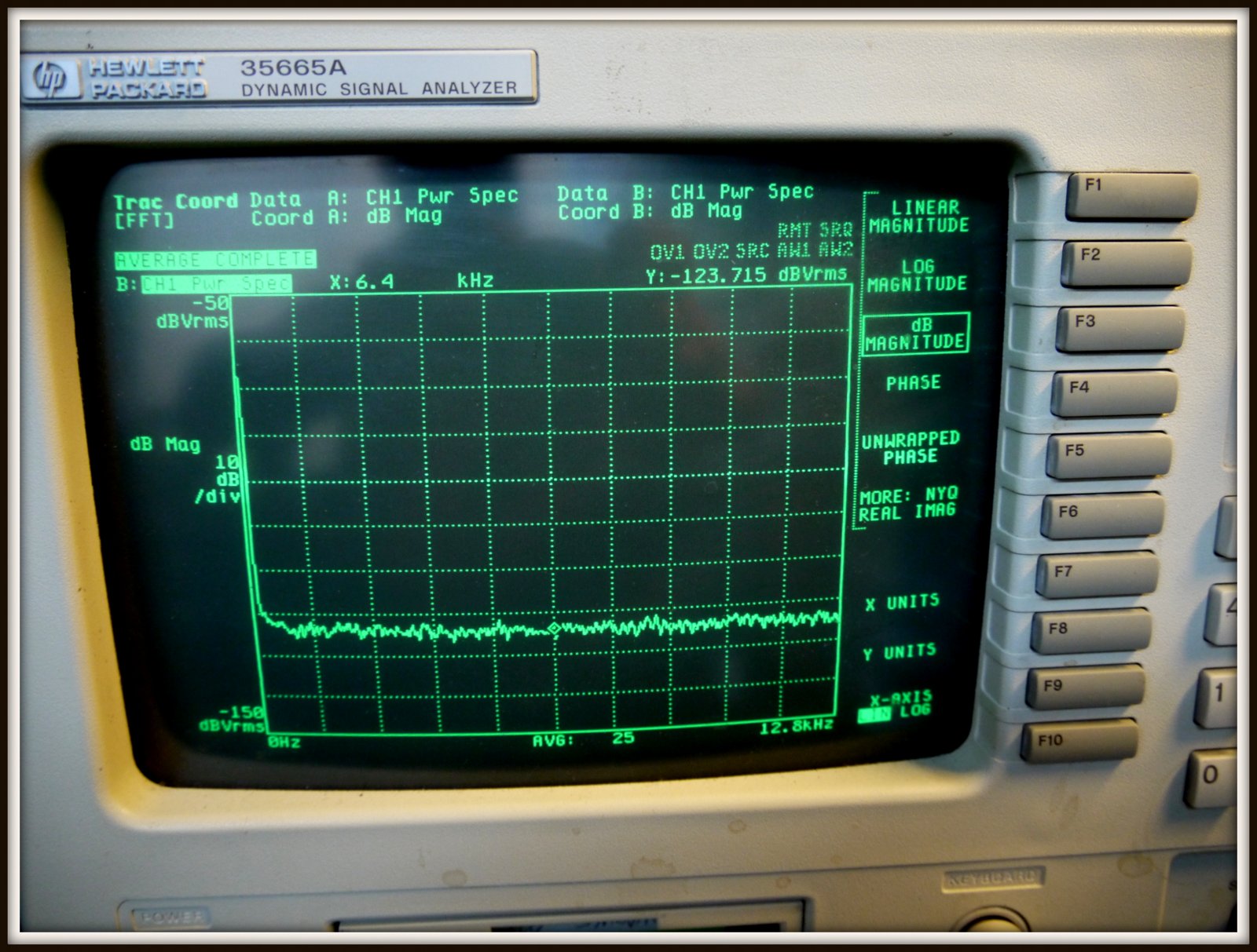

There was a question earlier about the S/N level when the modal hammer and accelerometer were plugged straight into an average DSO with 1 Meg ohm inputs. One photo show the noise floor of the accelerometer when connected straight into ch1 of the hp DSA. The device was left just hanging in the air on its cable. As can be seen the noise floor of the device is below -120 dBVrms out to at least 12.8 kHz.
The screen shots of the LeCroy scope were also taken with the outputs of the modal hammer and the accelerometer connected straight into ch1 and ch2. The signals were produced using the accelerometer attached with microcrystaline wax to the center of a 1 sq. ft. 3/4" MDF in a quasi free-free arrangement with the panel laying on top of a piece of egg-crate foam. The top trace is the output of the hammer's tap and lower trace is the accelerometer's response.
This is a reasonable demonstration that the modal approach to doing entry level speaker enclosure testing can be done without having to over invest in some of the more expensive hardware and instrumentation typically used for these measurements. More hardware and software can be added as the testing advances according to ones needs and desires.

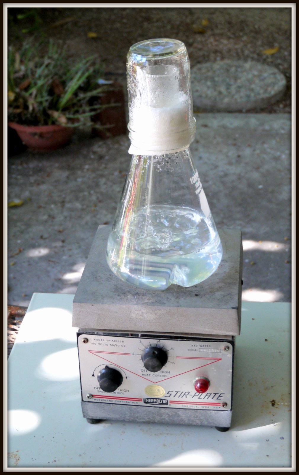

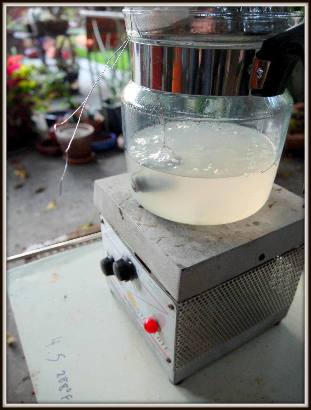

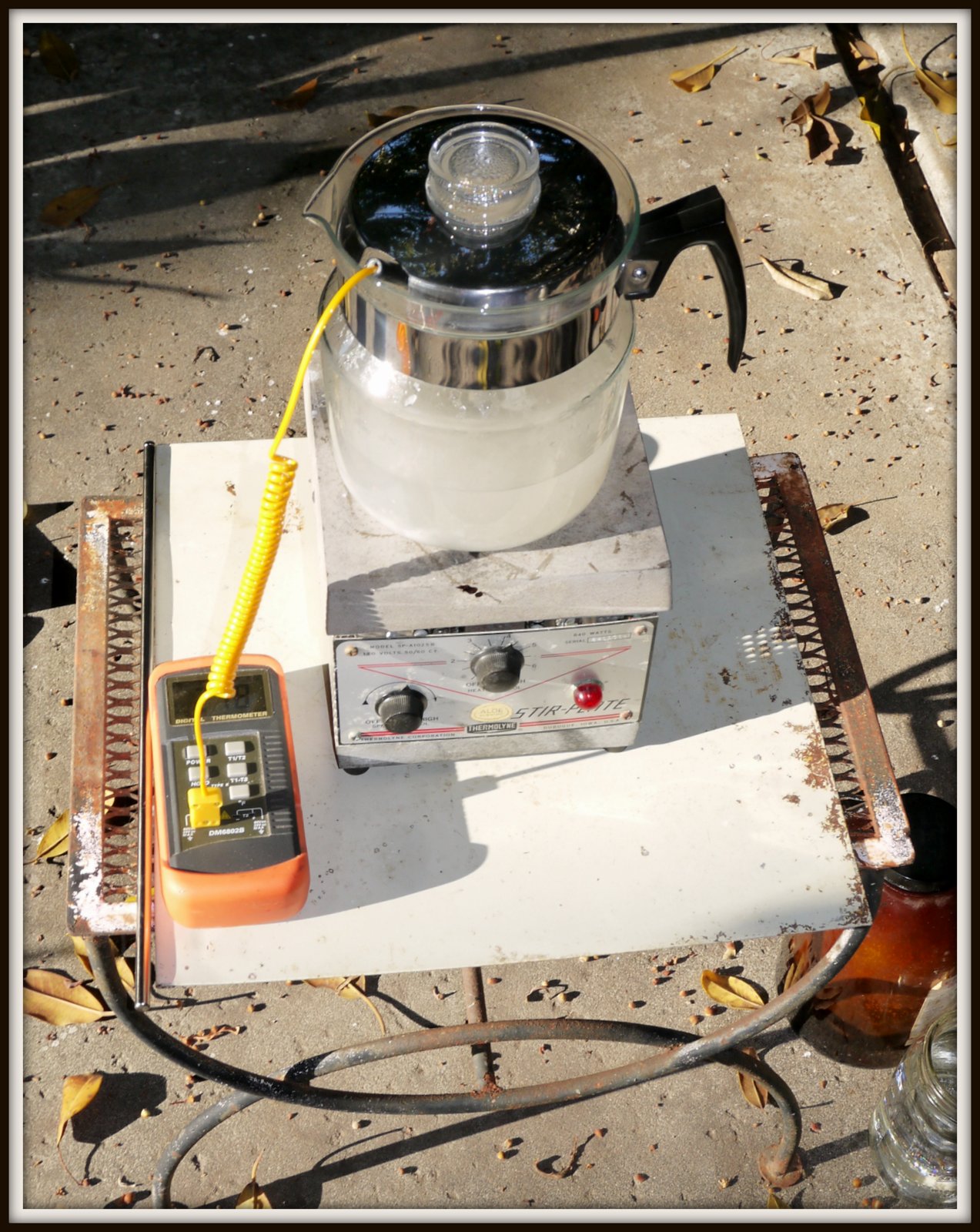

The photo of the flask sitting on the hotplate shows the method I used to put a hot black oxide coating on the accelerometer body. Most of the literature on this method claims that the process of doing the "hot" coating at home should never be attempted unless you're a thrill seeker with a death-wish. I'll allow that there's some merit to that advise.
One of the photos shows the finished accelerometer mounted on the MDF. I'll have to say that I think the coating came out pretty good as far as I can tell using my one remaining eye.
