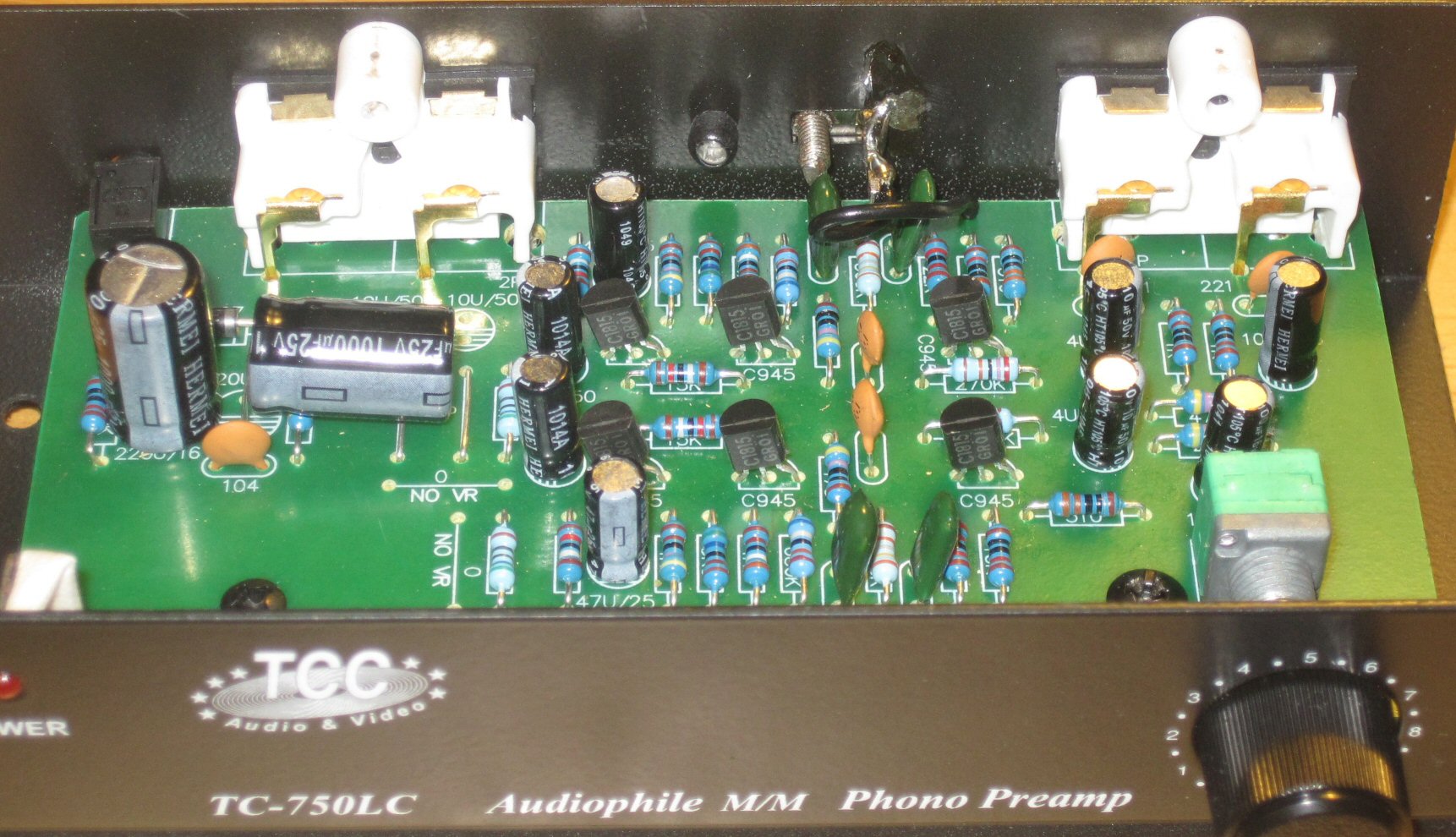

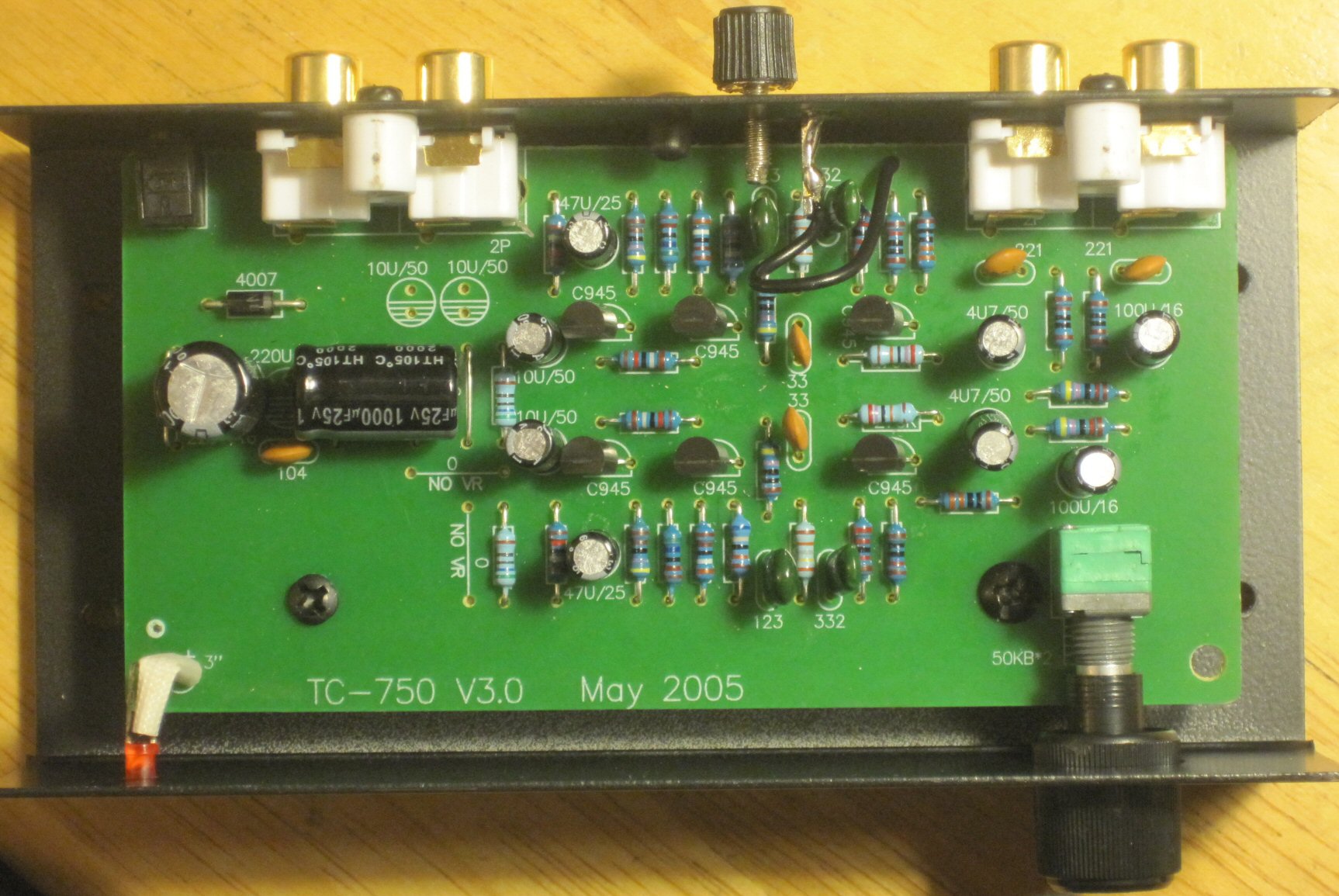

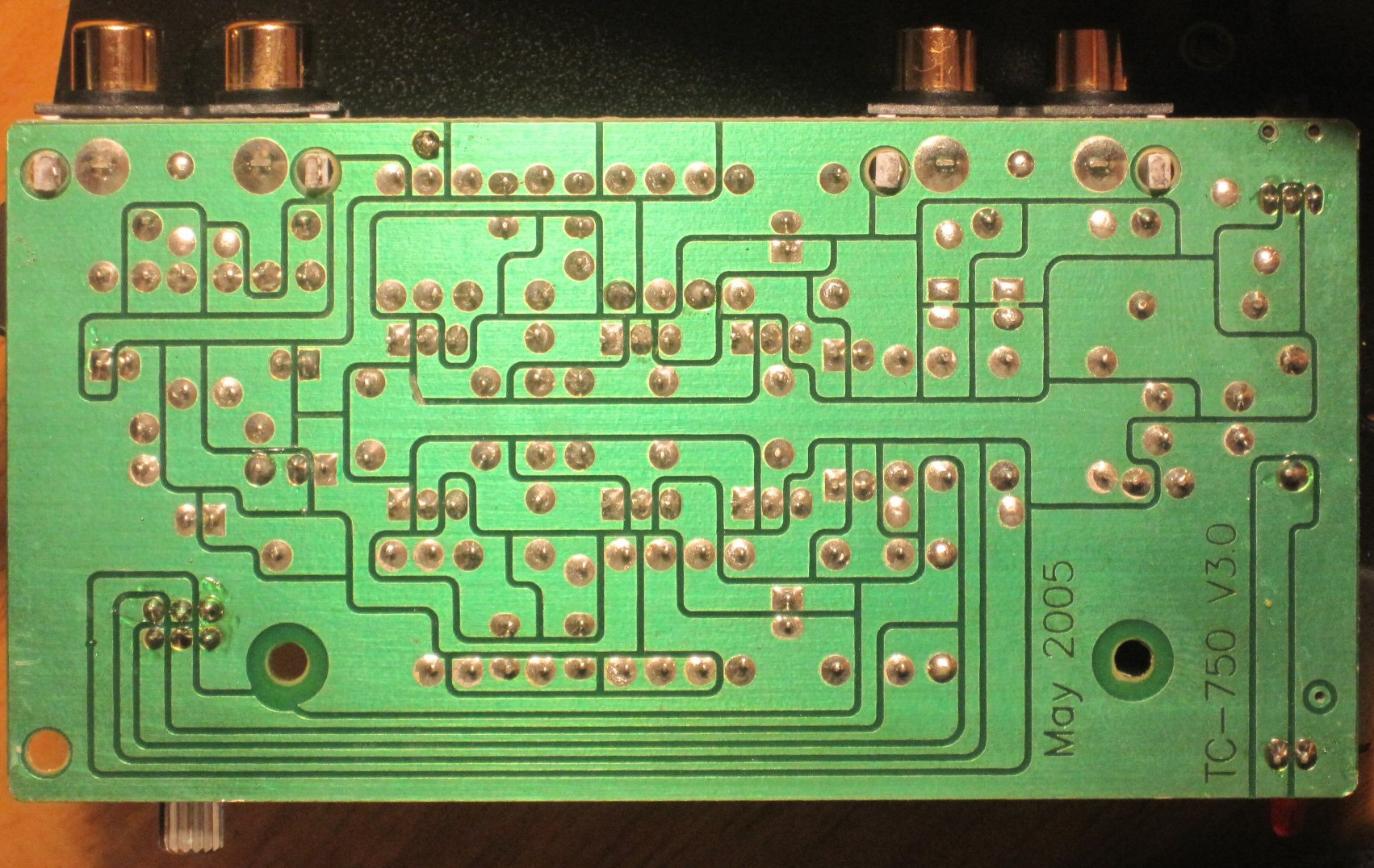

I have a TCC TC-750LC phono preamp. I want to increase it's gain by about 6db -10db. It seems that I should be able to tweak the values of a couple of components to do that. But I would be mostly guessing what to change since I only partially understand the circuit. Anybody have some good thoughts on how to accomplish this without hurting it's other performance levels?

Here is a link to a schematic. and a couple of pictures of the PCB I took:

Just took a quick glance.
A short remark at first: increasing gain always cost a noise-, distortion- and bandwidth-penalty.
The gain is defined by the impedance of the EQ-network (R5,6,15,C4,5) over R4s value ( at dc) resp. R3s value at ac. If R3 is reduced to say 100 ohms the gain should rise by a factor of 3.3 or ~+10dB. 165 ohms for R3 should double the gain, giving +6dB. C3 forms a subsonic filter thats centre frequency shifts linearly with R3s value. Reducing R3s value by a factor X requires an increase in C3s value by the same factor.
You can start with decreasing R3, leaving C3 as it is. If you audition a slight loss in Bass amplitude increase C3, otherwise You may leave it as is.
You can decrease R3s value eithe by direct replacement or by paralleling a srcond resistor to R3. A second 330Ohm would result in 165Ohms and +6dB gain. A 140Ohms resistor would result in 100Ohms, +10dB.
C3s value increses with paralleled caps. The values simply sum up.
So tweaking should be easy, as would be reinstalling original state.

Thanks for your analysis and suggestions. Without it I would have assumed that lowering the value of R4 would have been the place to start. My soldering skills are much better than my transistor theory and circuit understanding, so I will try piggybacking a few different resistors onto R3 and see what I get for output. Do you have any guesstimate on what degree of noise/distortion/etc. increase I might see? Is that typically a linear relationship to gain?

Thanks, I added a 330 ohm resistor across R3 on one channel, and as you said, I got an increase of 6db in signal. As you also said, I got an increase in noise. I saw that in the noise floor, which seems to have gone up about 10db. I was hoping for a better ratio. But at this point I have not actually had a chance to listen to the amp. So I can't comment on if I can really hear a quality difference or not. I also need to find some 100uf caps, to try in parallel with C3, and see if/how that changes anything.
Do I need to consider changing R12 due to the change in R3? Or does the value of R4 relative to R3, override any need to change R12?

Just to follow-up, I decided to decrease the gain by 6db so swapped the 330-Ohm resistors for 680-Ohm, I did before/after measurements of the Hi-Fi News test record pink noise track and checked them via REW and found no difference in the bass, and listening seems to confirm this.
