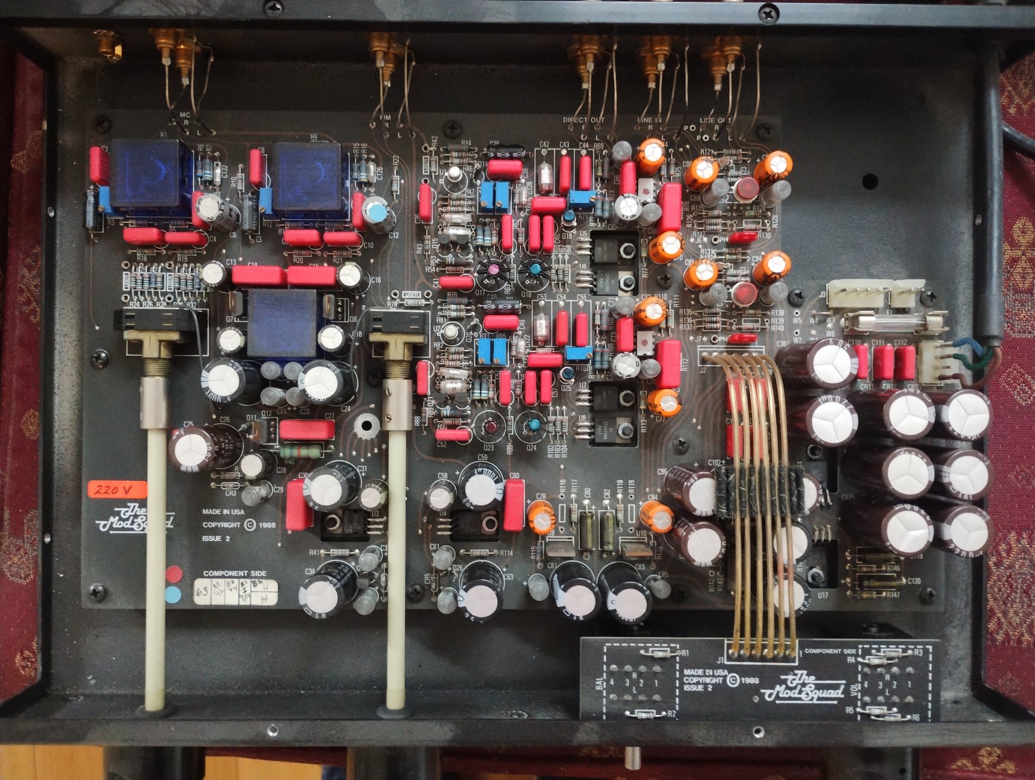

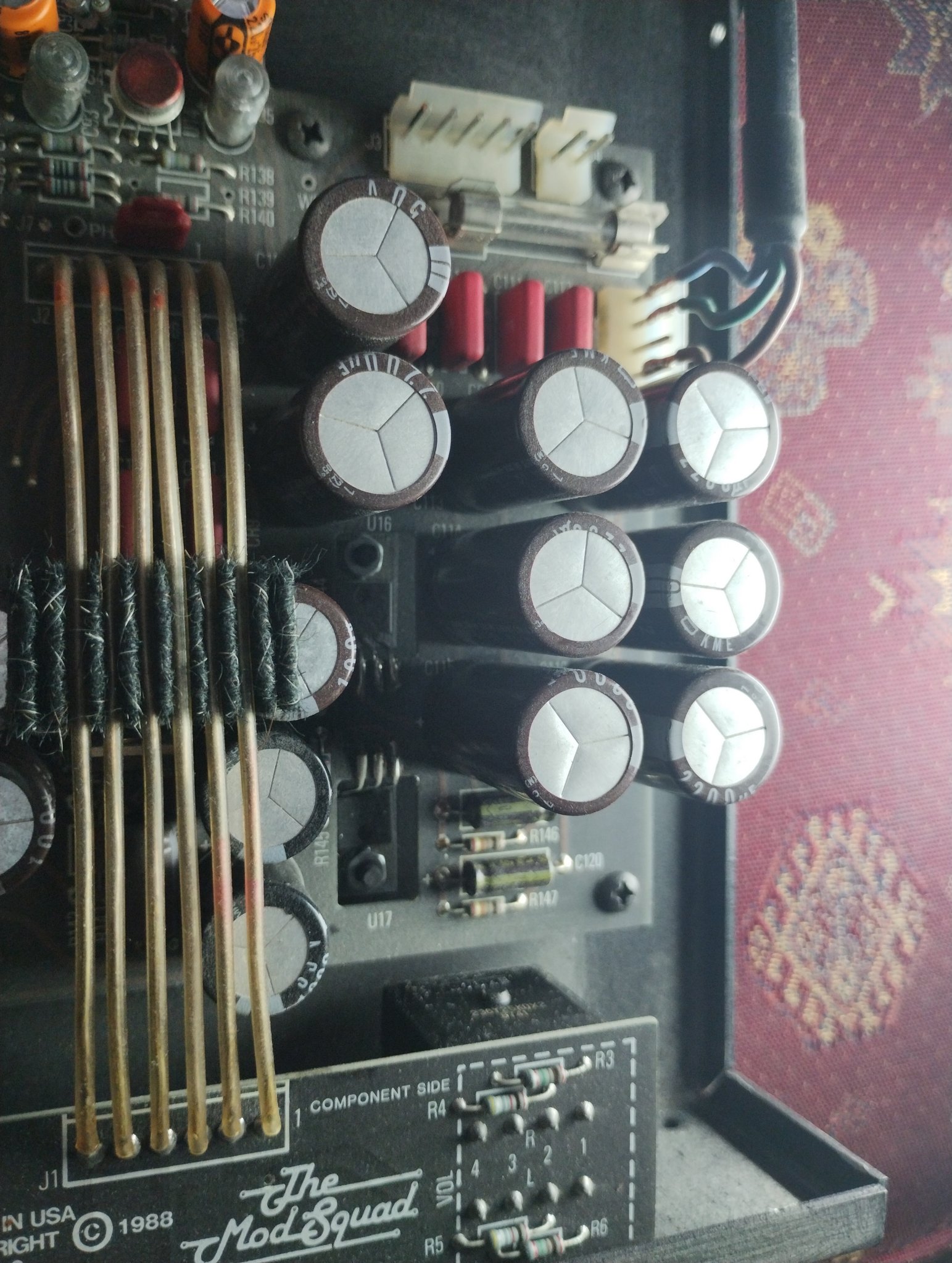

It shouldn't be to hard for me to make up an ac to ac supply however I don't know if a soft start circuit is used or how the earth lifting switch is employed again a quick peek inside your own power supply and a photo would be much appreciated

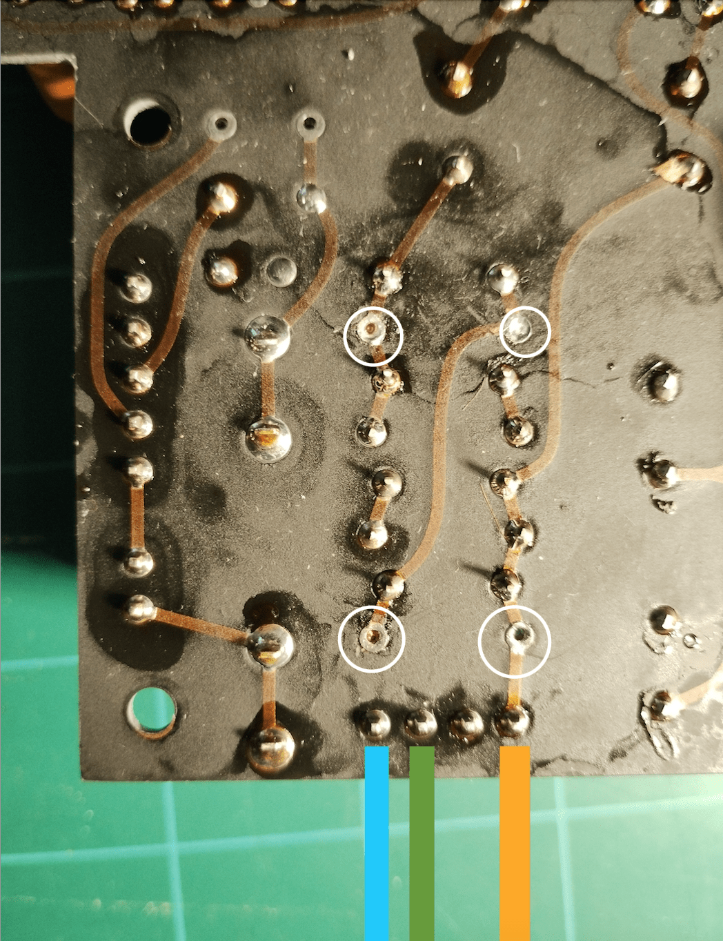

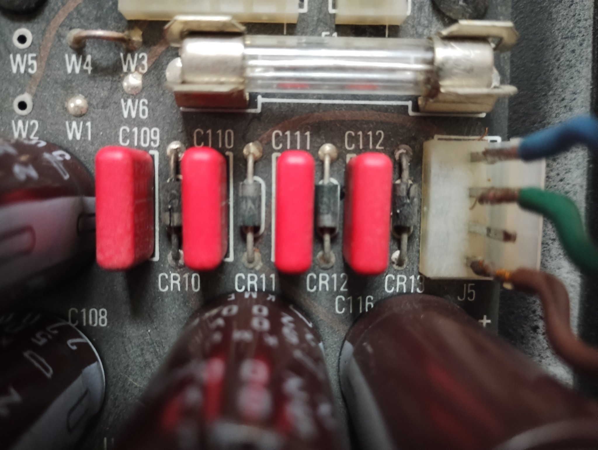

Some time ago I visited the Vinyl Engine website as I am a member there, they only have a user manual, unfortunately no schematic. This is where I got the idea that it was fed 30vac well that and the 4 diodes that sit alongside the incoming power which I took to be a rectifier. (see Pic. 1) after connecting 24vac to the brown and blue wires two of these diodes smoked (Pic.1 CR10,CR13)
The model I have is the phono drive deluxe which has an off board power supply three wires enter the chassis Blue, Green Brown.
(Pic.3) carrying either DC or AC.
I presumed the rectification was going on onboard considering the banks of capacitors
I hope this further information and the photo's can help solve the problem. I would hate to see the unit end up in landfill as it was a very nice sounding devise.

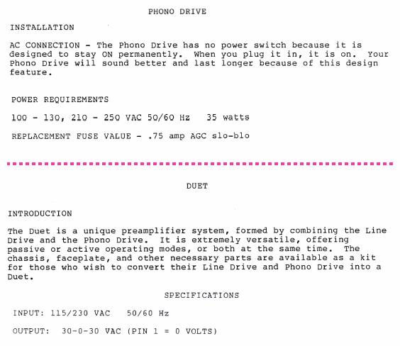

According to the document that PRR attached eariler its 30VAC - 0 - 30VAC, but more importantly Pin 1 is 0V. If that Pin 1 matches up to pin 1 inside of the pre also then that would be a problem. So if you connected your VAC up to the brown and blue wires one of those was supposed to be the center tap. You really need to pull the board and inspect the backside of the board and visually identify which pin is the center tap. Take pictures and post them if you are uncertain. You'll have to pull the board to replace the burnt rectifiers anyway.
Thanks Chamberman for your help. Well I eventually pulled the board and desoldered the two diodes circled in fig.1. I have also marked up where the blue green and brown wires enter the board but am no better off as regards where the 0 volts centre tap goes and +- 30v.
I can't see any traces leading from either the blue or green solder pads. Any thoughts guys.
