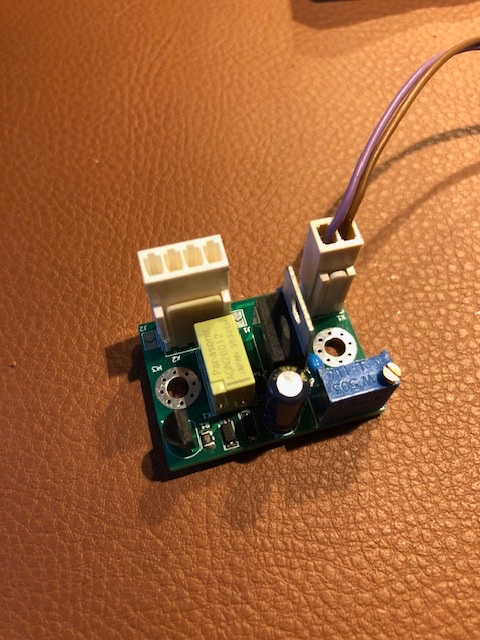

Since the author never reacted and I needed a few of the PCBs I redrew them for AGN20012 relays. Now with shorting to GND for RCA (configurable with a solder bridge in each channel) or shorting + to - for XLR. Dimensions 32 x 22 mm, two M3 mounting holes, distance between center of the mounting holes 24 mm. Yeah it is tiny so it will fit in the majority of devices where power on/off muting was forgotten. Just tested one, it works OK.
If there is no objection I can post the Gerbers. No fancy manual for such a basic circuit, just a part list. No support.
