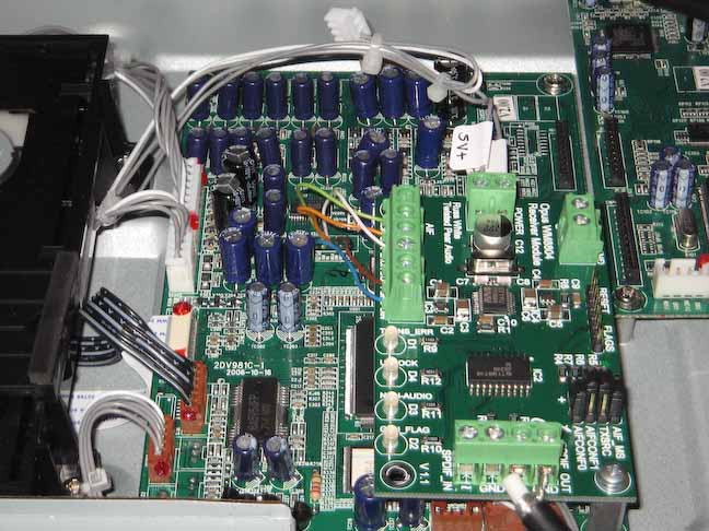

OK. I think I attached a picture (I hope...). Here is a summary of what I did:
1. I mounted the daughter-board to the main-board by removing the front right screw, replacing it with a standoff that came with the daughter-board, and then screwing the daughter-board to the standoff. Looks almost like it was meant to be mounted there!
2. The signal wires are some cat5e bits I had sitting around. I made them appropriately short so that they would just reach the daughter-board. They are soldered into the header on the main-board and screwed to the terminals on the daughter-board.
3. As rossl mentioned, it gets kinda warm in the chassis. As I did not need any video output, I disconnected the HDMI board. As luck would have it, the power cable to HDMI board has 5v on it so I took that to power the daughter-board.
4. As I also do not need the main output board with the audio and video connectors, I removed that as well. I threaded a coax cable through the open chassis holes and connected it to the daughter-board.
5. Of course, before I did any of this work, I updated the firmware, set the SACD/CD priority to SACD 2-Channel, set the DVD-Audio/Video priority to DVD-Audio, and set LPCM to 192K, etc.
Because the manner in which I made the mods, I can remove all trace of the alterations should the unit require servicing.
So far, I have tested 44.1, 48, 88.1 and 96K. My DAC confirms these signals are being sent. I will check 192K as soon as I find the disc with that signal on it (around here somewhere...).
Regards, Peter

Russ White said:
Very glad you got it working! I hope it fits inside ok.
Cheers!
Russ
Russ,
Using the standoff on the main-board allows the daughter-board to fit perfectly. I was a bit worried about the terminals and considered removing them. Luckily it fits just fine. However there is not chance of stacking the Metronome (ASRC) on the unit. If I choose to go that route, I will have to mount it on the side somewhere...
By the way, thanks for working on this with me.
Regards, Peter

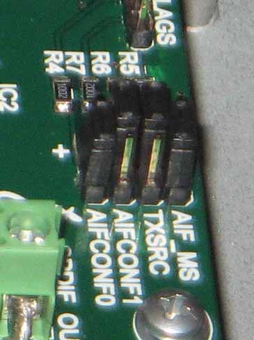

abq-pete said:
rossl,
The correct jumper settings are:
AIF_MAS 2-3
TXSRC 1-2
AIFCONF1 1-2
AIFCONF0 2-3
Attached is a close-up.
Regards, Peter
Thanks. That's what I thought they should be set to, but I wanted to check amd make sure.
I did try to mod a 970. I couldn't get the wires soldered on the the DAC pins without shorting. .5mm spacing between pins is just too small.
It also looks like they swapped the data lines on the 970. Data 2 on the DAC is the main stereo signal.
It's probably not worth it for you to replace the 27MHz crystal with an oscillator if you're not going to use the video. Enjoy your Oppo the way it is.
