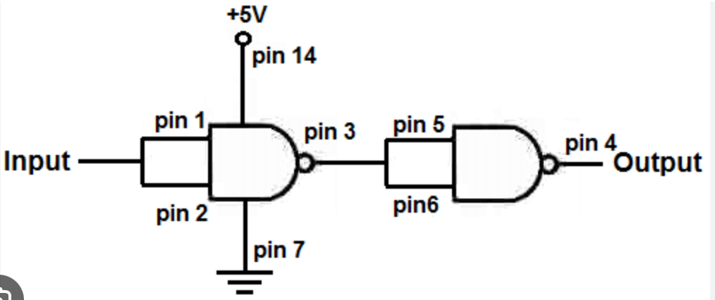

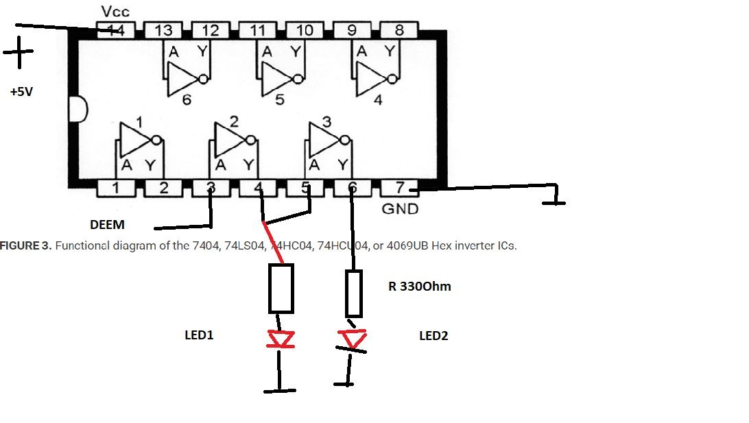

You mean something like this?
Input soldered directly to DEEM.
Output soldered to a R + Led

DEEM to the input of one of the six inverters of a 74HCT04, 2.7 kohm resistor from the inverter output to the cathode of the LED, anode of the LED to the +5 V, other five inverter inputs to ground. The T in 74HCT stands for TTL compatible, meaning that anything from 2 V to 5.5 V is recognized as a high level. You can also use two inverters in a row, a resistor and a LED to ground, if that is more convenient.

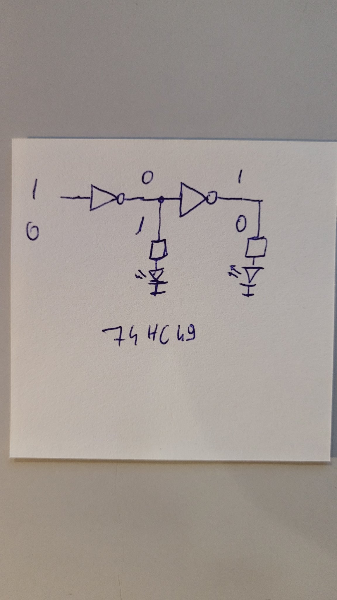

I did something similar with the error flag from the SAA7210 (EFAB signal, Error Flag from the A-chip to the B-chip, that is from SAA7210 to SAA7220). I inserted a transistor with a LED + resistor in its collector. The LED blinks when there is an uncorrectable error in the frame.

Why 2 led? I only need one to see if de-emphasis is enabled 🤔Jeśli prąd wynosi tylko 0,2 mA, najlepiej użyć bufora. To tylko jeden układ scalony, dwa rezystory i dwie diody LED.
LOL you are right!!🤦♂️ON and OFF
But I think I'll use only the second led (ON) with yellow or orange color just to inform the listener that de-emphasis is enabled.
Must the input of the first gate be connected directly to DEEM as I drawn in the first picture?(emitter of the transistor 6534, it's the same).
Or must it be connected to the collector of 6534?
To DEEM, and use TTL compatible CMOS inverters (74HCT04).
When you connect the collector of 6534 to a CMOS inverter, its ESD protection will clamp the low voltage to about -0.7 V, while it is supposed to be -15 V to properly switch off the JFETs. All CDs are then played with de-emphasis, also those without pre-emphasis.

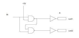

Personally, I would use either the setup with NAND gates/inverters or a discrete, logic-compatible MOSFET tied to the DEEM line. Hook the gate to DEEM, source to ground, and drain to LED + series resistor to VCC.
CD4011 would be a good choice for a NAND gate. 74HCT00 would likely work also.
2N7000 is an example of a MOSFET that would work. It comes in a DIY-friendly TO-92 package. The 2N7002 has lower threshold voltage, but is only available in SMD.
The advantage of using a MOSFET is that the gate does not load down the DEEM signal.
