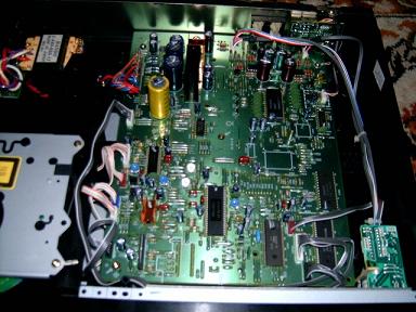

I am the new member of this forum. I am using the Sony 950 CDP and i want to upgrade its capacitors.
On this main board, i saw 1 big yellow capacitor, name SB, 47000 mdf and 5.5V,
Can anyone tell me this capacitor use for which section? power supply or what. and what is this brand name. and or can i replace this and which will be the best for replacement? there are 02 ELNA 4700mdf and 16V, are they good or have other better for replacement?

Can't tell much from that picture 🙂 You need to find a service manual and circuit diagram.
47000/5.5v sounds a strange value. Post a close up picture of it. Are you sure it's not a "super cap" used in place of nicad/ni-mh battery to maintain standby/memory settings. Unusual though in a CD player.
You might be better looking at the analogue output stages for any possible upgrades and mods but without more info it's hard to advise.

Thanks for the pics.
The yellow cap has to be for system backup/memory retention. Similar thing to these. It has no effect on audio performance.
2 NCC 5.5V 4.7mF 4700UF SB Memory Backup Capacitor | eBay
I think there is at least one (that I can see) 5532 type opamp... are there more ?
Replacing these may well give the most change in subjective performance. I would suggest something like the OPA2604, the OPA2132 or the LM4562. All will sound different... the OPA2604 can sound very musical in the right application.

Beyond that I would see what the muting circuit is but you really need a circuit for that... without having the unit in front of me I wouldn't like to guess. If it uses transistors as a mute then these can usefully be changed for FET's (if the drive is correct) or sometimes removed altogether (if you are prepared to put up with possible pops/clicks at power on/off)

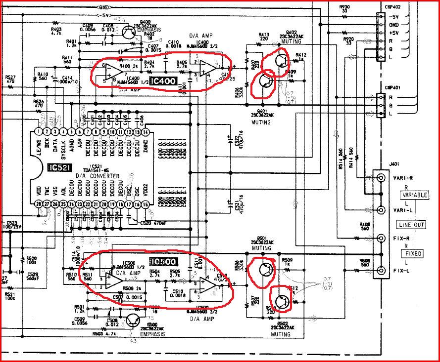

Having looked at the circuit I would definitely replace the two dual opamps at the output of the DAC. In your photo it appears to be a 5532, in the manual a 4560.
I would fit sockets and then you can try different ones. the circuit looks as though it should be stable with no other modifications needed. Try the OPA2604, the OPA2134 or perhaps the LM4562.
The muting transistors. You can actually remove these completely to listen to the player. With them removed is "as good as it gets". It's possible to replace these with FET's such as the 2SK117 or 2SK170.
I would do just one thing at once... opamps first as that will give the greatest sonic gains IMO.
I have read about the Sony Duorex caps as being a major problem as they age... but I have no experience myself of these so can not really comment. If you look under the PCB where the caps are is there any discolouration ? If any doubt I would say replace all of that type.

You are right, there is 2 IC 5532DD - JRC in output of DAC chip.
I am seeking for the OPA 2604 or something else.
The Sony Caps is still good and no discolor as you said. I think the best move now is to replace the 2 Opamp,
