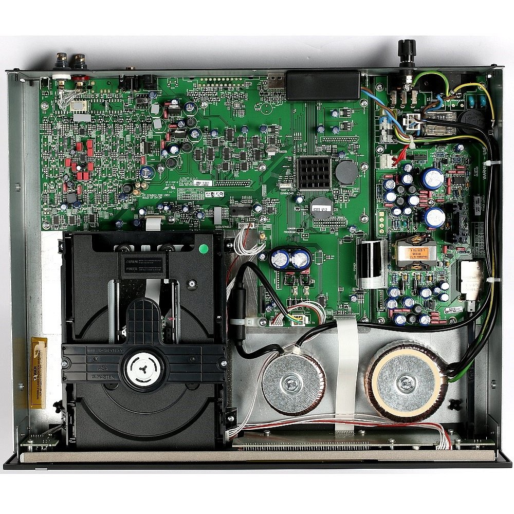

Mod Arcam CD37 to DAC with digital in. Is it possible.
I haven't seen the schematic of the CD37, so I’ll be guessing here.
I suspect that what you want to do may be possible, but probably is not worth the trouble. Roughly, the way I imagine going about it would be to purchase a diy S/PDIF input module. Mount it so that the coaxial input jack passes through a hole drilled through the chassis back for that new purpose. The module should feature a 3-wire I2S output port (presuming that the CD37’s DAC accepts I2S). Solder three wires from the module’s output port to the corresponding CD37 I2S PCB traces leading to its DAC. At the proper place. Then you must cut the I2S PCB traces coming from the CD37’s drive to its DAC, but make certain to do it prior to where the new solder connections are located. Thereby to disconnect obsolete signals from the drive section to the DAC section. You will need to power the S/PDIF module with the correct voltage. Also, ground the S/PDIF module to the CD37 signal ground.
That is, of course, a vast oversimplification. Which may not work, depending on whether the DAC section of the CD37 will operate properly when fed an external 3-wire I2S input signal. You also will need a schematic of the CD37, an oscilloscope, and a knowledge of electronics.
Like I said, it’s probably not worth the trouble.

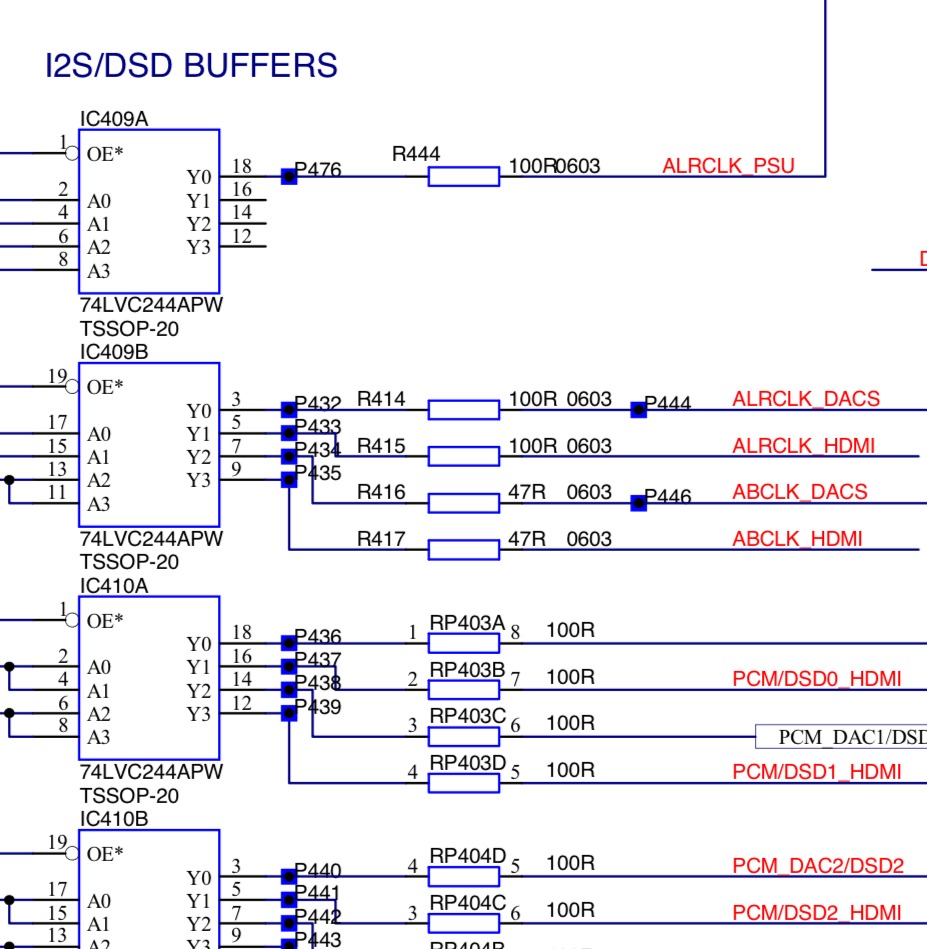

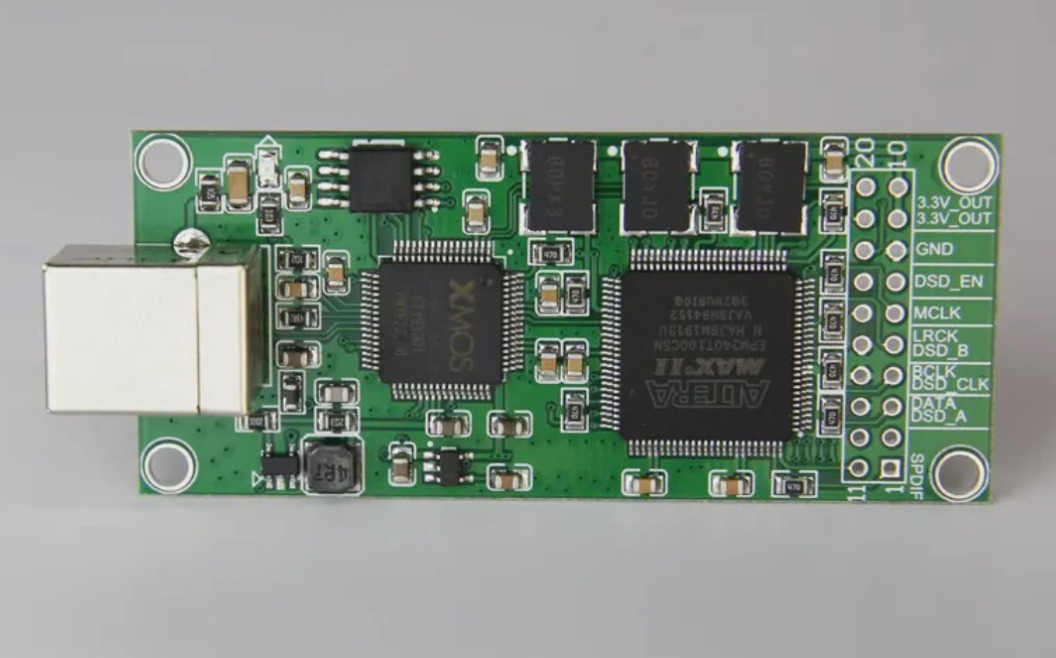

It looks like you could at least try and carefully inject a signal from a hobby xmos usb input board.
Looks like plenty of features that may require attention in order to disable w/out breaking anything…

Hi, thanks for the replies. Any work on this player would only take place if the transport fails, nothing to lose then. Arcam won't repair it and a unit of the same class would cost £2000. I expect the main problem is will the DAC work without the transport, being a SACD player may further muddy the waters.

The dac will do what it is set it up to do . It is easy enough to take control of the dac from the onboard processor. Once it is isolated it is then possible to connect via USB or SPDIF.
