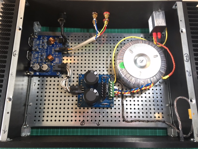

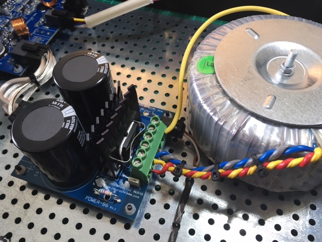

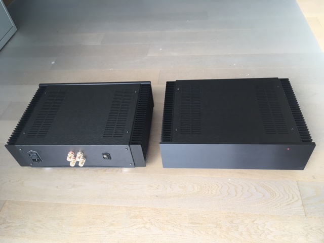

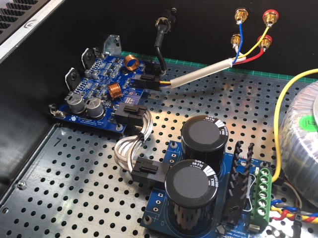

After being back from my summer vacation I finished the Mod286s and can announce two new members to our household.
As on indicators I ran the red led from the respective Power86 to the front panel. Other than that it was just mounting the LM3886s to the heat sink, hooking up the XLR input, the speaker wire and crimping the power supply wire 6x12awg from the psu to the Mod286.
Stay tuned for the integration into the audio chain and the listing impressions... let my say upfront... wow or a more cautious not bad all... details to follow the next few days.

Thanks Tom.
One question. I noticed that the mains voltage here is about 230V (instead of 220V) which in turn brings up the loaded rail voltage from +-35V to ca. 36.7V (measured with my DMM)
Could that be a problem, as you usually specified the Mod286 for 35V? Should I replace the 2x25V Trafos with 2x24V? Are there any performance disadvantages when using the 36.7V rail voltage?
Your ±37 V will droop to more like ±34-35 under load. I wouldn't worry about it. The absolute maximum voltage for the LM3886 (with signal) and thus the Modulus-286 is ±42 V.

So let’s recap my Mod286 building experience, the materials used, the audio chain integration and ultimately the listening experience
Building:
+ Easy build even for an SMD first timer as I was (however one needs the right solder equipment and some practice boards)
+ Excellent BOM / Mouser Material ordering
+ Super assembly instructions and circuit details (ca. 40 page document)
- Room for improvement (for the metric system users): use an inch value of the mounting screw spacing (Mod286, Power86) which result in a multiple of 10mm +-1mm. E.g. as one of the sides of the Power86 module provides (i.e. 81mm). This would make mounting on the 10x10mm 4mm hole grid of the Modushop cases bottom plate even easier without the need of any drilling.
Materials used:
. 2xMod286 for dual mono configuration with the 20db gain option enabled
. 2xPower86 boards
. 2xAmplimo Toroid 2x25V, 300VA transformers
. 2xModushop Dissipante 3U/300 cases (black), 10mm alu front, 3mm alu panel plus steel internal bottom plate (10x10mm, 4mm hole grid)
. 8x EMC golden speaker posts (for bi-wiring option)
. 4x Neutrik XLR EMC series connectors
. 2x Neutrik XLR DLX sockets
. 2x Schurter IEC C14, filtered mains inlet w/ switch and fuse (DD12 series)
Audio chain:
Source: Auralic Altair Streamer using the XLR outs (max. 4Vrms)
XLR Cable: 1.5m/channel van Damme Starquad XKE
XLR Connectors: Neutrik XLR EMC series connectors
Amp: Mod286 Mono Blocks
Speaker wire: 70cm/channel Atlas Equator MKII bi-wire 6N pure ofc
Speakers: KEF R700
Listening - to follow
