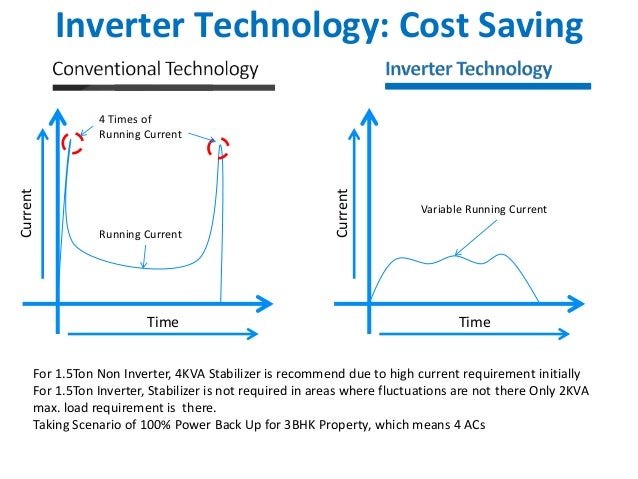

- Airconditioner 12.000 Btu, high Seer inverter type 1.100 Watt

But when your AC turns on, which to boot is an electric motor based device , it will "eat" all of your power capacity ,even if for a second, so generator detector will speed up the motor to compensate ... that takes seconds ... then it will find power consumption has stabilized and slow it down.
Then the opposite when AC turns off; with the popcorn machine doing the same in a smaller scale.
The point is that your AC will be very unstable, because largest consumers go on/off all the time.

The problem is that heaters demand a lot of current. Heater switches on and demands 10A (for example). Generator is only supplying 2A at the time, so needs to really put some work in to maintain something that's now demanding 6x the current. After a few seconds, everything has spun up and is working harder.
No real problems there - the lights might go dim for a second, but most amps won't notice or care.
When the heater switches off, you have a problem. The generator is now working for the 12A supply, but now only 2A is being drawn. Voltage goes high while the components reduce speed. In some cases, the voltage will be high enough to start destroying things. Imagine putting 100v across a 63v cap and you're there.
