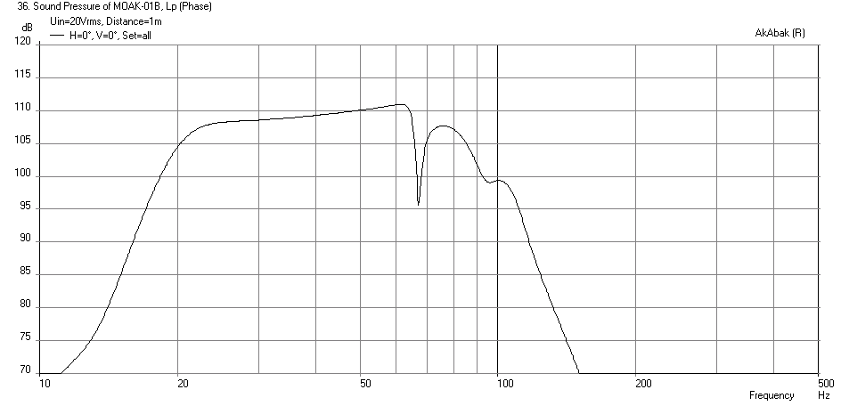

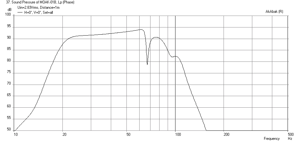

Absolute max is 50cm x 50cm, outer dimensions. IOW inner dimensions of 45cm x 45cm. Height can be up to 2.5m, or even as much as 2.7m.
The width and depth control the volume and making it 1.09x scale in both width and depth gives you about the 0.5m x 0.5m constraint. Scaling height to 2.6x seems to give best tradeoff between efficiency and extension.
Here are sim results with 17 Hz HPF and 85 Hz LPF (-24dB/oct BW).
SPL vs freq at 2.83V:
SPL vs freq at xmax (20 volts rms):
Not the most efficient sub woofers but might just work for you - but 110 dB may just be enough for you to rattle some picture frames and wondows on the Landlord's house?
