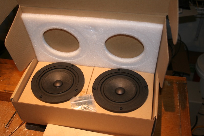

I now have a pair of new EL-70's on the shelf 😀

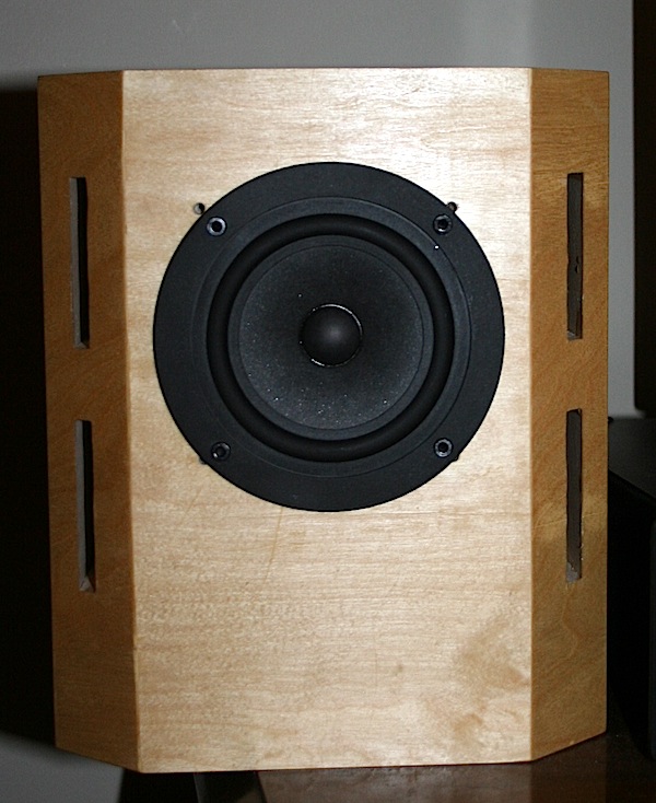

I also have some Onken style boxes (a.k.a. derived from planet10 Fonken) which are very close to the mMar-Kel70 enclosures - mine are 6l with ports that are the same length but larger in area (I can reduce the area accordingly). Seems an easy path forward.
But I have enough of these boxes that I can combine them (with some surgery) to make a pair of larger boxes which have a volume just a couple of litres more than the bigger Mar-kel70.

I did enough surgery to the driver magnet brace to allow me to install the drivers and connect the boxes up to my tube amp. The tuning is way off, I still need to reduce the area of the ports. And the tube amp is wired up for an 8Ohm load not a 4Ohm load. But it allows me to put some noise into the drivers.
I can already tell that a) there is waaay more bass than the FE127. b) the shrill of the 7kHz peak from the 127E is not present, c) the box tuning is off and d) the drivers need time to break-in.
The mounting screw holes don't line up with the old drivers. Fortunately the old holes don't go all the way through. If I like them the boxes will escape the bonfire and I'll probably take some time to refinish them - the veneer has not survived the test of time and needs to be removed. I'm tempted to spray paint the boxes.

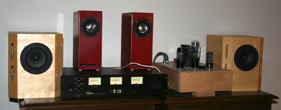

I am now using the EL-70's in my 6 litre boxes as my main speakers, driven with a SE tube amp. That should tell you I'm lazy (not much progress) but also that I like the sound 😀
I do get the sense though, that a larger box would be worth the effort. Mind you, I'm not entirely sure that I have the ports tuned right yet, I think I have them tuned too high which means I'm losing something on the low end - but a larger box feels very tempting.

To my ears, there's quite a difference - the EL-70's have more bass, they don't run out of steam so quickly (twice the cone area), they are 'cleaner' sounding in the mid range. I need to run them through the same amp to make a proper comparison in the treble though but I don't doubt which one would 'win'. The only reason to pick the FR88EX over the EL-70 would be box size - the FR88EX will work well in a much smaller box (it's Vas is only a tad over a litre).
