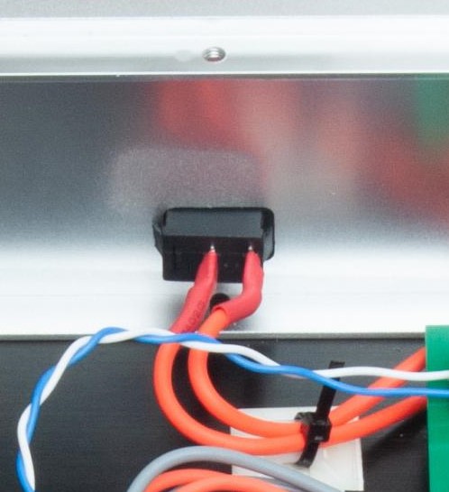

This looks a bit dodgy for a mains switch though, did you fix it after the photo ?

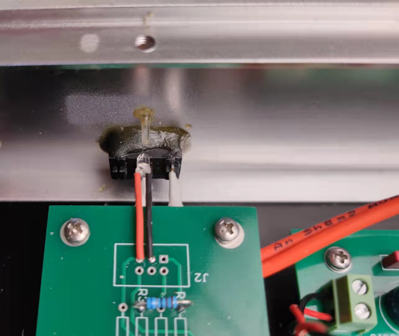

I use Gotham of Switzerland for all the wires in the machine. My dealer here only has orange and gray wires. In order to pay attention to safety, I use orange for high-voltage 220V wires. Later, I used enough epoxy glue to firmly stick the switch to the chassis

the wire ends look like soldered and screwed to the connector blocks.
You know that soldering ends and screw connectors are considered a nogo not without reason?
It might not matter much in low current application like a preamp, but I´d rather twist together the power supplying wires, especially when you run signal wires in close proximity.

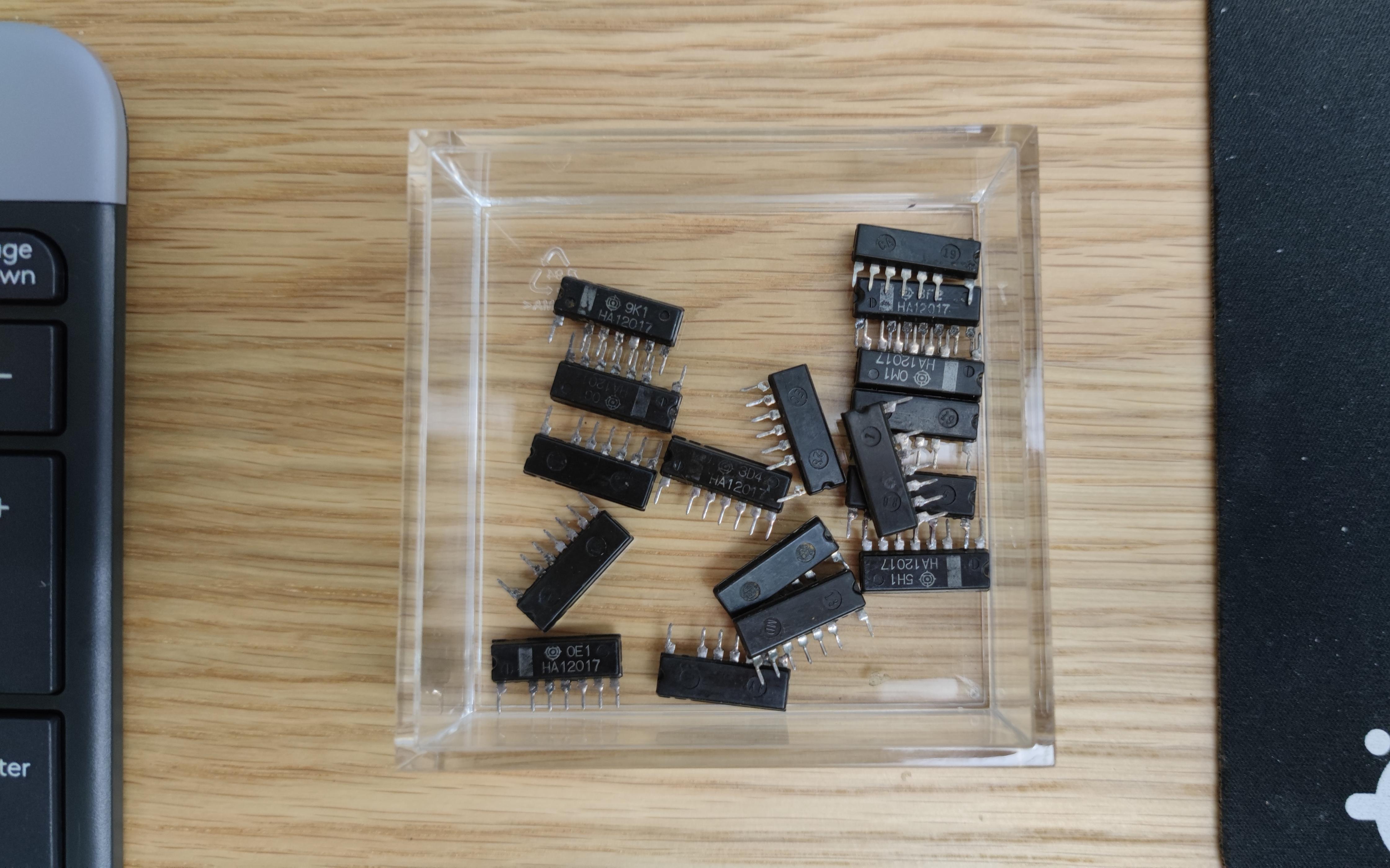

More than 20 years ago, I used HA12017 for tape head NAB amplification. The sound quality is very good, but later I accidentally lost it when I moved. Now many people in China are recycling electronic components. I see the recycled HA12017, which is very cheap. You can buy two for $1.I bought a lot and can make many sets

Hey, I bought a bunch of those HA12017 op amps also out of China, they are all original Hitachi components, some are new, some are recycled. The only trouble is I cannot seem to test them to see if they are working or not, I have used a commercial op amp tester, as well as trying to get a voltage follower to read same voltage out as going in, but no tests have given any positive results. The op amp tester, jut reads that all the chips are dead, and yet I tested 2 known working chips from an audio circuit and both also read as dead op amps. As for the voltage follower that works fine with other op amps for reading same out as going in, I get nothing coming out from the HA12017 op amps.
Any help on how to effectively simply test these ic's would be greatly appreciated.
