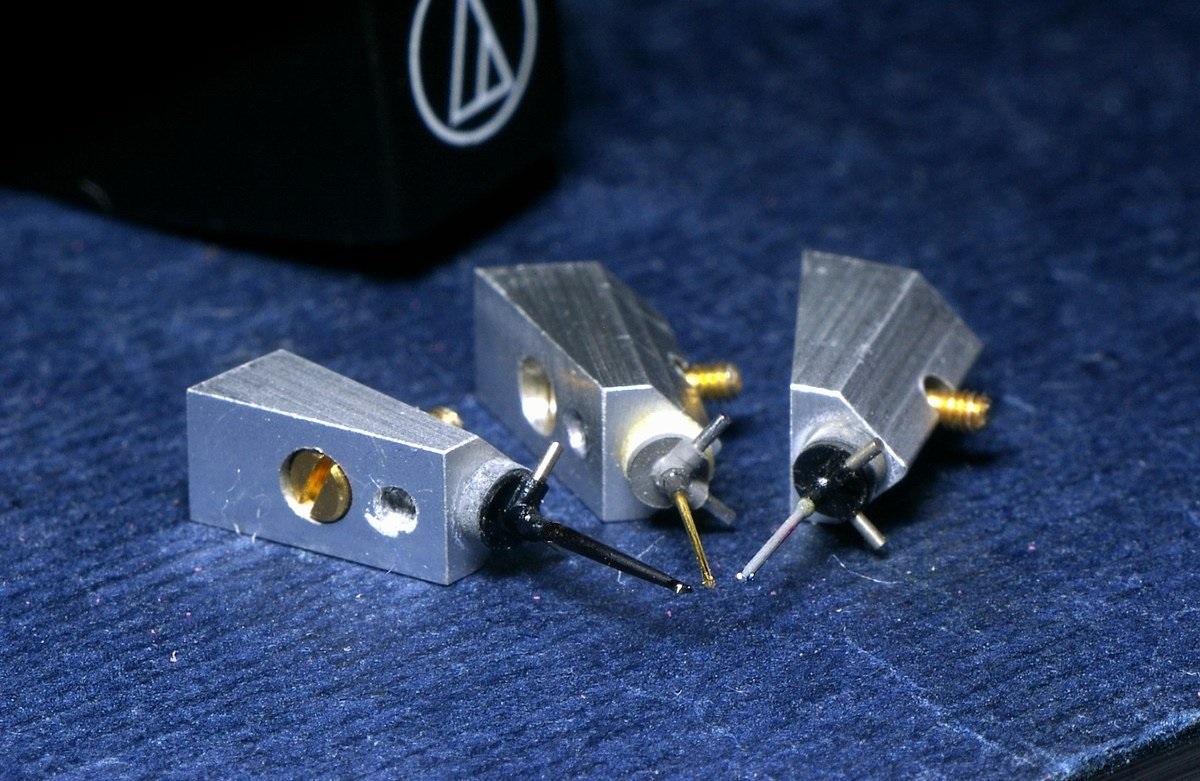

One cartridge, 3 cantilever options. Left to right Cactus, Boron and Beryllium. Cartridge is AT22 which from the age of low output low Z*. Hand wound coils. Should provide some interesting diversions and some measured data. Soundsmith want $7k for their cactus cantilevered cartridge!
*Nothing like as low as Grados or the panasonic EP205CIIL but 85mH is still pretty low.
