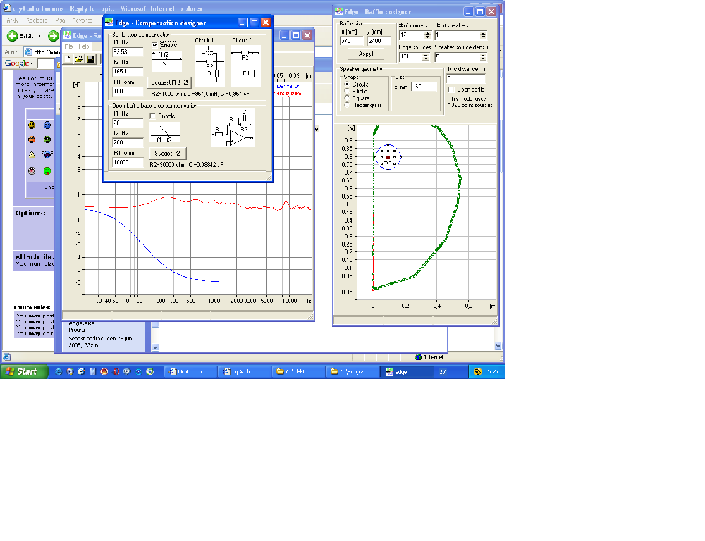

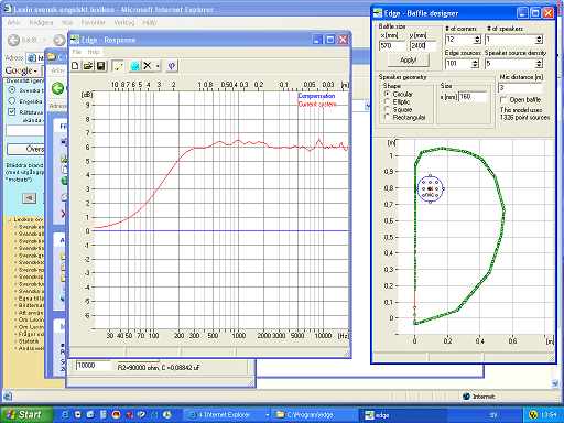

Anyway, unless the speaker is near a wall or corner it should sound 'lean' even when turned in as Jordan recommends, so a baffle step compensation (BSC) filter will be required.
GM
Ah, the lean, mean 48 MLTL. After waving my arms about for months saying it didn't need BSC, I finally added one last year and then booked a restaurant to eat my words. The BSC helps a lot. Male voices in particular sound more natural.
My triangles have a front face 7.75" wide, sloping back to 9.25" wide and the compensation circuit was a 4.7Ω 25w resistor and 3.2mH inductor in parallel with each other and in series with the speaker positive lead. These were measured and showed the mid (500-2kHz) is brought down and the extreme HF goes up slightly.
Jim Griffin’s version of the MLTL (7.5“ wide baffle) uses a BSC of 4Ω + 1.5mH (3dB baffle step).
Hope this helps.
Zoebel? Calculating off a couple of different impedance plots I get a <0.18 mH/~8 kHz based on a ~5.1 ohms Re, so you'll probably lose more SQ through the added components than any perceived HF improvement.
