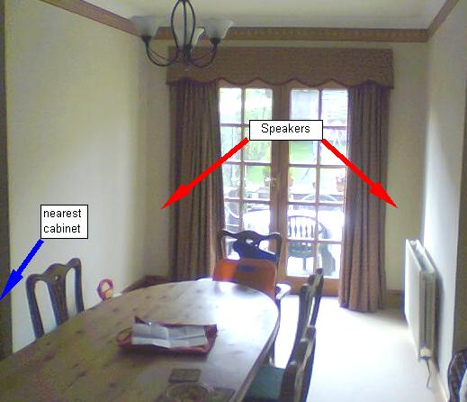

OK then, so you dont feel that there will be an issue with magnetic fiels and interference to a great degree (or at all?) but you believe vibrations are the big issue here?
So....if I place the speaker on marble with a dampener between and double up the top section........and introduce a dampener between the top and my system that cancels out ALL vibration....
Would this be better than having 4.5>5M runs of cable?
I could put it on a shelf above the speakers at a pinch, definately not the floor though (babies!!).
The wife aint gonna be happy when she sees the size of these things antway!
If you are going to tuck the speakers into those corners, you might get away without a correction circuit or with just a small resistor (1 - 3 ohms) in series.
Why don't you want to place the circuit inside the enclosure? I don't remember what the reason for keeping it outside was, it could be outside for a month until you get the values you like then put it inside.
Amp placement and cable runs in a room that shape and size are tough. No easy answers.
